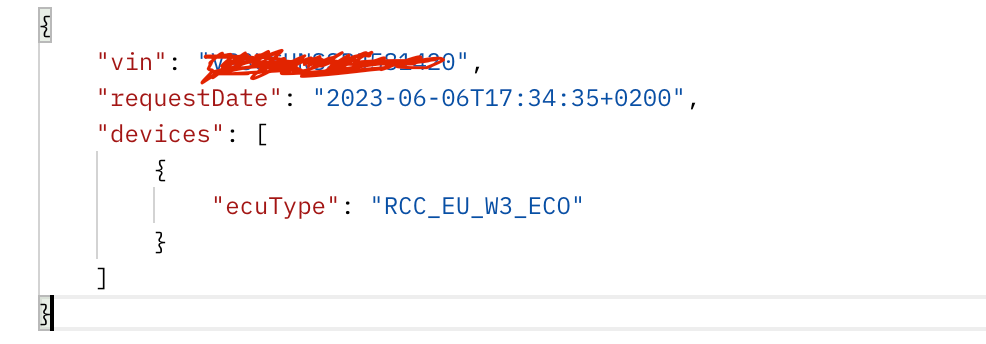

I also checked the ECU type by sending a request for my VIN (see attachment).

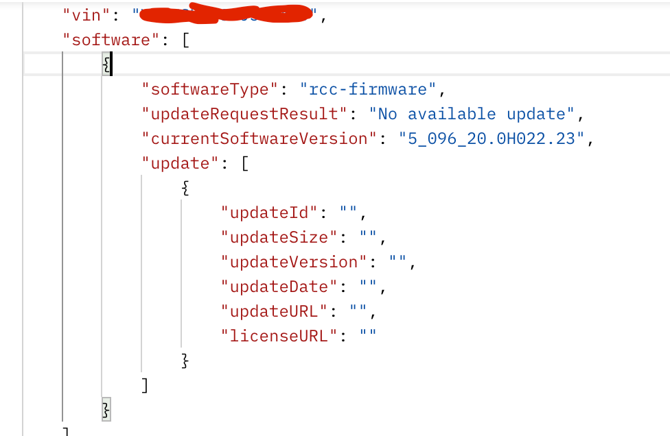

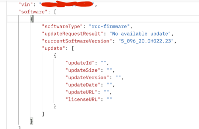

Also check the firmware version by VIN (see attachment).

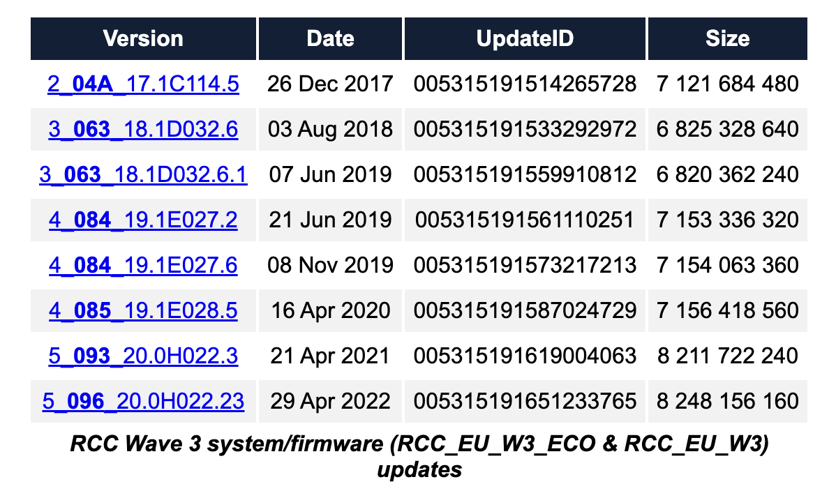

As expected I have the latest FW version that was released in April last year (2022) (see attachment).

I am really dissapointed because of this. And really worried if update comes any time soon. If you look into a list of updates for the RCC Wave3 it turns out on average its about 1 update per year. And this year (2023) hasnt been any yet.

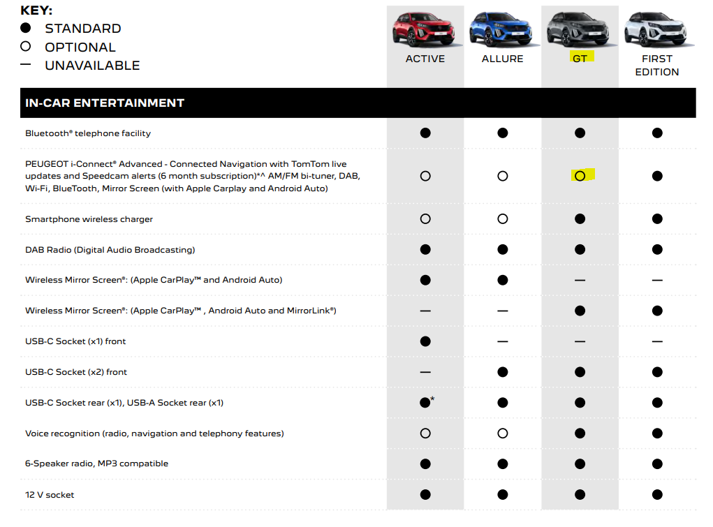

The GT is supposed to be the second highest spec, second only to the electric model yet it comes with no built in satnav, not even the subscription TomTom.
There is so much missing in the spec that shouldn't be.

Surely you would of checked the trim level had everything that you wanted before buying the vehicle? I don't understand how people can make a major purchase like a vehicle and not make sure it has everything they wanted. There are the various trim levels and then there are optional extras. Did you not check the specification over when you bought it?
The other issue is that they change trim level equipment all the time. In your case I believe the previous 2008 models from 2020 had the connected navigation, but the 2024 2008 GT does not:
But to be honest, I wouldn't worry too much. Just get an app like Sygic Navigation and use this via Android Auto or Apple CarPlay which your vehicle has. Basic features are free, including the maps, but for only £14.99 a year, you get all the premium features and that includes like traffic data, Speed limits and warnings, petrol prices and speed camera alerts, road speed warnings etc.
When you consider that Peugeot are now only offering a free 6 month connected service subscription for free, and then after that you have to pay over £100 a year for connected services, it's a no-brainer.
It works brilliantly and I now use this over my factory fitted sat nav as the sygic system has weekly updates for the maps and even includes the ridiculous 20 MPH speed limits now imposed on us, which my Citroen Nav system does not have even with the latest map!
