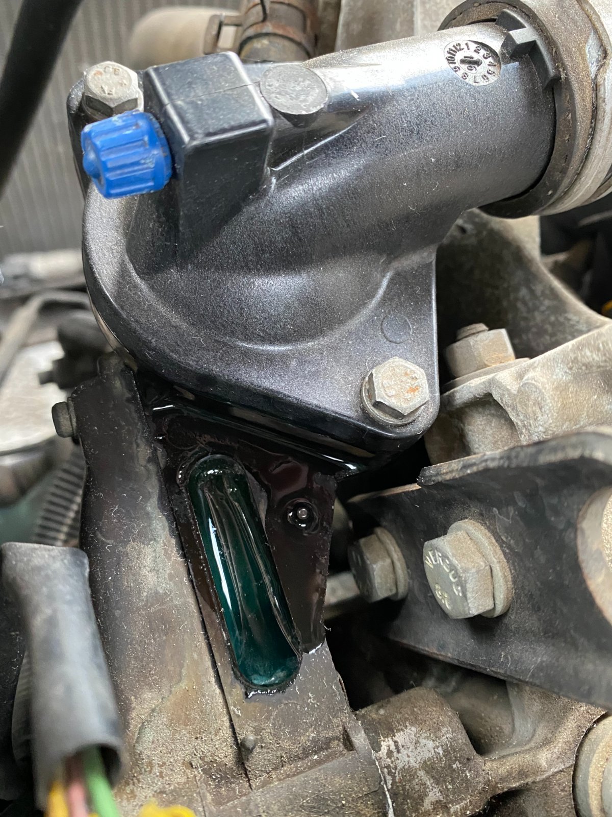

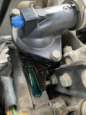

As it happens, I actually think I've found the source of the leak...!
I've never been able to find it once parked up, presumably because it's been evaporating. I've had a good look around this evening and when doing so, rested my hand on top of the thermostat housing. After removing my hand I noticed coolant seeping out from the mating surface of the housing. I attempted to tighten the 10mm bolts up but they are on tight and I don't want to crack it. The housing is actually new (fitted by a garage last year when they changed a broken metal coolant pipe) so I will remove it and see if I can create a new gasket with gasket paper or some high temperature gasket sealant.

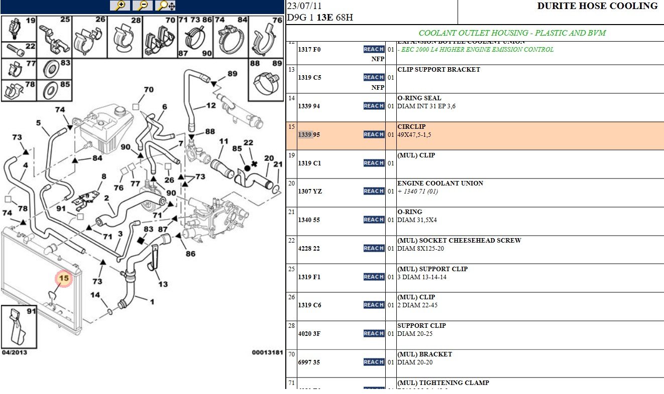

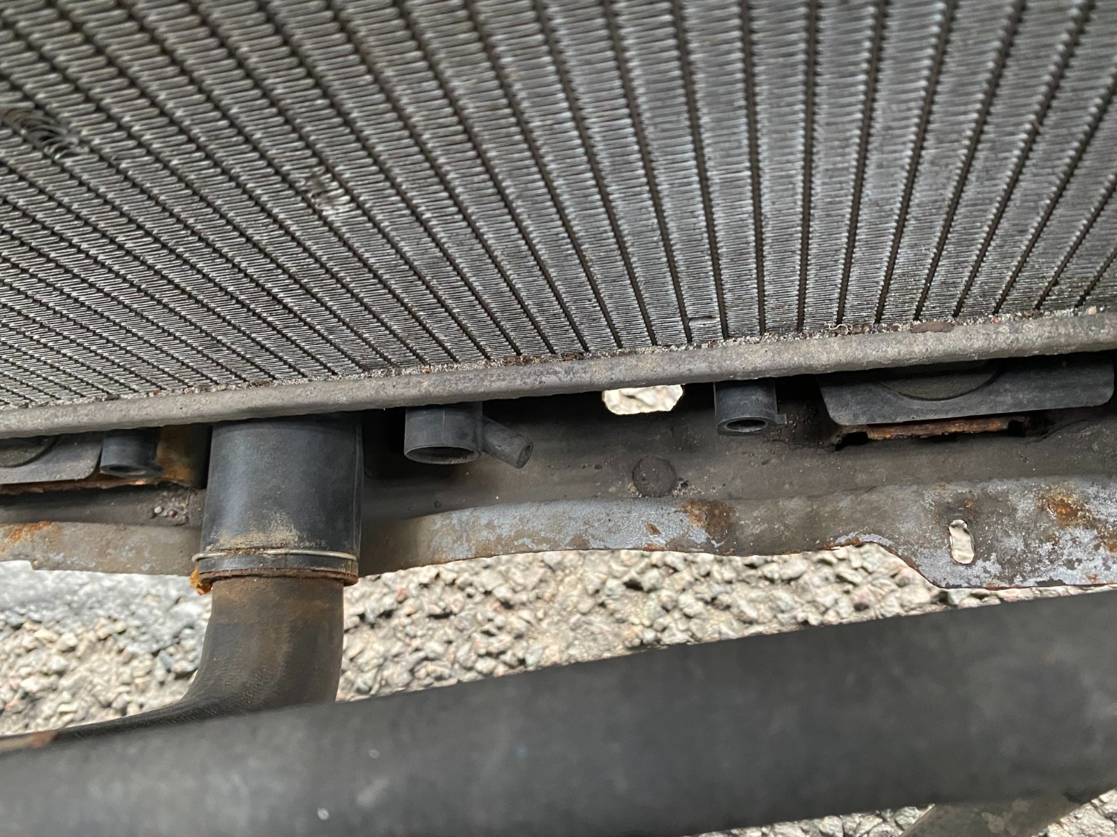

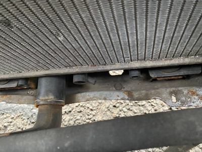

I've attached a picture of the bottom of the radiator just so you can see the set up. Not sure what clip I'd need for a pipe going into the plastic opening.
EDIT -- seems I need part number 133995 for the metal clip to hold the coolant inlet pipe in.

The part no of the clip on the bottom pipe is indeed 133995 & is £3.49 inc VAT

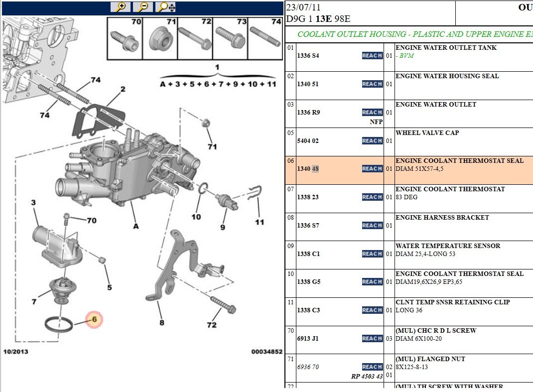

There is a thermostat seal in the housing (part no 134048 £7.50 inc VAT) might be worth replacing it at the same time.

Yes, had another look this morning and there's an obvious trail of coolant staining which runs all the way down to the sump. I think a lot of this was being burnt off/evaporated during a drive so I wasn't able to find it very easily.
