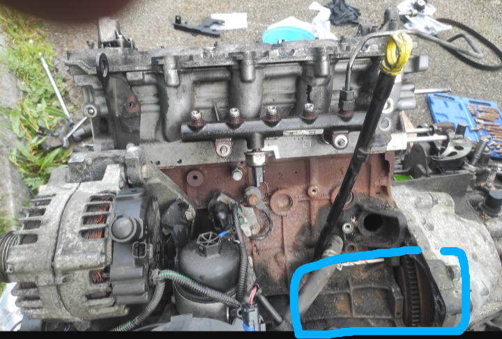

I did look for the starter motor unsuccessfully as part of my initial attempts to start it. The Alternator is at the front and clearly visible so I guess the starter motor must be at the rear covered by the underbody tray.

Off top of my head (and others with wiring diagram access wil have more data) the signal feed (12v from ignition switch to solenoid to turn it on) will be fused. Starter high current feed likely no fuse or mega high current immediately adjacent to the battery. Normally a big thick lead between alternator (13mm nut under a rubber "hat") and the start high current feed (also usually a 13mm nut)BMR79 wrote: 04 Jun 2023, 13:19 In answer to your question, no there was no clicking from the starter motor. As far as I could ascertain it wasn't even trying to engage. All dash lights come on as expected, but nothing happens when I turn the key.
Is it possible that a fuse or relay could be causing this.
I'm pretty sure the 2.0 starter is in the front, but a good but further down the face of the block (and obviously at the gearbox end of the engine) but if you follow the alternator thick lead it'll lead you to the starter
