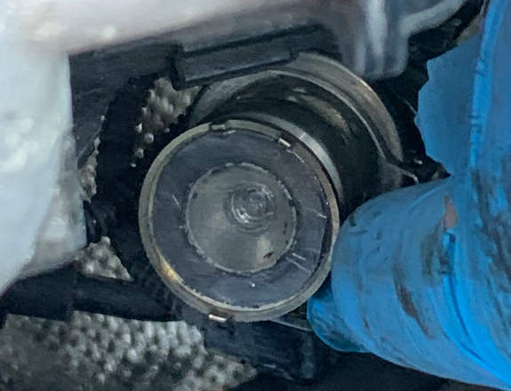

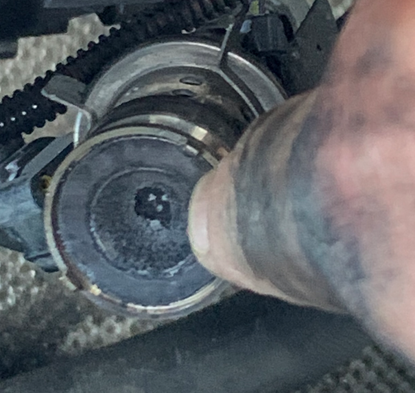

Hi, I have a 2019 C4 Grand Spacetourer 1.5 Diesel. The dreaded "Emissions fault: Starting impossible in 700 mi" has come on. A cheap reader showed up an error code of P20EE, I cleared the P20EE code and it's not come back. As I mainly do short journeys I though that the UREA injector might be clogged up as seen on a couple of YouTube videos. I took off the injector and as you can see it was very clogged up. A short clean later and I embarked on the most awkward replacement of the clamp to hold it back in place... maybe carrying this out from above was the wrong idea :-D
Onto my question. From what I've read, the next step would be to use a fancy box of tricks and correct the denox nox adblue fault. Is this correct?
To note: My tank has the fill point alongside the diesel and the cap is vented, so I'm hoping it's not an issue with the tank.
Cheers

You might have got luck, then again...! If it stays away all well and good, but if not then yes, you need a better scanner to read the live data. That code is pretty much just generic de nox not working, which is not that helpful!!
