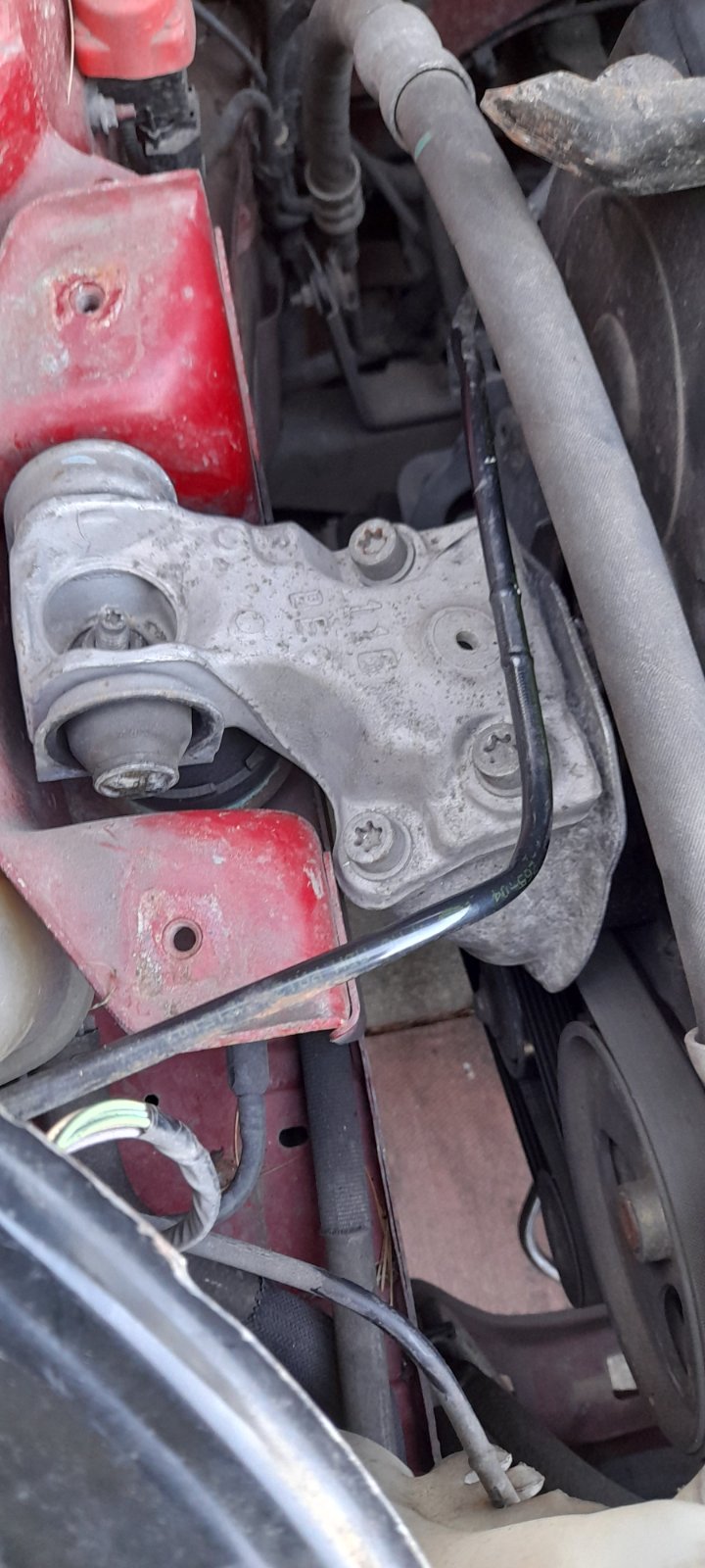

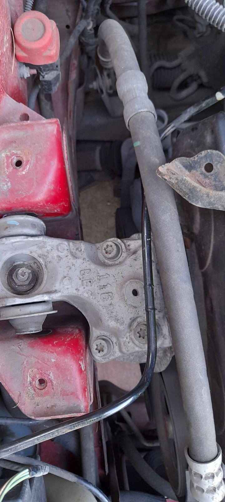

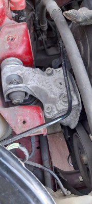

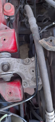

Hi all. I was driving my 05, 1.6 petrol Berlingo Multispace when it suddenly started to make a horrendous grinding noise. Turns out an engine mount appears to have snapped off. I currently have a jack under the engine and have raised it up. I would appreciate any advice on how to procede. I am attaching a couple of pics. Thanks in advance.

Forgot to say, it looks as if the bolts connecting it to the engine block have gone.

You'll have to get the mount off, the see what's going on underneath. Might be enough to get hold of the bolts, or you might need to drill them out then retap.

Had one go like that on a BX 14, mechanic was able to recover a couple of the bolts, and fit a couple of new ones.
