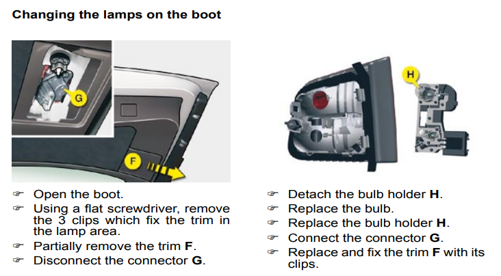

I find that the instructions given on p. 174 in the Owner´s Manual for my Citroen C5 Tourer 2010 concerning how to change the sidelamp bulbs in the tailgate are unsatisfactory. At least I could not do it. After opening the trim door (which has no three clips as descibed in the manual) a plastic wing nut appears as well as a wiring harness. This gives no access to the bulbs! I have searched for a solution in the Internet witout success. Can anybody help me with this? Thank you and best regards.

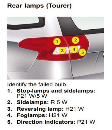

So you have the combined Stop and Sidelamp on the wing (1). This one has a locknut that holds the whole cluster onto the wing. Undoing it and the connectors allows the whole lamp assembly unit to be withdrawn away from the body.
For (2) which is on the tailgate, it's a bit more awkward and be careful as the plastic clips on the light unit once you have removed the trim are very brittle and if not careful can snap:

Thank you for your comments but there´s nothing in them that I didn´t know already. The illustrations shown here are from the Owners Manual and I simply cannot get them to fit with the real thing in my car. Reynir.
- x 6945
Re: How to change rear sidelamp bulbs C5 Tourer 2010
Put a photo up here (use the full post editor and then the file attachments button to browse for a picture) so we can see the part you are having issues with. This is the way it is done, so it may be a little tight where the clips are to get access to the bulb.
