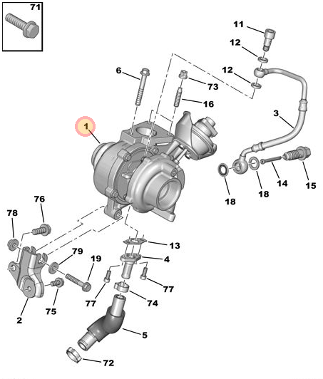

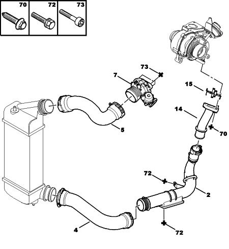

Where is that on the car Marc, could you share location drawings for me so I can I look tomorrow and see if I can see any damaged hoses etc. Hopefully not to expensive to fix ...

Obviously if it's the turbo or turbo position copy sensor that will be the whole turbo, otherwise check all your air hoses and air filter and especially the air filter enclosure.
Here's the Turbo Air Piping:

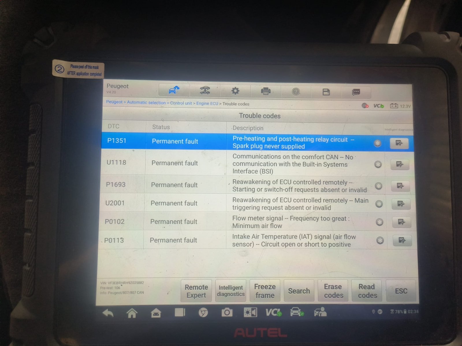

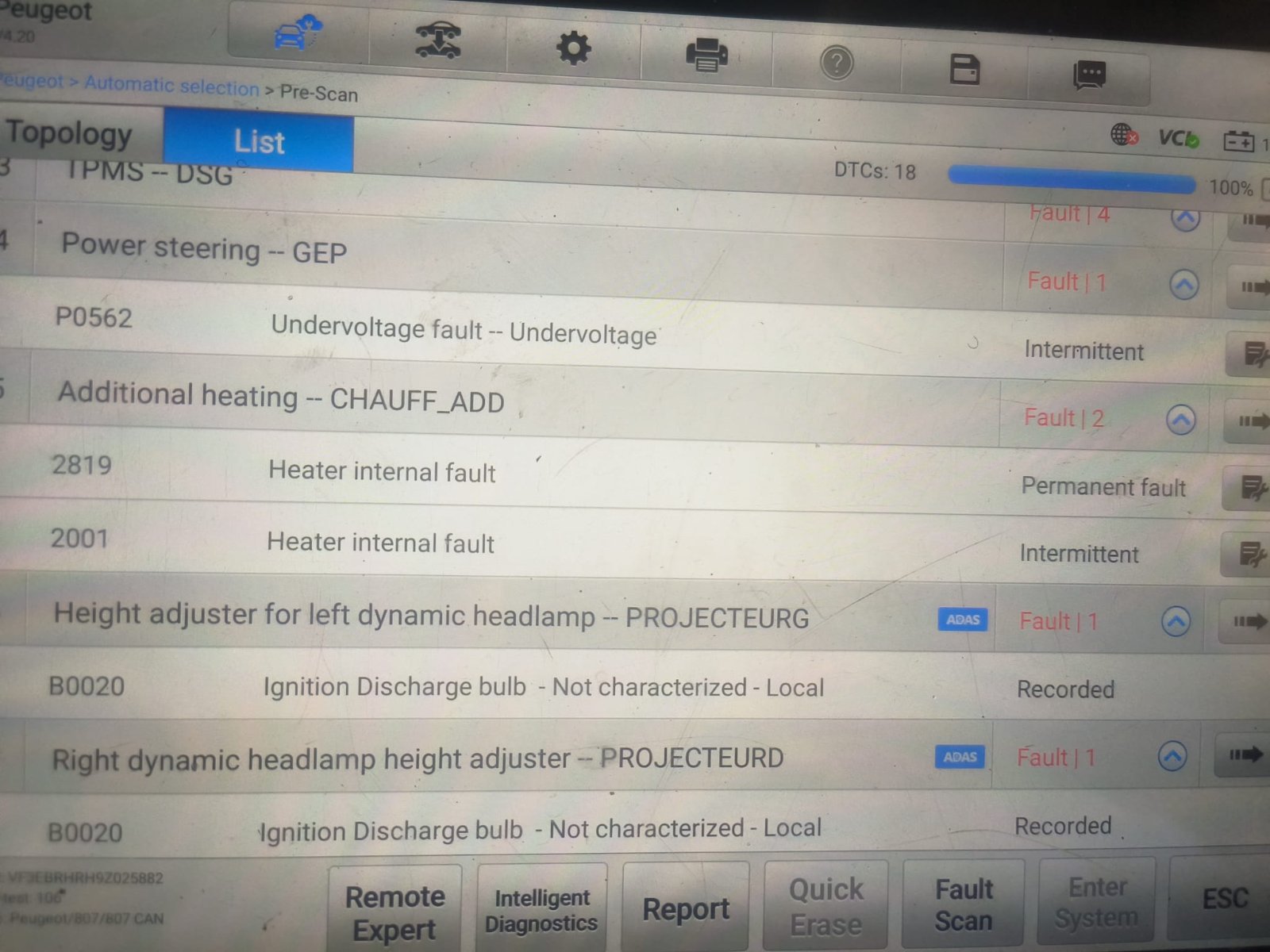

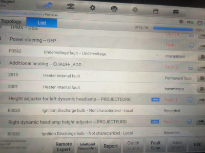

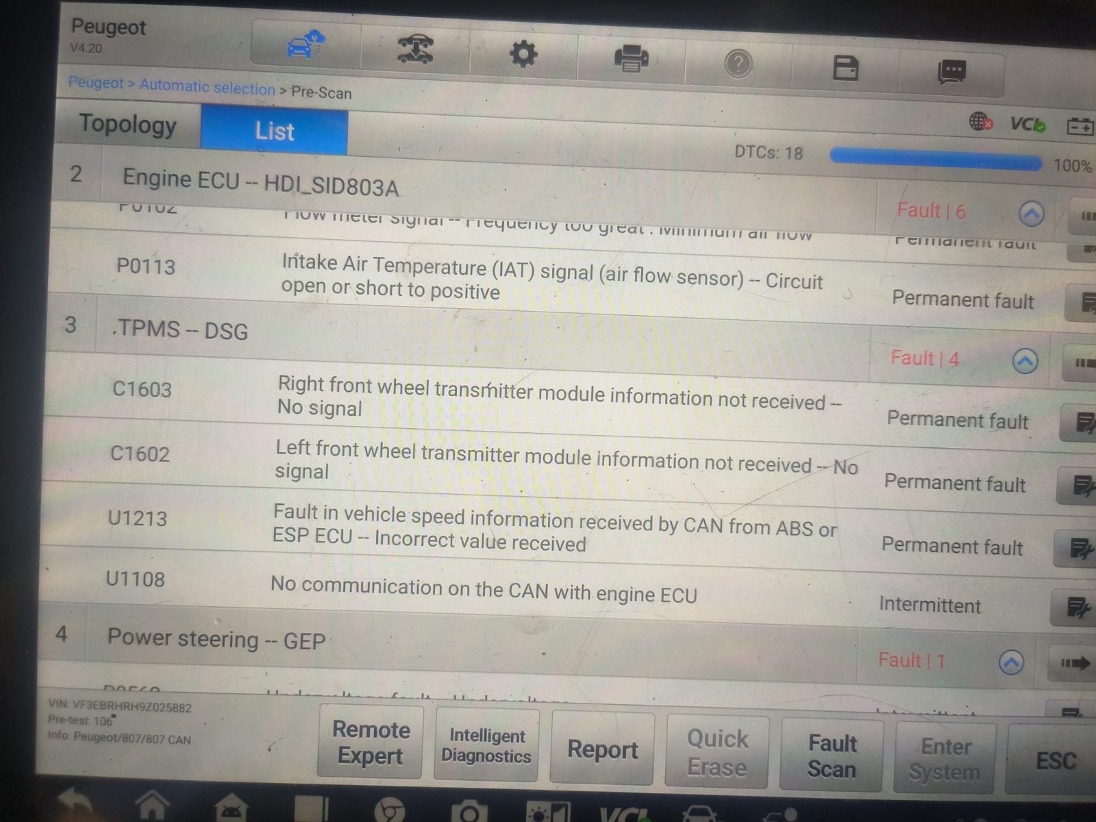

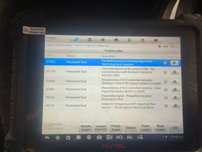

So found a local garage that has refurbished the turbo, but the car will now not start at all, it literally runs for about 10-25 seconds and then just dies.
He has sent me some fault codes this morning to ask if I have seen them as I shared the two I had previously with the engine.
I've not heard of these codes before and I'm now concerned that I may be £1000 out of pocket with a useless car.
Is anyone able to give any insight as to what cause cause the issue, or any further (useful checks that could be done).
Thank
Thank

I'll leave the TPMS fault codes for now as they won't affect the engine starting. According to the codes your air flow meter is shot though and you have an under-voltage situation. A weak battery can cause issues if there is insufficient voltage (see the last fault code below. So I would focus on these issues first.
| Fault Code: | P0113 |
| Description of Fault: | Inlet air temperature sensor signal fault : Open circuit or short circuit to the plus. The voltage of the signal for air temperature at the flowmeter is higher than 4, 8 V for 5 s. |
| Conditions for Fault to clear: | Ignition on |
| Downgrade Modes whilst Fault is active: |
| Symptoms: |
| Suspect Areas: |
| Fault Code: | P0102 |
| Description of Fault: | Flowmeter signal: Measured flow less than the minimum flow. The signal issued from the sensor is outside the electrical tolerance (Frequency too high). Conditions of activation of the diagnostics: Battery voltage more than 7,45 V. |
| Symptoms: |
| Suspect Areas: |
| Fault Code: | P0562 |
| Description of Fault: | Battery voltage signal: Battery voltage too low. Battery voltage less than 6 V (For at least 5 seconds). |
| Symptoms: |
| Suspect Areas: |

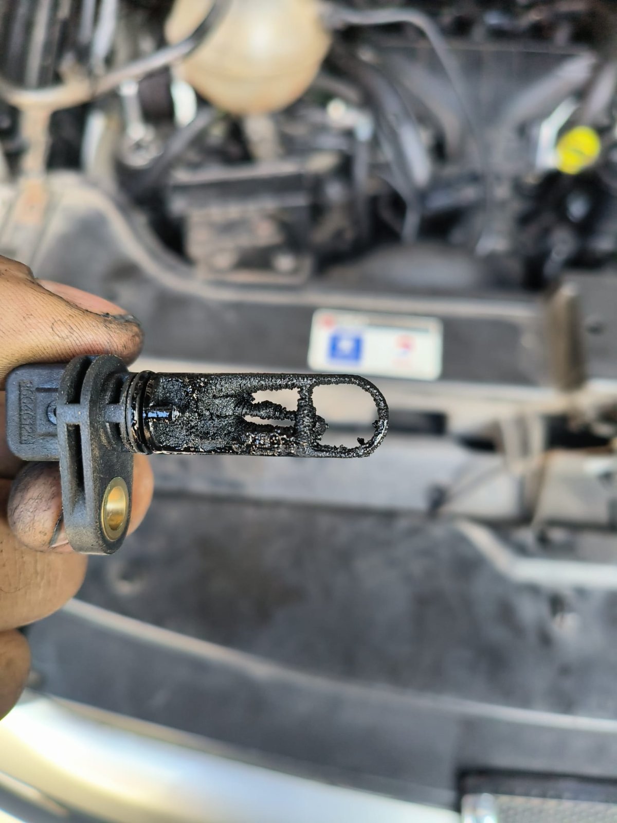

What do you think Marc...
I think it's a bit dirty... New one on the way.
Mark
Owner of a 2013 308 SW
- x 6960
Re: P0299 and P1351 codes
That it totally shot and I suspect not even a clean up will resolve that. This will undoubtedly affect the readings being sent to the ECU and will fuelling with the ECU using default values I suspect. I'd be checking the state of the air filter (make sure you are using a stock air filter) and make sure you clean up the throttle assembly too.
