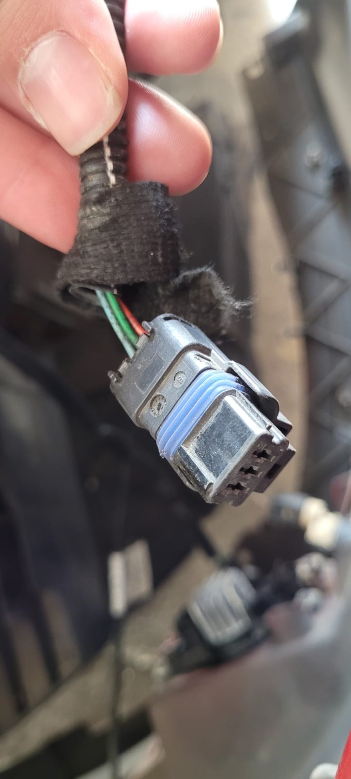

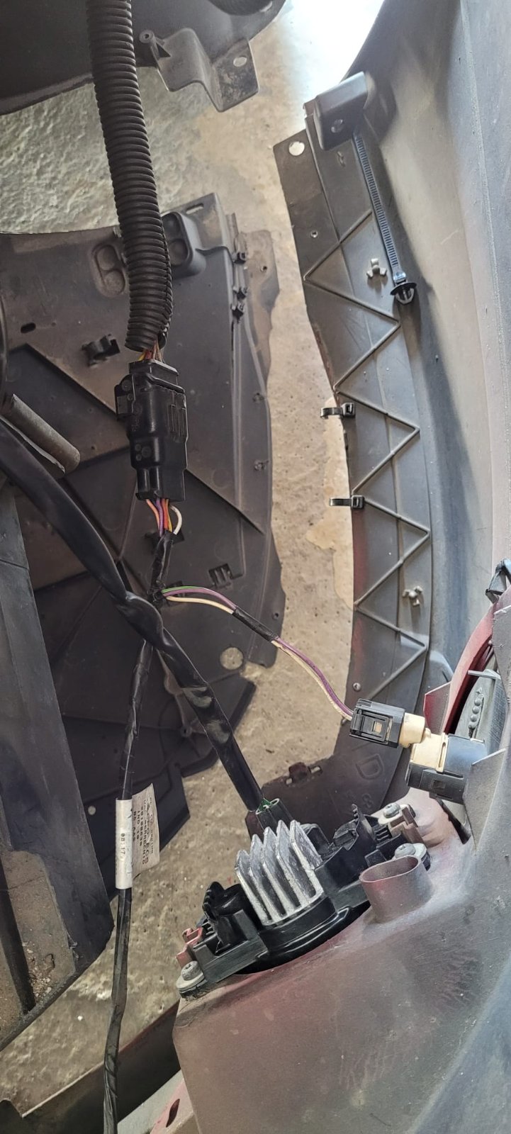

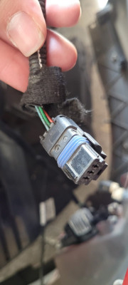

- Removed the front bumper and seems that the parking cables are ok, except for a loose cable (see attached image).

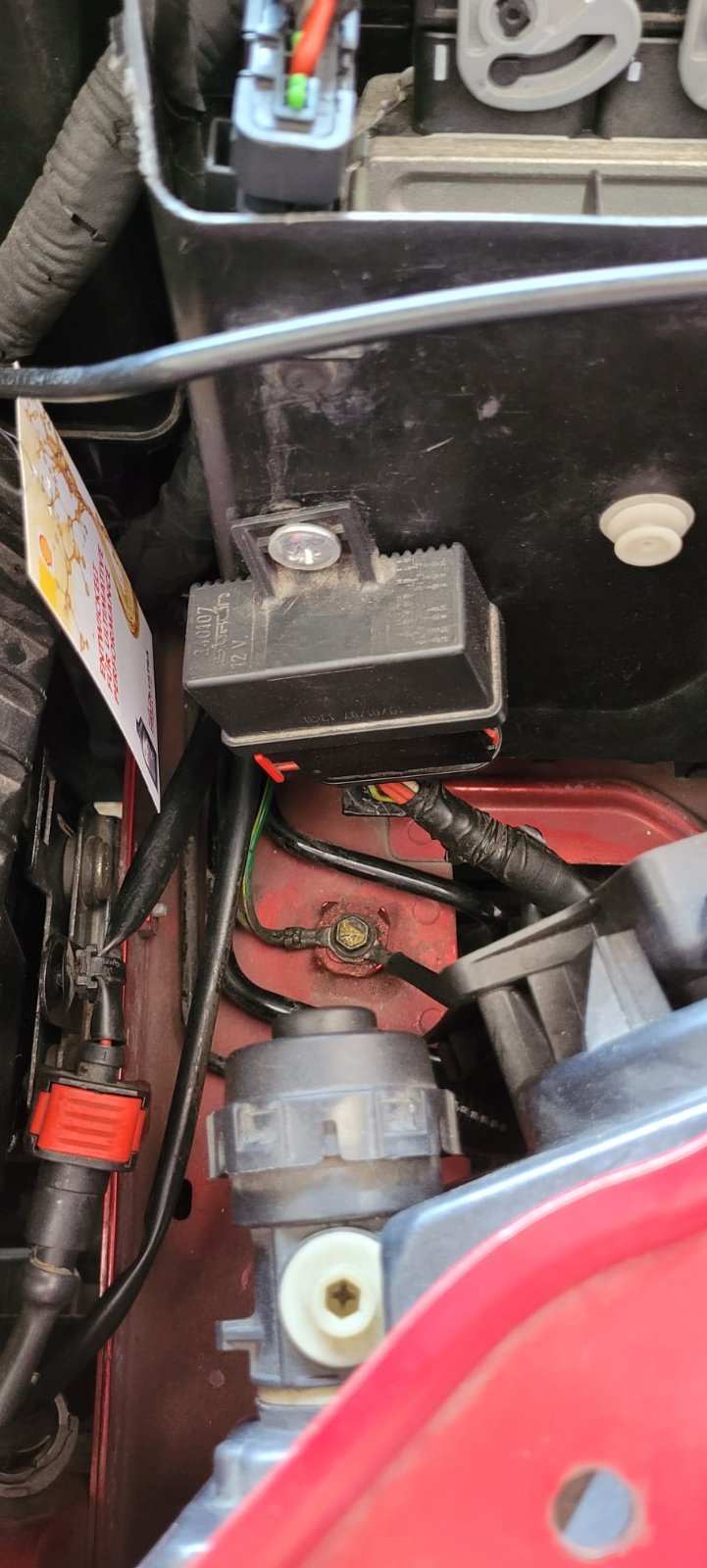

- Earth wire I tried to check, but I have no idea where this is.

Re: C4 VTS with parking assist system fault
So, I only had time today, but good news. I ended up ordering the rear sensors and changed them. It worked! No more errors. I still need to check if the BBDB error persists on diagbox, but on the car display it’s free of any errors. Also, I haven’t figured out the loose cable, but it seems to be an adapted installation for something that was removed, maybe a DRL?
Well, that’s it, thank you!

If, by loose cable, you mean a cable with nothing connected to it, it may be possible that the wiring loom has connections for optional extras that were not selected for your vehicle when she was built.
Yes, that’s what I meant. It makes sense, the VTS also comes with the road assistance as optional, it could be that.
