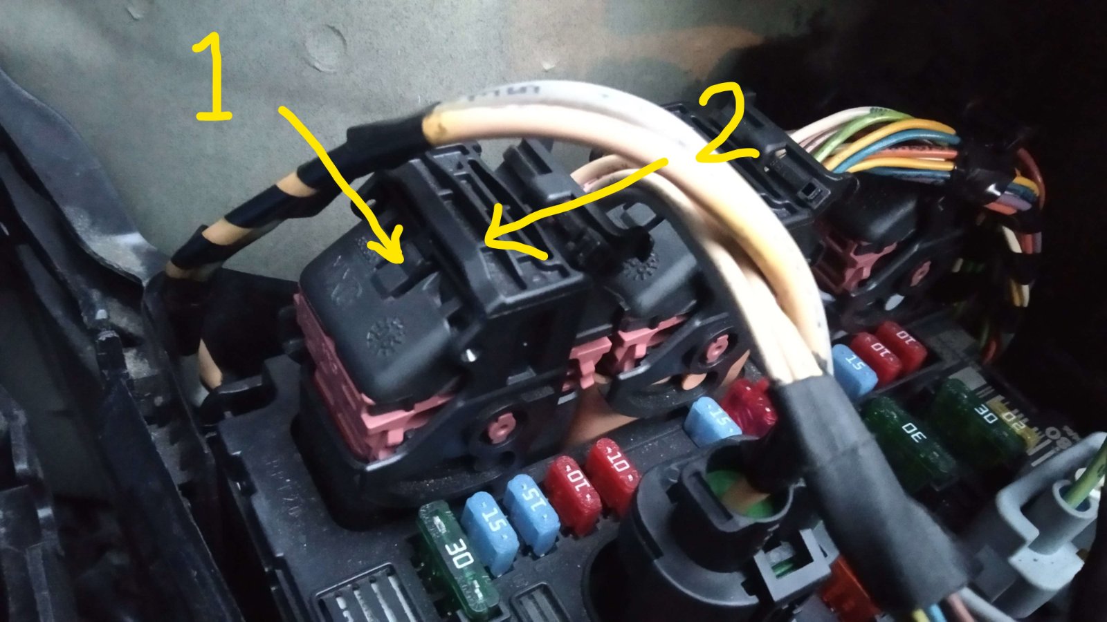

Hello, I need to gain access to the maxi fuses and for that I need to disconnect the fuse box connectors.
However, I don't know how to work with this particular type, as other threads seem to talk about some kind of older type with a slide.
Can anyone enligthen me?
PS. When disconnecting the main fuse bolt I locked my car and now can't access the interior at all. Don't be like me.

OK so you push in on the locking tab at number 1 then push the locking arm (number 2) in the direction of the arrow, this locking lever will rotate about 90 degrees & as you push it the connector will start lifting up.

you are a lifesaver, thank you so much!
On a sidenote, PSA couldn't make it any more difficult to access this fuse box :D
