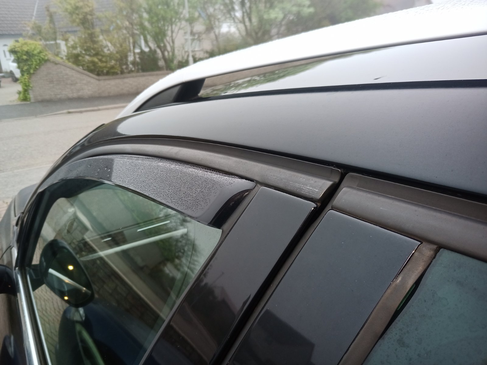

Jay-Bruce wrote: 21 May 2023, 20:36 Going back to the wind noise, exclusives have secondary seals on the doors, which helps with wind noise, wonder if your car has them
Mine's an exlusive so probably has them, it's also got the double galzing / laminate on the side windows.

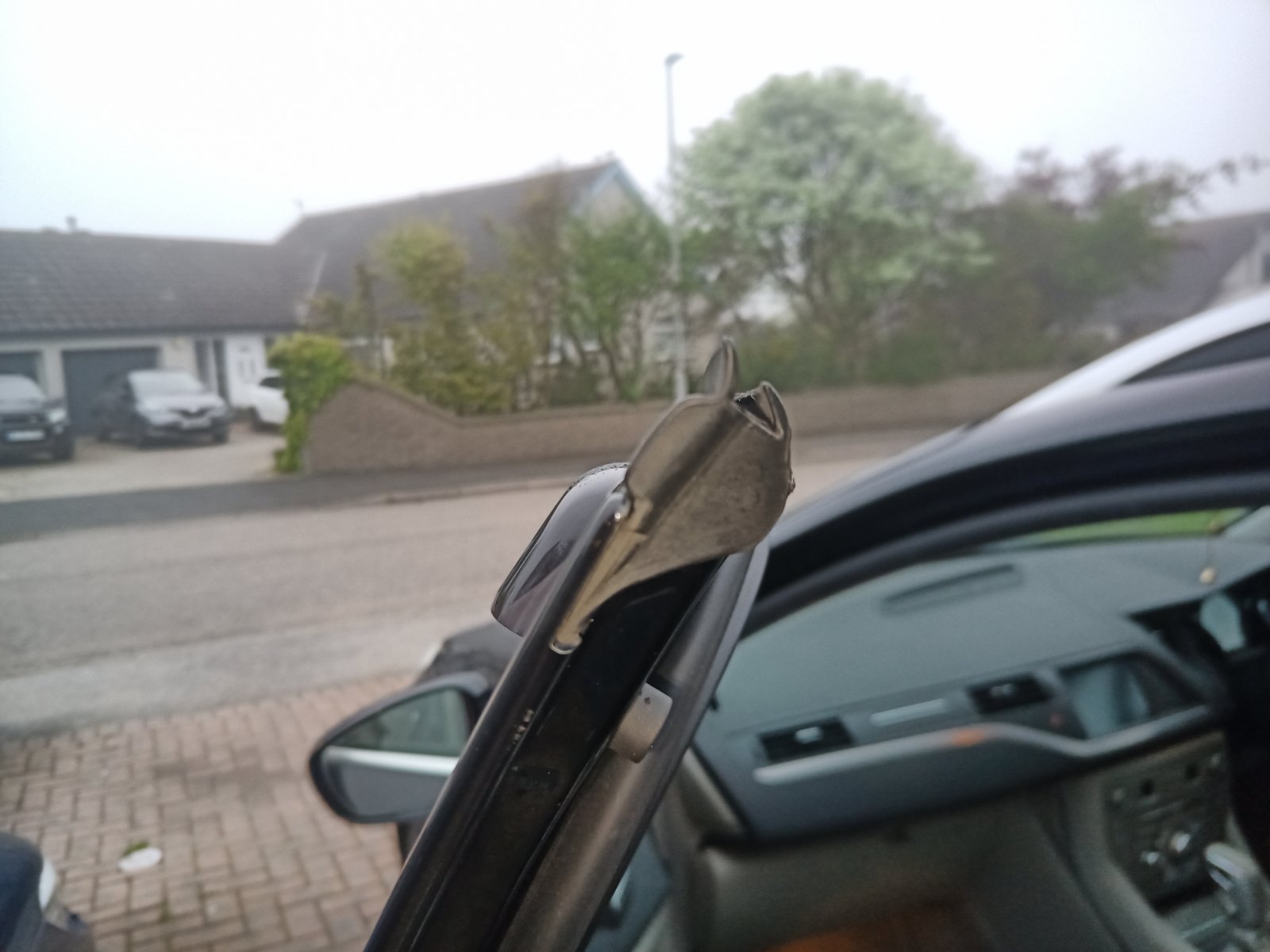

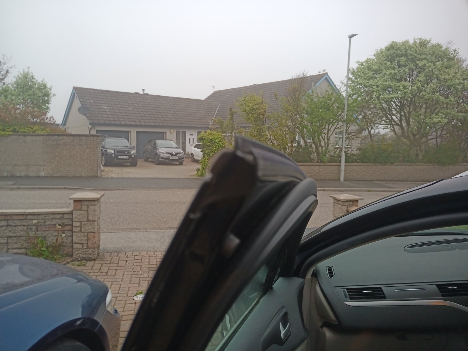

Here are a couple of pics showing these extra seals:
