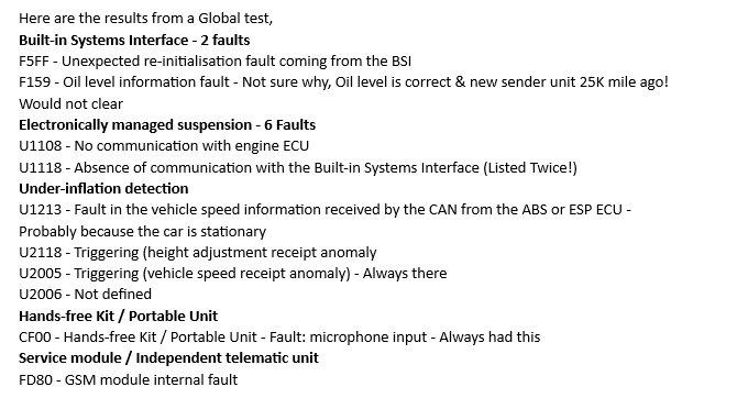

After carrying out a full Global test and willing to ignore most of the faults as I could explain them away
Expert /Global test /Node 3 /Standard parameter measurement /Condition of the back-up battery
  • Communication time available (emergency call) - More than 15 minutes - Is this low? or is it because I had the engine running and it charged up a bit?
In Marcs earlier post he said I should expect fault code FD87, however, I've got a FD80 code which has probably got something to the battery.

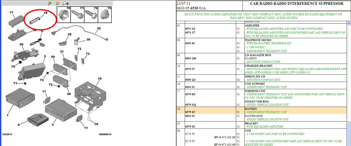

So is this the correct part (6579KT)?... @ £60-£125 - Ouch
Bit peeved, as this will never be used after the December!

Let me check out the other code.... but for now I wouldn't change the battery as this code you have indicated another issue. The batteries are no longer available form Citroen in any case Stu and were £78 when they were available.
So I'm assuming you haven't changed the Head Unit and that it's still the RD4?
Ok, if so, FD80:
Fault Code: FD80
Description of Fault: GSM module internal fault: Not characterised. Internal GSM module start-up error.

Ok, so if the orange light stays solid, it's the battery that needs replacing, but if it flashes, then there's an internal fault with the GSM Module. The FD80 fault is non-descriptive, so just means literally that - an internal fault.
