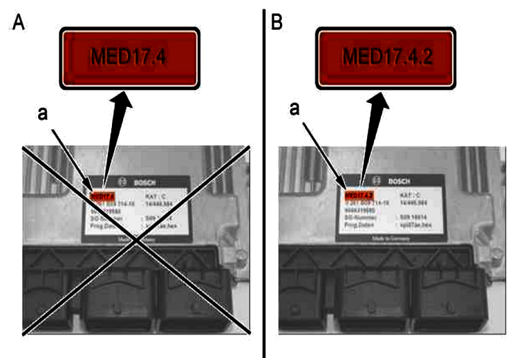

Ok, so there are 2 types of Engine ECU versions on this vehicle and the codes have different meanings depending on which you have.
Check the label on your engine ECU as shown below, and let me know if you have the 17.4 or 17.4.2 version:

Hi Marc,
Seems The ECU for the 2012 Peugeot 3008 is inside the Fuse box Screwed Down with a Metal Bracket except if I am looking in the Wrong Place?
Is There Any Other way to Get the Version maybe via Diagnostic Tool or Any Other Way?
I'm Just Afraid if I start Playing Around there That I damage Thanks?

I got Hold of The ECU Version, It's 17.4.2.
