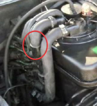

On the LHM reservoir there is an out(?) connection with a plastic pipe splitter, and on top of that (where the plastic splitter starting) i saw bubbles...
Then i loosened the 2 high pressure out pipe on hydraulic pump for a moment while the brakes was pressed. Brakes work again, the steering become so much smoother, still not perfect. While driving, the stop light pop up from time to time, but just for a sec or two, then fades away.
Ordered a new accumulator sphere cause the "ticking" noise time, however now i think this problem more related to air leak in the system, maybe bad pump or pressure regulator.
