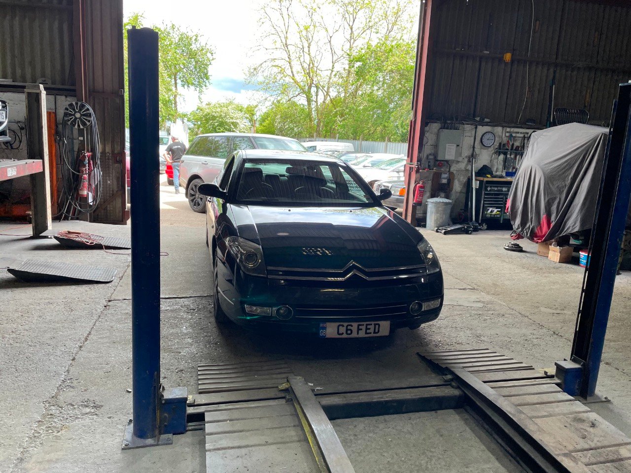

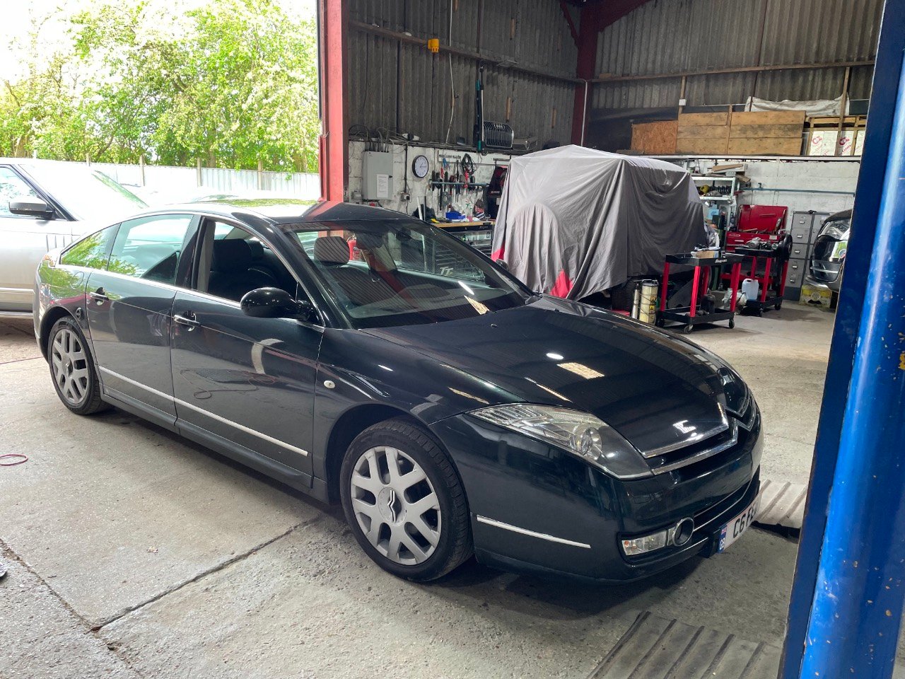

I have one of the few C6 petrols and it has been my main car for some time, as was the last one. This one seems to be more of an ungrateful bastard than the last which has at least double the miles of this one and is merrily tootling round Wales with its new owner.

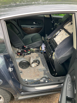

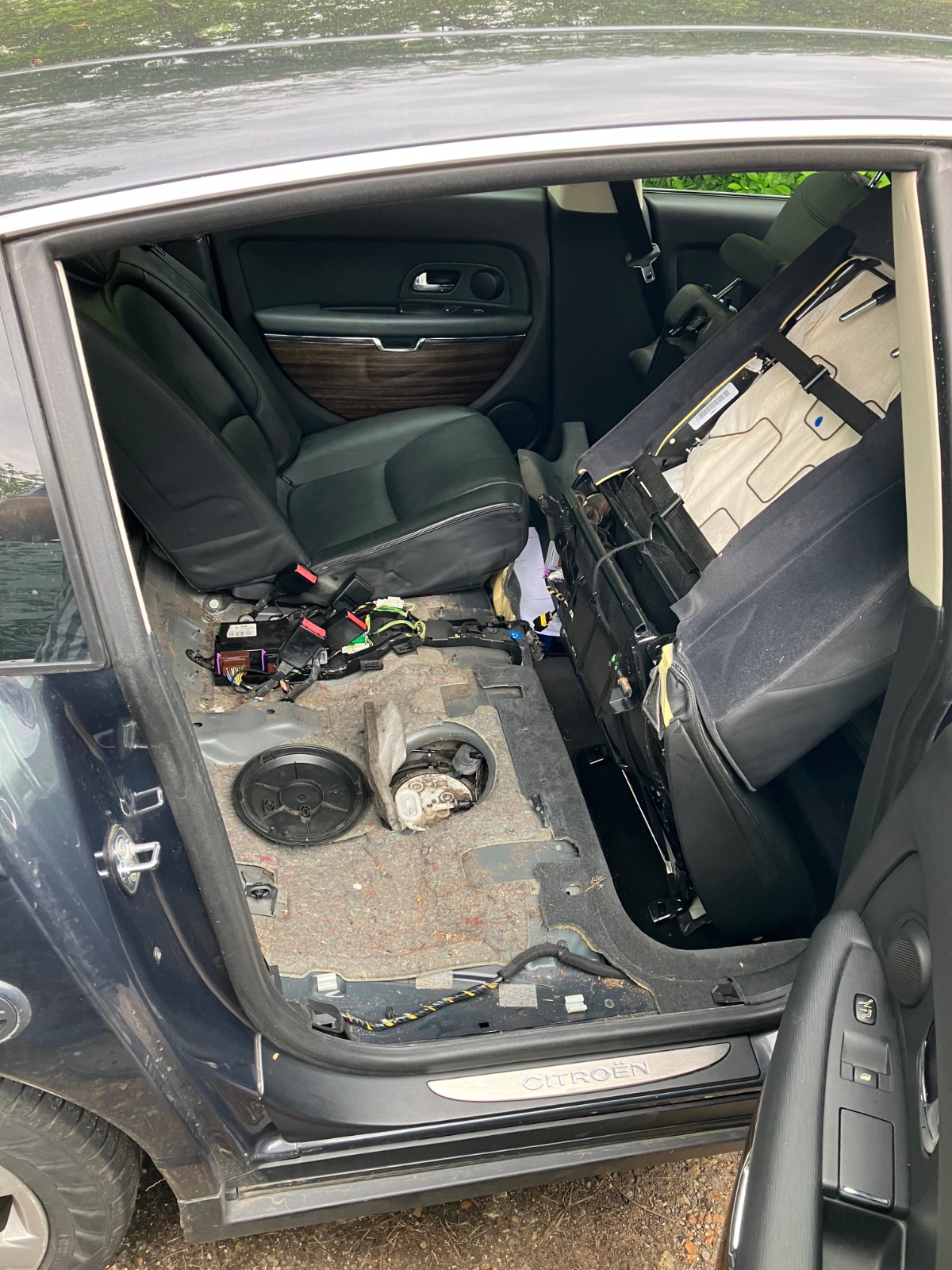

I was driving home from work on low levels of LPG and decided to switch to petrol just before the one big hill as its not mechanically sympathetic for it to do an automatic switch over when you boot it up the hill. Background information: that the car is too clever for its own good and the petrol gauge counts injection pulses after measuring the float sensor at fill up time-- absolutely stupid, but that's PAS for you. As a result of this, the petrol gauge often is much lower than it says but I keep a decent amount in and throw in some more to reset it now and again.
What happened this time is that I must have accidentally ran the tank nearly dry as when I put my foot down to go up the hill it basically cut out on petrol and threw up a gear box fault. Manually switching it back to LPG had the engine working fine but the gearbox was still in some sort of limp mode, only reaching 3rd gear.
I drove home on gas and in 3rd gear (V6 does sound nice).
Usually it needs to start on petrol first and switches itself over to LPG once warmed up-- a usually seamless automatic transition. I suspect I have cooked the petrol pump by running it dry for a while at a minimum. The gearbox may not have liked having the engine cut out at full throttle and may be fine when restarted or it may have utterly s**t itself (I'd say 50/50: although the fluid was reported as very good condition when it was last changed in January at its service, it did feel a bit s**t when I ragged it recently.
It wont start on petrol and I can't get the emergency start on LPG feature to work so it is stuck in the village hall car park where it will fast outstay its welcome. I bought this from Chevronics for £4000, sold-as-seen, with no MOT and cracked windows and have spent thousands on it since over the last year or two. Anything BL Autos ("the" specialists on these cars) have said it needs, it has had. I am sick to the back teeth of spending money on it and wonder if anyone might want to take on the batton and run with this one as I'm out.
MOT is until March 2024. Mileage is about 110,000

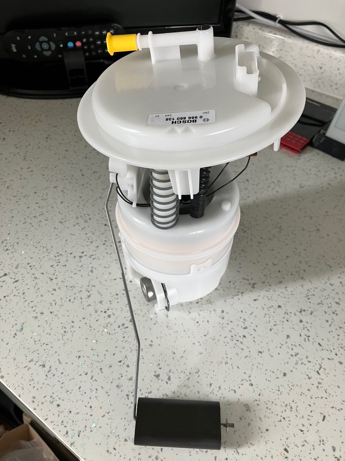

Hey Simon. I had severely lost my Citroen mojo when I wrote the first message. I installed a new fuel pump today and all is well with the car… and most importantly the gearbox!
I’ve given it a serious clean inside and will do the outside tomorrow. I feel back in love with it again and TBH it was my fault that the petrol pump burnt itself it out as I’d ran it so low while running on LPG. I think there is an emulator you can install that makes the car display the right fuel level… this is my next task.
