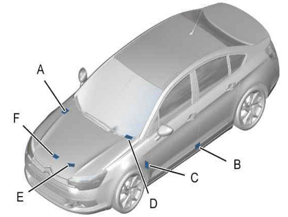

If it's your engine serial number you need for your X7 John, then it's:
10 DYWT 4009151
"A" Vehicle’s VIN no. (The number is engraved on the body on the upper part of the wheelarch).
"B" After Sales / Replacement Parts identification label - Tyre information and pressures (Label on the front pillar on the driver’s door side).
"C" Vehicle manufacturer’s label (Label affixed to the base of the centre pillar) - On the right-hand side .
"D" Repeat of the vehicle VIN (Visible through the windscreen).
"E" Gearbox reference - production serial number.
"F" Engine legislative type - production serial number.

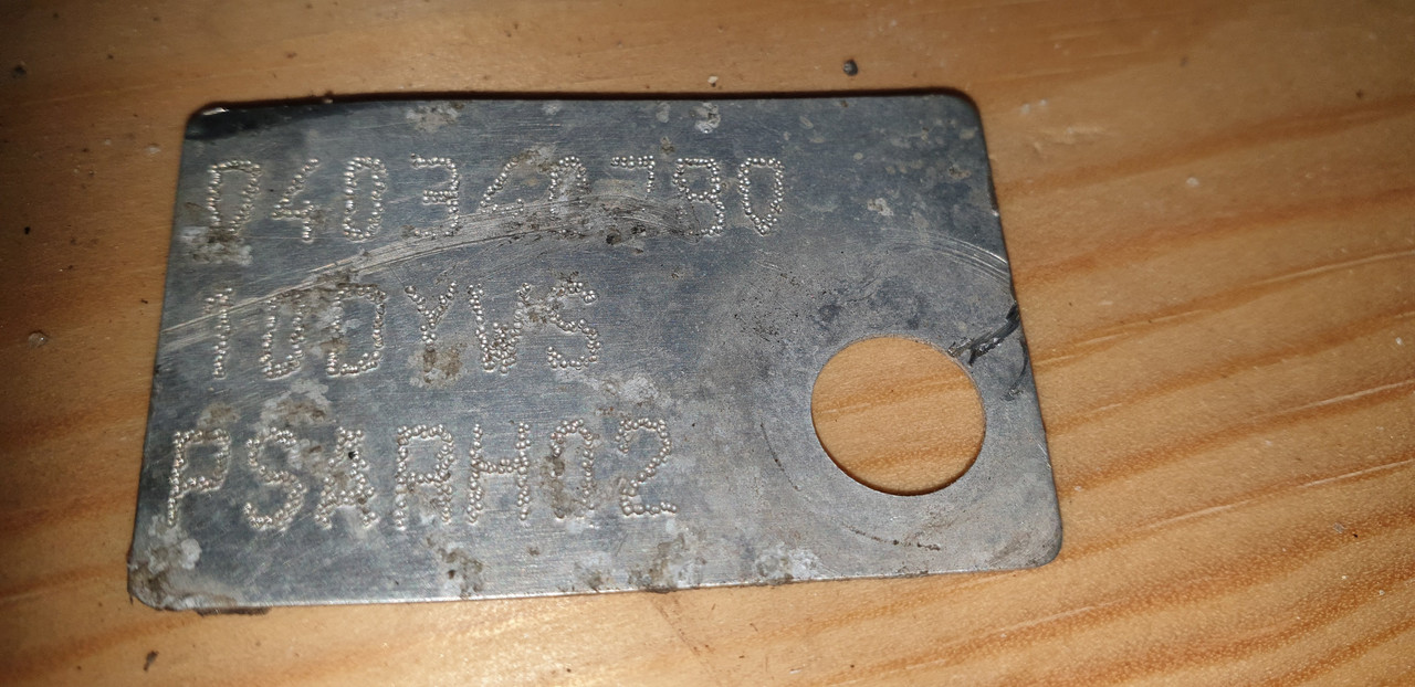

many thanks for replying Mark.. The engine was changed in the past, but the new engines Cam cover ally label is slightly illegible. I can read 5 out of the 7 digits .. I was hoping the same number would be stamped on the block.. I will have gander later on ramps with a torch, mirror etc ;)

I cant see anything on the block, there is just too much in the way :( .. Marc, is there a way of back-referencing what I think the new engine number is ? doubtful I guess..
my guess is 4034 078 10DYWS PSA RH02
It think it came from a DS5, 2012 possibly.

Unfortunately I can't John as it's an engine serial number. But the PSA RH02 does bring up a 2.0 Hdi engine on the web like here:

thanks Marc.. anyone want a guess at the upper most number on the plate? :twisted:
