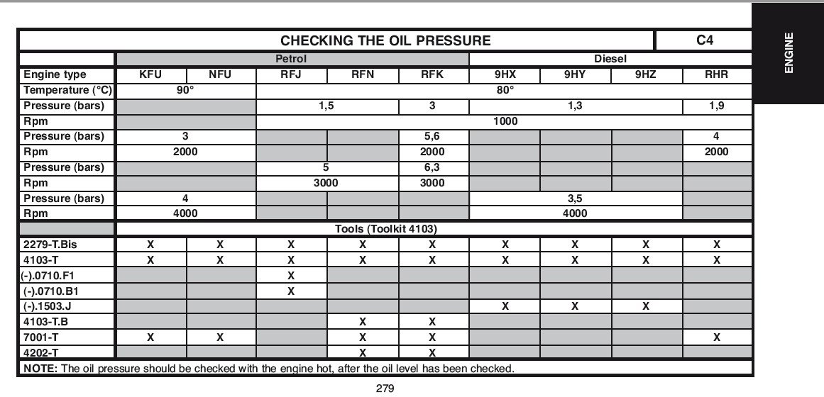

Hi Guys - I need to measure oil pressure on C4 (EW10A) 2L petrol 16V - does anyone have pressure figures versus rpm. I have found the below ones for EW10J but not sure if they apply to EW10A.
engine EW10J4
check 1 at 1000 rpmminimum pressure (bars) 3.4
check 2 at 2000 rpmminimum pressure (bars) 6.3
check 3 at 3000 rpmminimum pressure (bars) 6.9
check 4 at 4000 rpmminimum pressure (bars) -
the values given are in bars for an engine which is run in, at an oil temperature of 80 ° C
Thanks Tom

Match up the engine code with the 6th, 7th & 8th digits of the VIN.

thanks wheeler - good stuff
