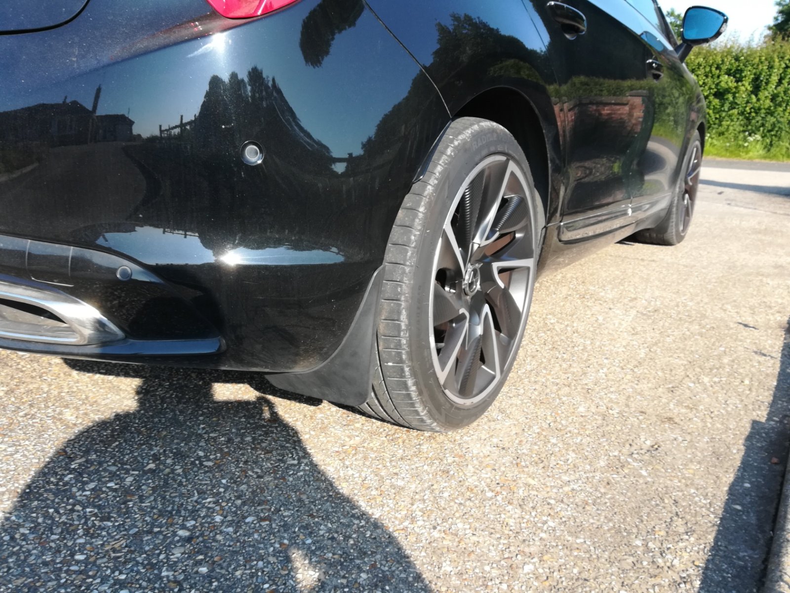

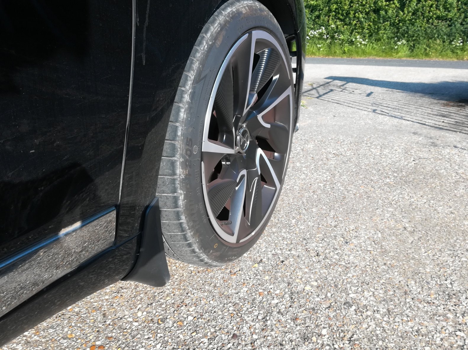

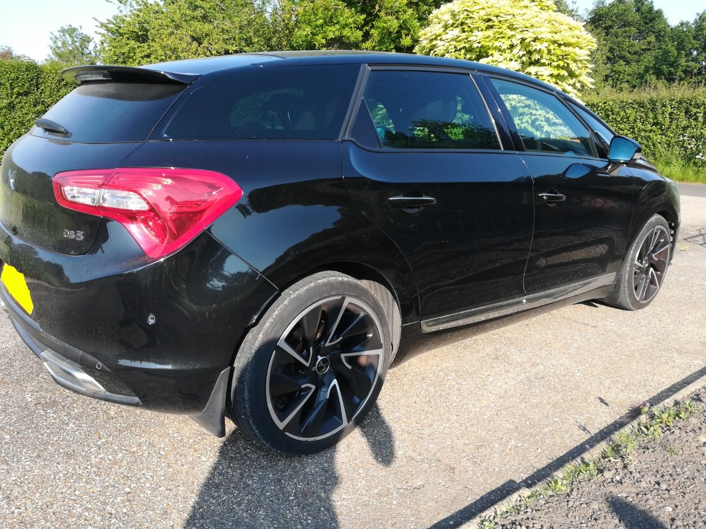

Fronts finally fitted, here's the full effect...
Comments appreciated (good or bad, I don't care!), but I like em. The main point is to stop the front doors, door openings and boot getting filthy. Also to preserve the car. I was fully expecting them to be a bit ugly. But from a pimp-my-ride point of view I think they're actually an improvement too, which is an unexpected bonus.
I fitted the backs, a local garage did the fronts for £36. It looks like they may have wiped a bit of polish on them too. The existing bolts needed to be cut out and replaced, as they were pure rust into a rusty spire clip.
I've been continuing my survey of passing cars, and I've concluded that mud flaps are almost extinct now. But following the crowd isn't always the best way.

Re: DS5 £13.50 set of 4 mudflaps!
I think they look fine and look like they belong. Car looks good to, first time I've seen a black one. Mine is dark purple so I think I'll get some and see how they look
