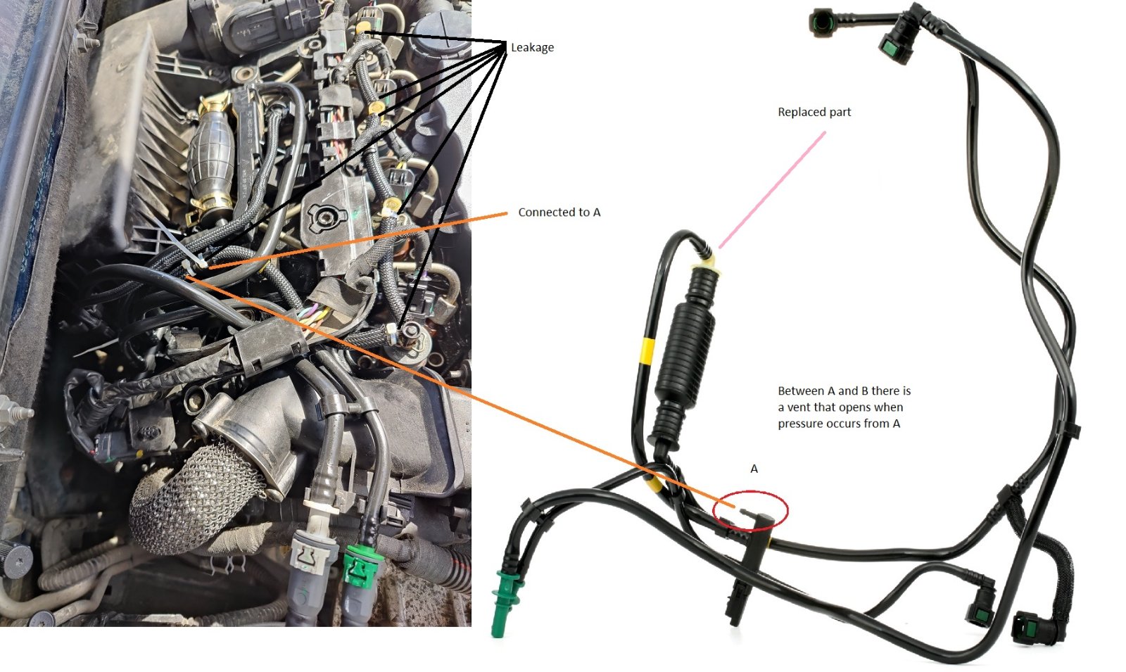

Hello,
I've just had some problems and had to change the fuel-line (bulb and so on, see picture)
Now I have new problems...
The engine starts and runs but the return lines (I think they are return lines) from the injectors have started leaking but I havn't touched them, where could I've gone wrong?
Description of leakage
