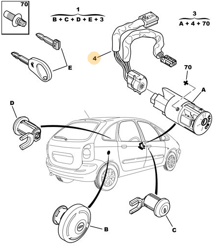

Hi Miles, I've moved this out of parts for now as it's more of a technical issue.
There's no modification notifications showing anywhere, but sometimes a faulty ignition barrel can cause issues with the heater blower motor working or not, so not sure if this is what you are referring to.
There's no official acknowledgement of this particular fault, as the issue is caused by people having lots of keys / keyring fobs and other paraphernalia hanging on their car key chain. The weight of all these objects whilst driving the vehicle loosens the barrel internals and ultimately the electronic wiring / block internally that causes faults. Replacing the internal barrel electronic block seems to cure this, but the answer is not to overload your key fob with objects.
Here's a video on replacing it - this bloke has the same issue:
Item (4) is no longer available, but I believe you can get them aftermarket (original Citroen part was: 4162HK)
Some available here:
https://www.ebay.co.uk/sch/i.html?_from ... K&_sacat=0

Defo the barrel worn, i had a mk1 xantia worn ignition barrel had to wiggle to fire up i think the big thick live on these is shared with the heater, ebay do a barrel not to expensive, i changed one on a picasso i owned it decided to jam up , pretty simple to swap out.
Husky.
