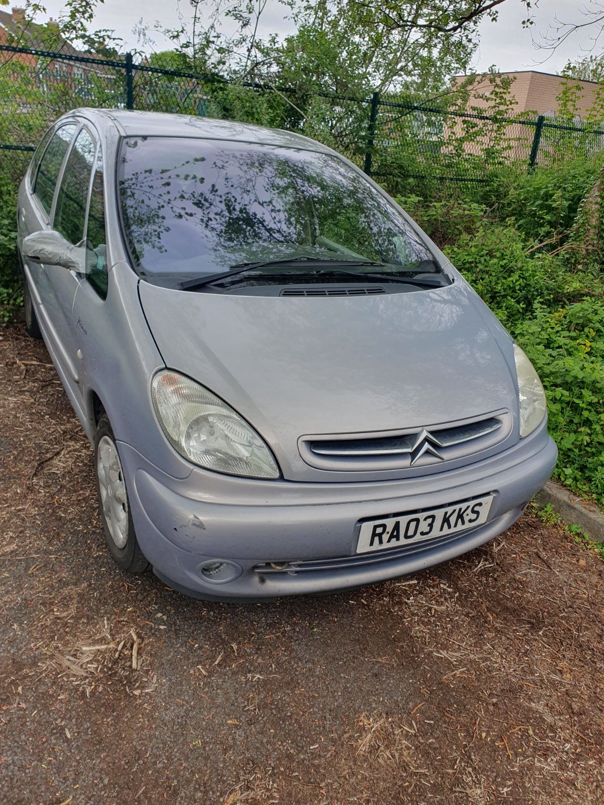

I picked up my weapon of choice yesterday which was very generously donated for free from a friend of the family. It is a Xsara Picasso, 2.0HDi. It has done almost a quarter of a million miles and is still going strong. There is not one straight panel, it is largely made of gaffer tape and is full of dust. But as it has been that far already, I'm sure an extra couple of thousand miles there and back won't be an issue! The route begins in Reims and ends in Nice, travelling via many places in neighbouring countries such as Switzerland and Italy.
I drove it home yesterday and it is still surprisingly comfortable and drives in a nice straight line. We are putting it up in the air at the weekend to check it over for any mechanical issues that may cause a safety issue and will rectify these before the trip. It has a rather loud knock from the front suspension and the nearside front tyre has seen better days, from the quick look around that I've done.

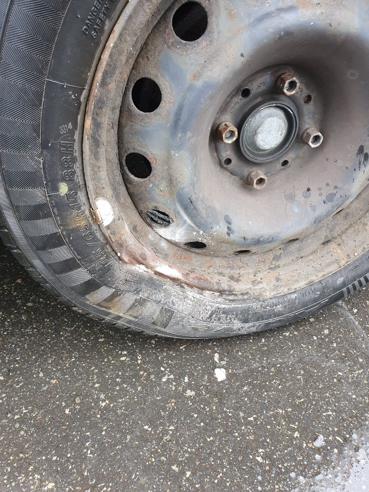

I decided to have a crash en route instead! Turns out a Xsara Picasso is exactly the same width as tram lines. I'm used to driving on them as I work in Nottingham, but it was absolutely pouring it down at the time and I must have just caught the road wrong going around a bend, as somehow I managed to flick the front end sharply to the right and started to skid, so I turned in to it which stopped me fairly quickly (albeit dramatically) but unfortunately smashed the nearside rear wheel in to the kerb on the opposite side of the road. Amazingly the tyre still held air afterwards so I was able to move it somewhere safe to put the spare on. Amazingly it was the only damage too, I was expecting all manner of issues as it felt quite a bad impact.
Damage to the wheel after I removed the now broken trim
Luckily nobody was in the area so nobody saw me, and more importantly nobody was hurt! It also confirmed the plan to fit new tyres as the car is surprisingly unpredictable in terms of steering in the wet. It currently has a mix of old ish Yokohamas and one Michelin that has a sidewall full of cracks.

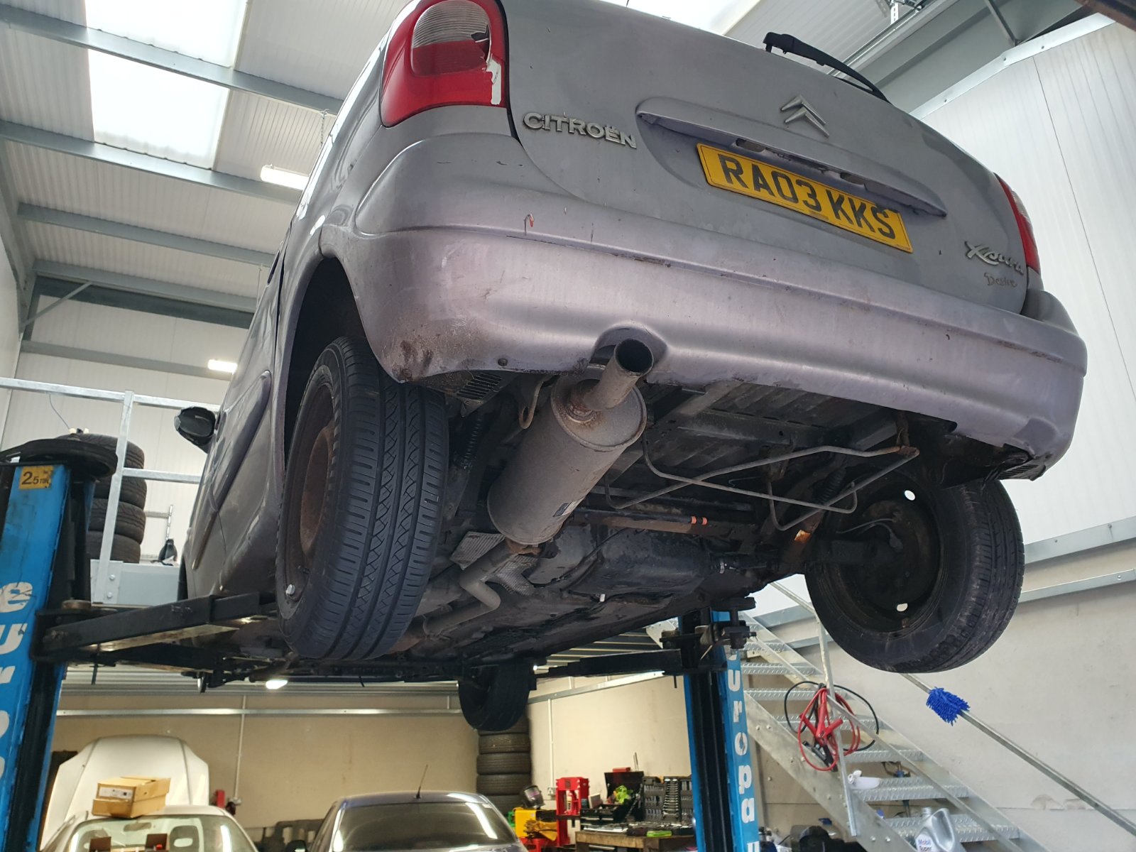

Anyway... when I eventually managed to get it up in the air, we had a look around and the car is surprisingly solid underneath. It has had a new exhaust front to back (including a new eurocat) at some point fairly recently, and apart from one area that has been welded on the nearside outer sill, which seems inevitable on these cars, it has no areas of anything other than light surface rust. A very functional and reliable car it seems, and having been in one family from new, it appears they took care of the important stuff and it owes them nothing for the mileage they got from it!
The only issues we have found are the nearside inner track rod is excessively worn (that will explain the vibration at speed), and the offside track rod end has also seen better days, so a pair of inner and outers it is. Front discs are lipped and it appears one of the offside pads has started to break apart. By pure chance, I happen to have suitable discs and genuine pads in the garage and they now have a use! Other than the above, we will give it an oil and filter change, an air filter and some other bits to make the journey more comfortable (such as repairing the blowers, which aren't working at all). There is also a water hose from the radiator that I'm not happy with, it looks like it won't last too long so I've ordered one as a preventative measure.
Having a gander...
Having a gander...

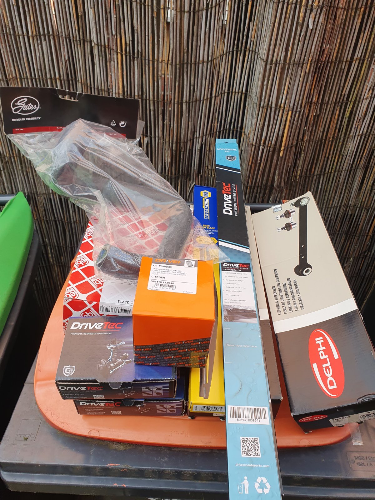

Gathered my parts required for the Picasso over the last couple of weeks courtesy of Parts In Motion on eBay (a good range of mainly service parts, but plenty of other bits too particularly for PSA stuff), and some bits from my local GSF. Ordinarily I wouldn't buy "Dr!ve" branded oil filters, but it was what they had in stock and I'm not sure how much difference it will make in the couple of thousand miles more the car is expected to last.
New wipers were a bargain at about £2 each, the reason being they wipe well for the first few months and then are garbage, again, I would only usually buy Bosch or Valeo for my own car, but DriveTec ones will do, keeps costs down, and anything was better than the worn out torn scrapers that were on before!

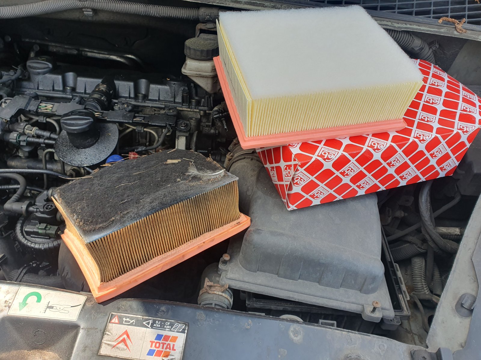

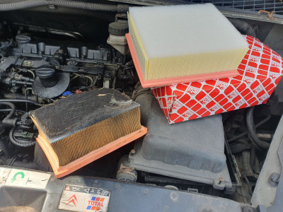

Unsurprisingly, the air filter condition was not helping matters in the mechanical side of things, the idling has been somewhat lumpy and the car felt even more underpowered than it already was from factory. £6 and 3 minutes work later, it was improved massively. Why so many people do not do such basic maintenance tasks is beyond me!

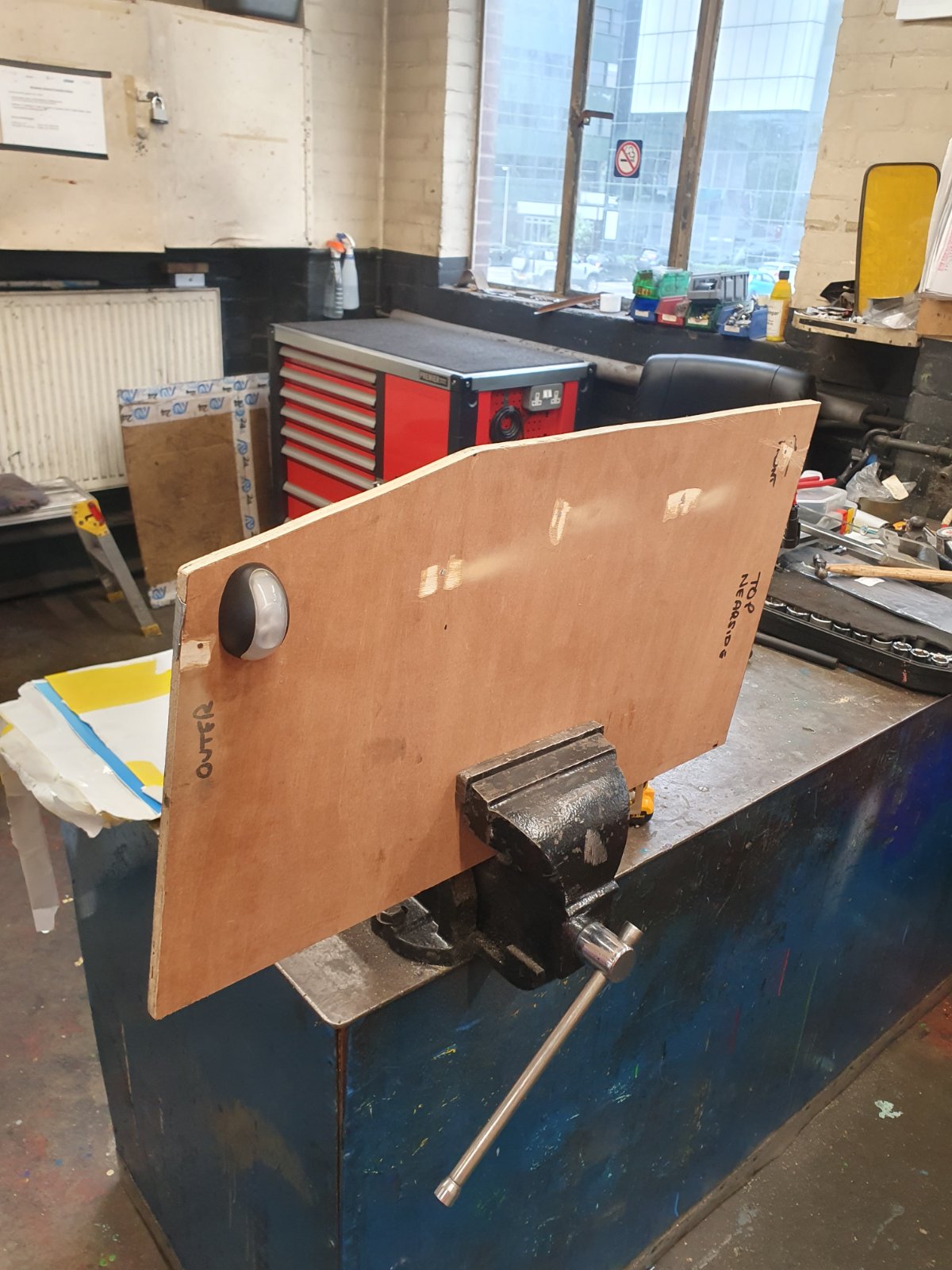

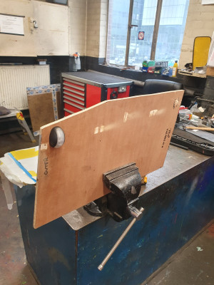

On the cosmetic side of things, I've been busy with plywood and a jigsaw making winglets and a tailfin!
With red and green lighting on their correct sides of course... the wings will of course be quickly detachable as it would be irresponsible to drive with them attached, they are purely for aesthetics during the rally photo stops etc!
