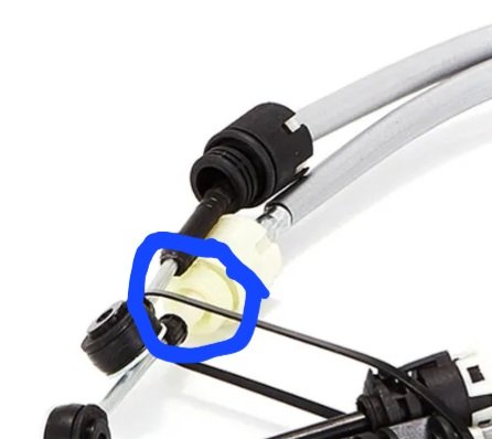

I think I have found the problem the smaller round circle piece has snapped the the mounting clip if that makes sence

That's a lot better news if it's the cables. They don't sell those specific parts separately, so would likely have to be a new cable set, but better than a gearbox overhaul.

Correct me if I'm wrong lol but am i right in thinking the black cable is for forwards and backwards and the white one is for left and right. If that is correct then am I right in thinking the that if that piece has snapped off that would not give the full range needed to get to 5th and 6th. Obviously I know it's not needed for 3rd and 4th and I don't think the cable needs the full range to get into 1st or 2nd
