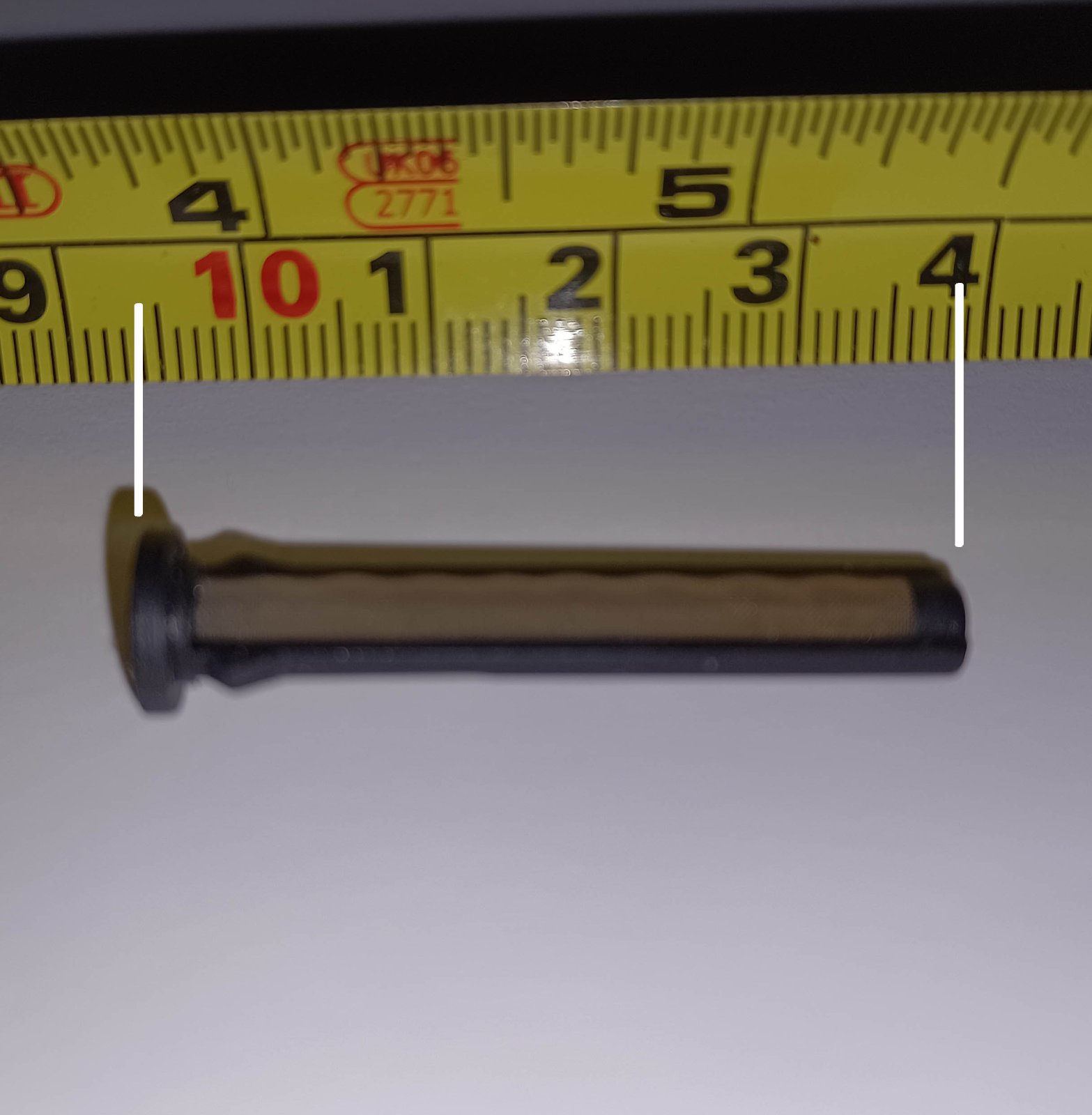

ID this mystery in-line filter
Unread post by Stickyfinger »
ID this tiny mystery in-line filter....I can only think it has come from a XM engine or some place from a Xantia..... I am stumped.
wheeler
Posts: 7930
Joined: 21 Sep 2002, 19:07
x 1055
Re: ID this mystery in-line filter
Unread post by wheeler »
Looks like the little strainer you get in the oil feed pipe to a turbo.
Posts: 5317
Joined: 25 Apr 2022, 09:03
x 2342
Unread post by MattBLancs »
wheeler wrote: 27 Apr 2023, 19:16 Looks like the little strainer you get in the oil feed pipe to a turbo.
Was just going to say the same thing!
Sloppysod
Posts: 1530
Joined: 23 May 2015, 23:35
x 396
Unread post by Sloppysod »
You get similar filters inside fuel tanks, attached to the tap on motorcycles and lawnmowers!
Stu 🏴󠁧󠁢󠁷󠁬󠁳󠁿
Posts: 11836
Joined: 28 Mar 2013, 21:05
x 1996
Well the only Turbo engine I have stripped etc was the XM.....BUT..... there is not a filter listed in the parts list for the 2.1 TD XUD11BTE which is fitted in my car or the early XUD11ATE (the parts engine).
x 6945
It's not a Xantia one either from diagrams. Surely those would be circular filters anyway and not vertical filters. It almost looks like one side of the 'cone' shaped filter in an LHM tank, but it's not that.
x 2938
The ma in law had a gas cooker that kept fading out, I found that it had just such a filter on the input pipe, blocked with rust from the rusty old iron mains.
x 6945
👍 Well sussed Eric.
