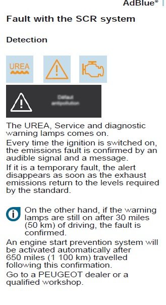

Hi,
The Emissions Control fault light along with the organge Engine light is coming on/off in my 2017 Partner Auto Dsl. No Remaining Distance is displayed.
Would this be caussed by not driving the car for a long distance for a while? Or would it be more sserious?
Any advise welcome?
Thanks
x 6955
Re: Emissions Control fault
Have you had the warning on to top up the Adblue system? If so and if you ignore the warning and the countdown has reached zero then you won't be able to start the engine.
If not then you'll need to get id properly diagnosed to see what the issue is.
