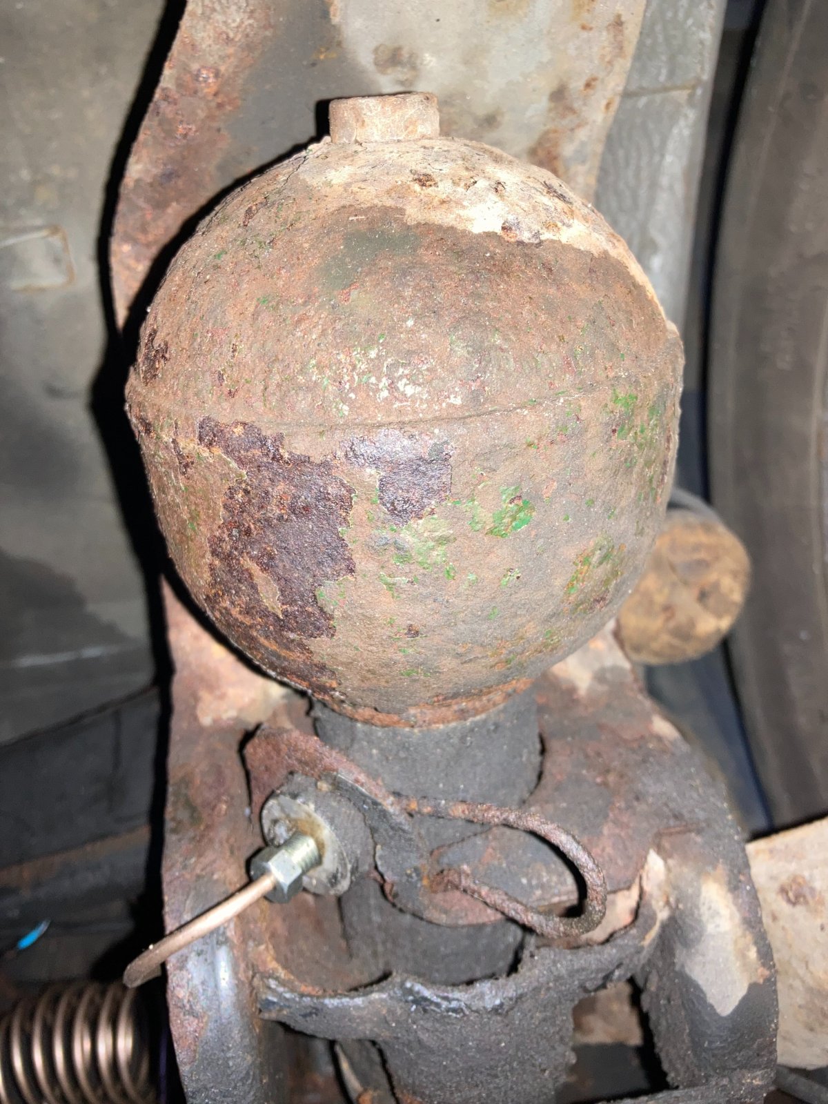

Here's a healthy looking sphere ripe for regassing...

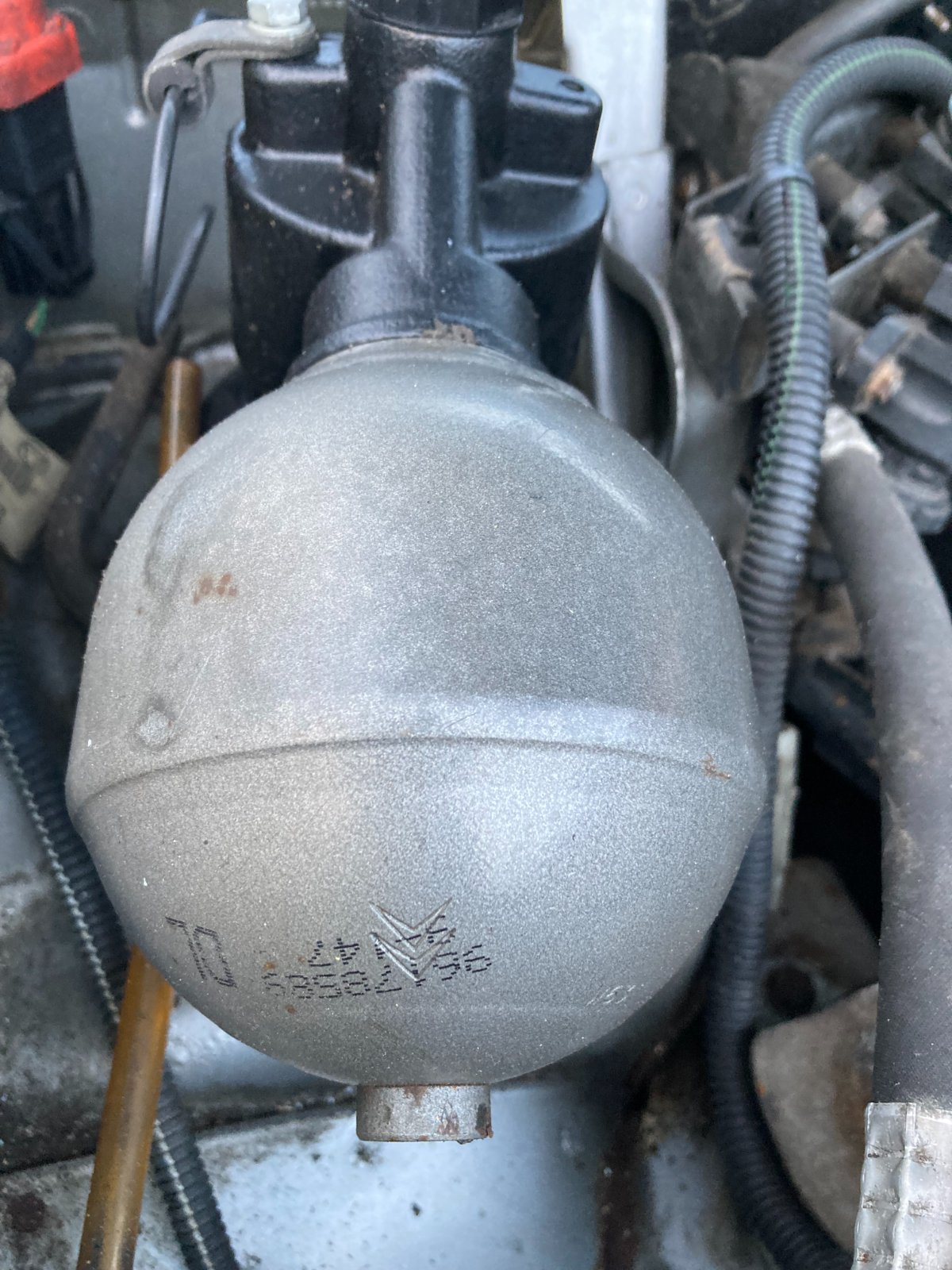

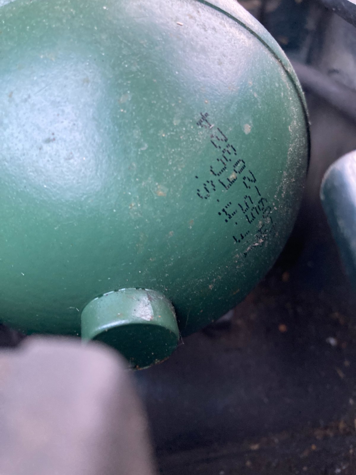

And here are the other types:-
Is there a guide somewhere to indicate which type have the monocouche diaphragms? Is it monocouche? I thought that was a type of render...

Re: Here's a healthy looking sphere ripe for regassing...
Unread post by Stickyfinger »
You never know, outwardly it may look crap but it is what is inside that matters.
Unread post by Armidillo »
Multilayer (long life) spheres are marked with 3 dimples at the top (near the filler).
