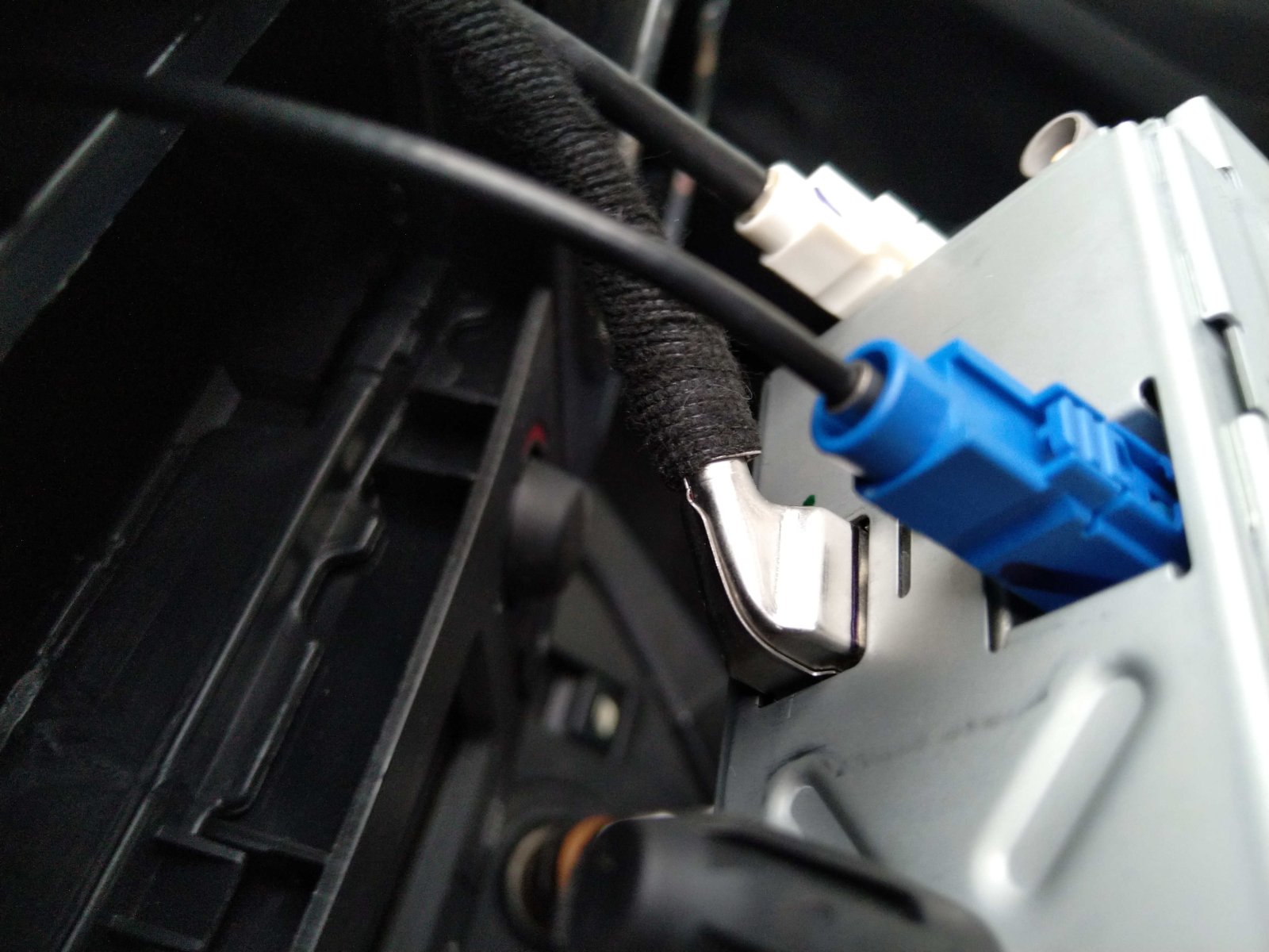

could you please tell me what the purpose of the FAKRA connectors "a" (gray), "b" (blue) and "e" (white) are?
It looks like my Berlingo is missing the wiring for connector "a". I also have a lot of issues with the latest firmware, GPS always gives me dates in the future (year 2199), also RDS is not working properly. It always shows a text with says, you are listing to radio station "Text of song or number of phone book".

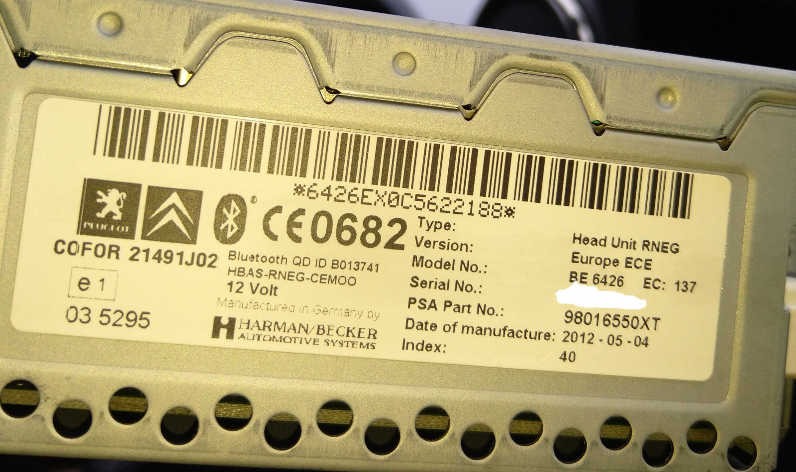

thats a miss understanding. I have a RNEG (Berlingo II 2012) unit not a RNEG2!
I actually just release the unit from the slot and wonder why there is no wire for the gray FAKRA connector. So if someone does have some information for what these connectors are, would help me determine if my unit misses something.
As you can see the gray connector is not connected
So any information on the purpose?

Ok so as you were asking a question about RNEG2 that's why, and yes if you replace the MyWay (RNEG) with RT6 / eMyWay / RNEG2, then you will have to replace the screen for a High Definition version that is compatible, plus it will need VIN coding and possibly some other configuration for your vehicle. Also the Diversity function won't work on the RT6 as you don't have an FM2 aerial.
As for the grey FAKRA at the top corner, ignore it you don't have FM2 and it is not used.
Blue is for GPS
The FAKRA under the blank Grey Fakra is for FM1 / AM
Blue is for GPS
