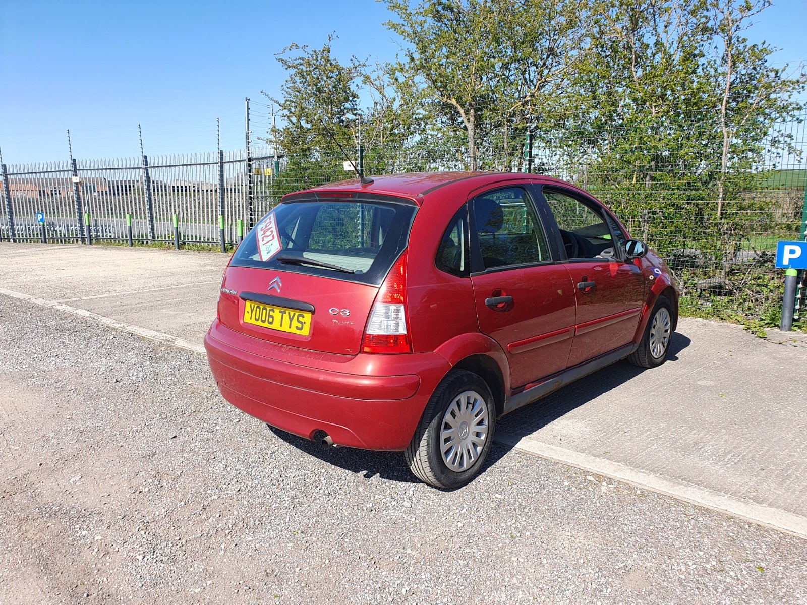

I purchased a high mileage hero at auction earlier today, a 2006 C3 1.4 HDi.
Despite it having over 160k on it, it drove a lot nicer than the newer Vauxhall with a third of that mileage than I drove TO the auction house to flog. Engine and box are lovely, decent service history and so on.
The only issue I came across was the lack of central locking, which appears to be a bit of a common issue but with varying symptoms.
Specifically, all the doors and tailgate appear to be permanently unlocked, with the exception of the drivers door which can be locked with the blade. Learned the trick to locking the other doors in an emergency via the black cap in the doors themselves which I'll do next time, nothing in the car worth nicking as it stands.
Is this almost certainly a BSI issue? Somehow I'm not convinced a reset is going to solve it, and I've not had chance to get Diagbox on it yet. Is a new (or used) BSI readily available to programme easily via Diagbox or is it not that easy?
Also skimmed over a thread on another forum about separating the BSI and replacing either a faulty relay or just replacing the top half of it entirely, but that sounds like a recipe for disaster if just one thing was to break and could be an expensive mistake.
Any advice welcome! TIA.
