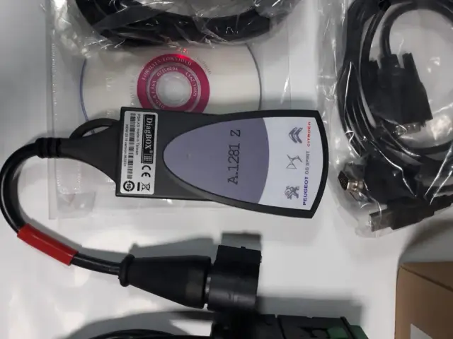

Hello, i have a Citroen C4 Picasso 2010, 1.6 THP 150 hp, automatic. I like to know all about my car as i am a some-how techy guy. Can you please help me choose the right firmware, version, device name, etc for my car? I saw a couple of Lexia devices in my market BUT what to choose. They market the device as 2023 updated, updated chips, but i really don't know if they sell the actual thing or not or is the device suited for my car?
Lexia 3 V47, PP2000 V24, diagbox 7.65 also CAN- BUS and SAE J1850 bus - is is the best option for my C4 Picasso 2010?

There are already a lot of posts about this in the forum.
For your car - 2010 - the DIAGBOX software is needed.
The included LEXIA/PLANET software for Citroen/Peugeot up to approx. 2007/2008 is only needed if you want to help someone with an older vehicle.
Very good and stable is the software 7.57 or 7.62 - sufficient for vehicles up to 2015 - this should be installed on a 32-bit laptop - WIN 7 32 Bit or XP prof. Sp3 32 Bit. If it is installed on a WIN 7 64 bit then the software will not work for the older vehicles up to 2007 because these are 16 bit versions - the DIAGBOX will work.
Of course you can also install a newer software 9.xx - this should preferably be installed on WIN 10 64 bit. There are VM versions (laptop must be virtualisable) but also versions with direct activation.
A good VCI is important - all VCI clones are "Made in the Far East" - but there are big differences. You should follow the recommendation of the forum.

Decent quality (VCI + software) is available at
https://www.easydiagnostics.co.uk/
Forum members also get a discount there
The Danes buy their VCIs from "lifafadenmark" and are very satisfied - if they are faulty, they can exchange them - you can find them on ebay.
eBay-Artikelnr.:113250102482
with shipping approx. 110 €
It has to be a full chip VCI - there are many suppliers and unfortunately also many VCI which do not work well. The VCI should be able to work not only with the software 7.xx but also with the current software 9.xx.
Which software version you install depends on the laptop and the operating system you have available.
For your Citroen, 7.57 is sufficient - a laptop with a dual processor and 2-3 GB RAM is sufficient - higher software requires a higher quality laptop with i5/i7 processor - and sometimes more is less.

If you can get one from Easy Diagnostics they provide a very good aftercare service, and are highly knowledgeable. Yes, their equipment is not that cheap, but the quality pays for itself. I have had an earlier version for a long time now, and it has never let me down.
