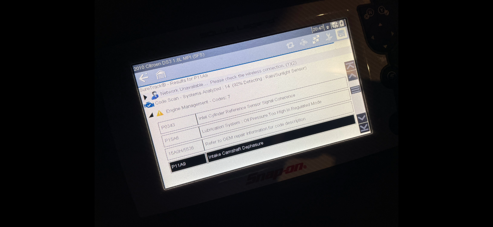

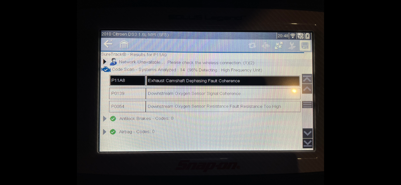

Wondering if anyone is able to give me any insight what might be causing these codes?
The car has had a lot of work done at the garage since I bought it 8 months ago it’s becoming a nightmare. It’s had a new clutch and second hand gearbox fitted, new timing chain, oil change/filter change, new camshaft sensors - that’s just the work to the engine 😅
No closer to having the codes gone.
More recently a big problem has been when I’m in motion driving and shifting through gears, if I press down the clutch for more than a few seconds the rev counter will drop to zero and the engine will stall, oddly enough it’s not a problem if the car is stationary?? It will sit there and idle, occasionally a bit rough but it won’t drop even if I select any gears and hold the clutch on the bite and drop it back do n there’s no issue, it’s only an issue when I’m actually travelling at speed?
No clue what the 15A0H/5536 code refers to?
I’ll leave a couple photos of the codes below, any advice would be greatly appreciated! 😁

So here are the fault codes as they relate to you specific vehicle. Focus on these first of all.
Fault Code: P0343
Description of Fault: Inlet cylinder reference sensor signal fault: Coherence. Detection of a loss of signal from the inlet camshaft (Signal stuck in high status).
Conditions of activation of the diagnostics
The following conditions have to be met:
- Engine management ECU in main triggering phase
- engine running
Conditions for Fault to clear: Acquisition of the signal in conformity
Downgrade Modes whilst Fault is active:
  • Adaptation of the oxygen sensor regulation stopped.
  • Change to butterfly mode.
  • Deactivation of checking of the canister purge.
  • In the event of a double fault on the inlet camshaft and the exhaust camshaft, injection is deactivated on restarting.
  • Prohibition of dephasing of the inlet camshaft.
Symptoms:
  • Lack of power.
  • Restarting impossible if there is a double signal fault on the inlet camshaft and the exhaust camshaft.
Suspect Areas:
  • Inlet camshaft position sensor.
  • Electrical harness.
Fault Code: P15A6
Description of Fault: Pressure regulation fault ( oil): Pressure too high in relation to the reference value.
Oil pressure too high in piloted automatic mode.
- Engine running
-Battery voltage correct
-Oil temperature correct
Conditions for Fault to clear: Confirmation of return to automatic mode on the piloted oil pump.
  • Change to "mechanical mode" on the piloted oil pump
Symptoms:
  • Excessive fuel consumption
Suspect Areas:
  • Oil pressure sensor
  • Oil pump regulation electrovalve
  • Engine ECU
Note that the following code for P15A0 is what I have without the 'H' and there is nothing for '5536', so be aware.

Fault Code: P11A9
Description of Fault: Fault in the inlet camshaft dephasing: Not characterised. Diagnosis of the adaptation of the position of the exhaust camshaft dephaser.
Difference between the theoretical (calibrated) position of the exhaust camshaft dephaser at idle and that measured, above 17°.
- Adaptation of the inlet camshaft dephaser completed
- Inlet camshaft dephaser temperature between 0 and 130 °C
  • Adaptation of the exhaust camshaft dephaser completed (At the next start-up)
  • Uncrossed position of the exhaust camshaft (idle position)
  • Mixture adaptation from the prohibited basis
Symptoms:
  • Stalling
  • Idle unstable
  • Lack of power
  • Emissions outside the norms
Suspect Areas:
  • Engine ECU
  • Intake camshaft dephaser
Fault Code: P11A8
Description of Fault: Fault in the exhaust camshaft dephasing: Coherence.
-Adaptation of the exhaust camshaft dephaser completed
-Temperature of the exhaust camshaft dephaser between 0°C and 130°C
  • The fault disappears if the adaptation of the exhaust camshaft dephaser is completed successfully (on next starting)
Symptoms:
  • Unstable idling
  • Engine hesitation
  • Stalling at idle
Suspect Areas:
  • An exhaust camshaft dephaser
  • Engine ECU
  • Exhaust camshaft position sensor
Fault Code: P0139
Description of Fault: Downstrean oxygen sensor signal fault: Coherence.
In injection cut-off, the engine ECU checks that the information from the downstream oxygen sensor is "richness low" (Voltage higher than 0,15 V for more than 0,20 seconds).
Conditions of activation of the diagnostics:
  • Main wake-up
  • Battery voltage more than 11 V
  • Downstream oxygen sensor heated up and available
  • Engine running
  • Injection failure (For at least 7s)
  • The value measured is less than the maximum threshold.
  • Voltage lower than 0,15 V for more than 0,20 seconds.
  • In injection cut-off, the value measured is less than the reference (For a duration of 10s).
  • Oxygen sensor values not available.
  • Deactivation of the regulation of lambda change into open loop,
  • No purging of the catalytic converter.
Symptoms:
Suspect Areas:
Fault Code: P0054
Description of Fault: Downstream oxygen sensor resistor fault.
Resistance internal to the downstream sensor is too great (For at least 6s).
- Temperature of the gases at the downstream sensor between 200 and 720°C
- Inlet air temperature higher than -6,8°C
- The battery voltage is between 10,7 V and 16 V
- Engine running
- No cutting of injection
  • Resistance internal to the downstream oxygen sensor less than the maximum threshold (For at least 20s)
  • Transition to open loop of the downstream regulation
  • Deactivation of purging of the catalytic converter
Symptoms:
Suspect Areas:
