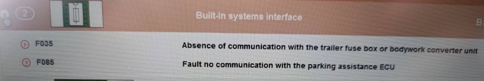

Got my Diagbox working and did a scan. Got some weird errors that I can not figure out. The BSI seems to be changed at some point.
Peugeot 308 2011. VIN VF3**************[VIN obfuscated, can be read by forum staff]

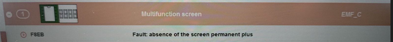

The display is working as it should, but gives this error message.

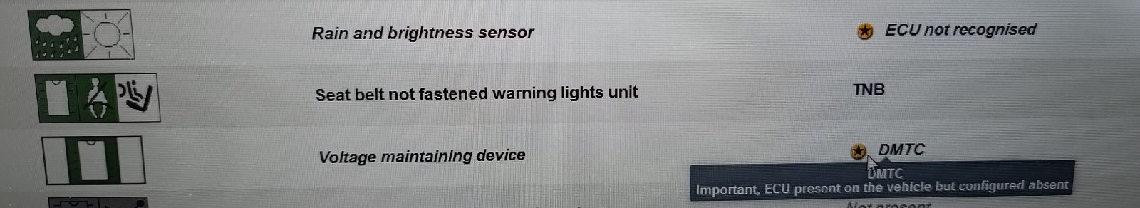

Rain sensor works as intended. Don' t know about the voltage maintaining device. Tried to find it in ECUS Present in the BSI settings but am not sure which it is.
As far as i know there is no trailer fuse box in the vehicle, and it is disabled in ECUS Present.
Same as trailer fuse box. Also says that the parking assistance is faulty in multifunction display when putting gearbox in reverse.
Any good suggestions on what to test or what the issue is?

Could leave most alone except the one issue where the car think it has parking sensors but it there is none. So when putting car in reverse it says parking assistance faulty. That would be nice to get rid of.
