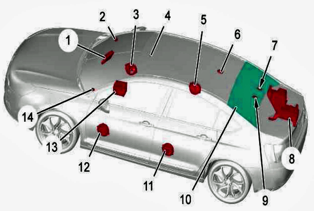

So now we know this vehicle was never fitted with the NG4, as I said above, you are missing the specific aerial amplifier wiring and units required for the NG4.
These are the official components of the NG4 for the Saloon. Note it does not show the optional services module (telematic unit), which were also fitted with the NG4 on may vehicles which have the SIM card and different wiring to the head unit.
(1) Audio amplifier (not fitted in your vehicle).
(2) Right-hand front tweeter.
(3) Front right hand speaker.
(4) Microphone.
(5) Right hand rear speaker.
(6) GPS aerial. (not fitted in your vehicle - but you will have a different aerial)
(7) Aerial amplifier GSM/FM2 (possible not fitted in your vehicle).
(8) Bass box (not fitted in your vehicle).
(9) Aerial amplifier AM/FM1 (possibly not fitted in your vehicle or you may have a different module)
(10) Antenna screenprinted into the rear screen.
(11) Rear left loudspeaker.
(12) Front left hand speaker.
(13) NG4 radio telematics.
(14) Left-hand front tweeter.
There are 2 amplifiers for the aerial on a vehicle with factory fitted NG4, (7) & (9). The RD45 only has one, so I can't tell which if any of these specific 2 you have or it may be a different aerial amplifier fitted as your vehicle is designated for South America.
This is one of the issues you will face with any retrofit, as the NG4 has many other components for example the services module, that you also do not have, along with SIM card that is used by it for GSM operation / emergency services.
So without ripping your car apart to fit amplifier modules and wiring, I think you will have to live with it.

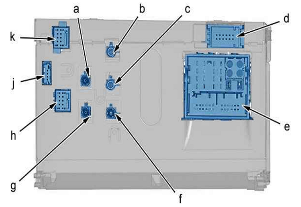

Well it means basically you are likely missing one or more amplifiers for the aerials used by the NG4.
Here is the rear of the unit:
These are the connections:
"a" Aerial FM2.
"b" Aerial TV2 (for Japan).
"c" Aerial TV1 (for Japan).
"d" MQS cable connector.
"e" 3-part connector.
"f" GPS aerial .
"g" Aerial FM1/AM.
"h" LVDS 2 cable connector.
"j" USB socket connector.
"k" LVDS 1 cable connector.
The NG4 has a dual FM tuner and uses aerial socket "a" for the FM2 and "g" for the other FM and also the AM reception.
Now as far as I can see the aerial with a grey connector at the back of the NG4 should be the FM2.
The tuner system is equipped with 3 tuners and 2 antennas. This provision allows tuners 1 and 2 to perform the 'diversity' function which means it can constantly scan ahead and find a better frequency and switch to it when using FM.
Now some units may only have a single FM fitted so does not have this function. So have a look at the back of the unit and see if you have an aerial in the grey connection. See if it improves the signal, or you may need to retune the radio manually if you are travelling a lot, because you won't have the 'Diversity' function that requires the second antenna and the additional aerial amplifier at the back of the vehicle under the rear parcel shelf.

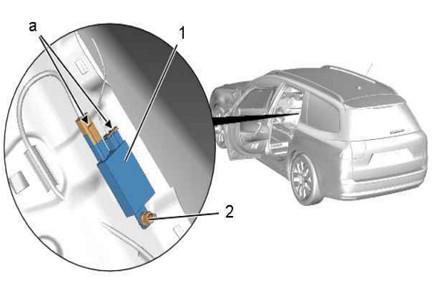

Ok so you have the NG4 Telematics system. The main aerial harness through to the rear contains the GSM & GPS aerial wires that go to the roof aerial receiver. The AM & FM1 and FM2 aerials are routes through to the impedance adaptors and on to the screen printed aerial. The adaptors are concealed behind the quarter panel trims:
