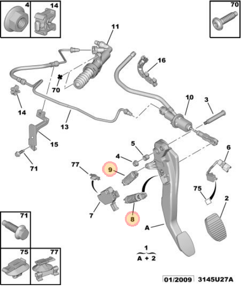

I had this (RHD) and the spring was replaced as it never went away even when greased. I've had a look and can't find a specific technical issue on a Left Hand Drive, but the LHD does have a clutch assistance spring as detailed below with details of how to remove and replace:
Looking at parts for your specific X7, there appears to be two of them... (8) & (9)
I hope you're sitting down for the prices of these springs....
(8) Declutching Assistance Spring, Part: 2148H8, £82.22
(9) Declutching Assistance Spring, Part: 2148H9, £84.92
For these prices, you'd expect a spring that doesn't squeak!

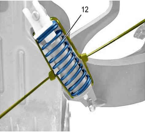

This is referring to removal and refitting:
Removal
N.B.: Mark the direction of fitting of the clutch servo spring (12). Mark them (if necessary).
Lubricate the retention pins of the clutch assistance spring (12) with silicone-free grease (Pedal side and pedal bracket side).
Refitting the clutch assistance spring (12) (According to the marks made at removal).
Removal
- Pass a cable tie between the legs of the coils of the clutch assistance spring (12).
- Press the clutch pedal down half way.
- Tighten the cable tie.
- Remove the clutch assistance spring (12).
- Cut the cable tie.
- Check the position and retention of the clutch assistance spring (12) on the pedal bracket.
- Press the clutch pedal several times.
