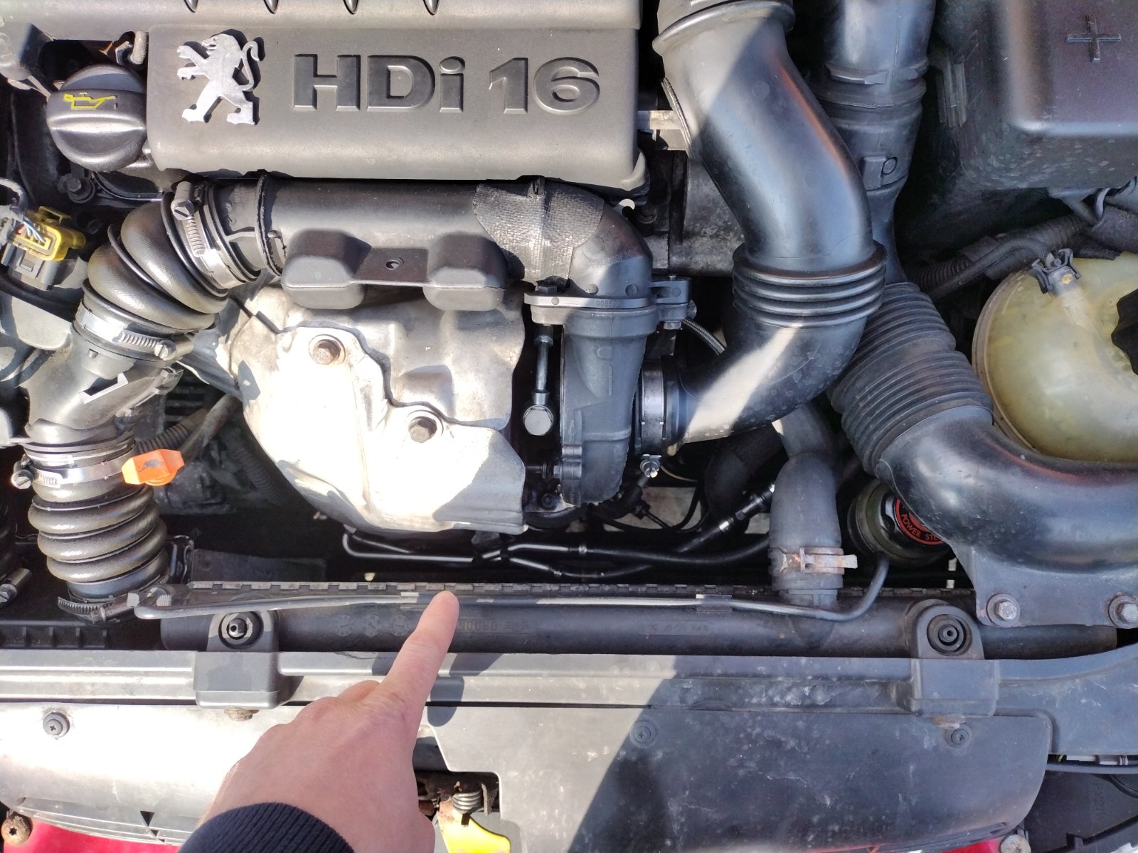

DPF / no DPF = I'll take a picture in the daylight, basically pop the bonnet and look down front heat shield, there's a couple of small stainless steel pipes, can see one from above. If they are present you have a DPF. No pipes, no DPF. Easy on 1.6

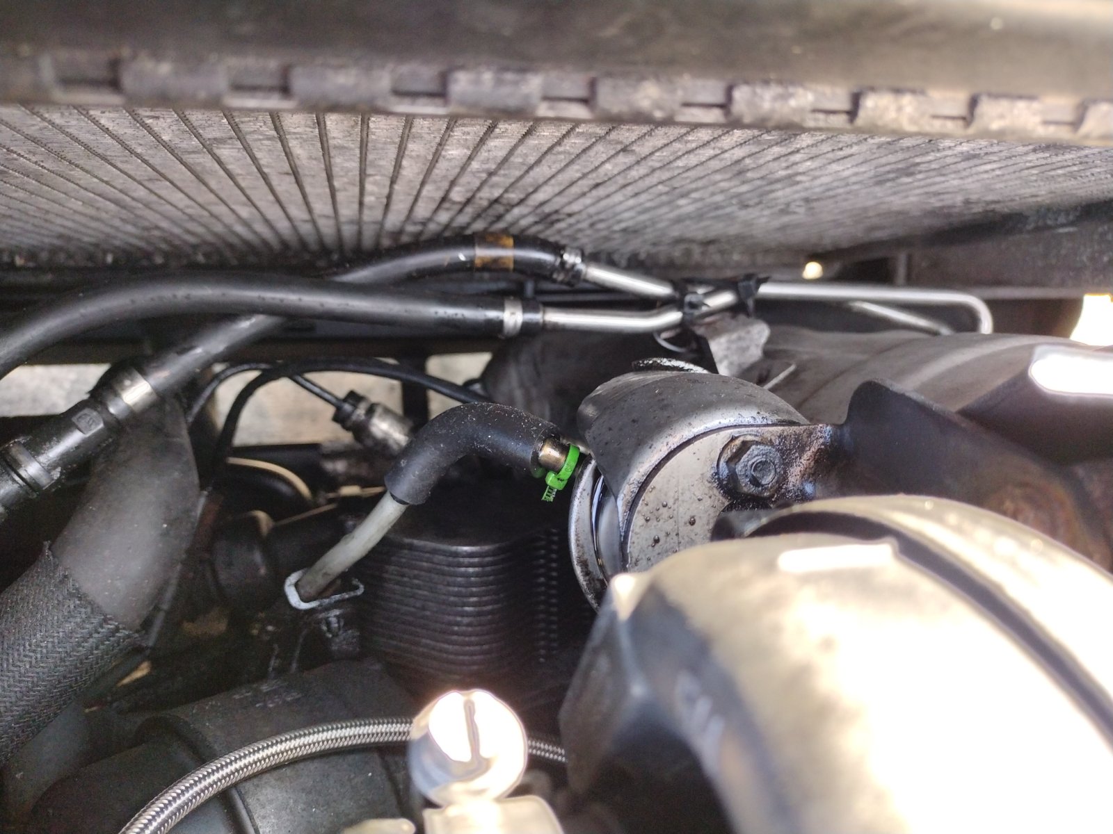

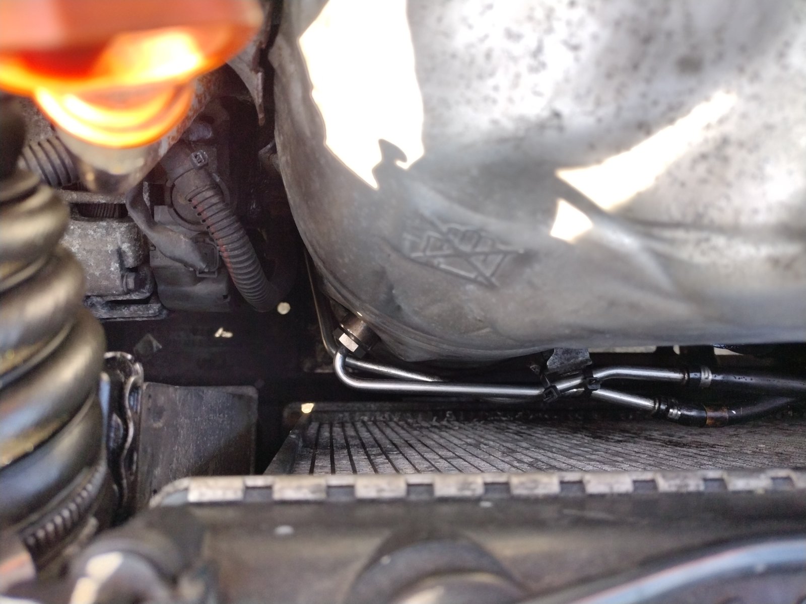

I've also had a look at the heat shields, and there are no metal pipes coming directly from it. There are two parallel, but after watching a few videos, I don't think they are from a DPF.

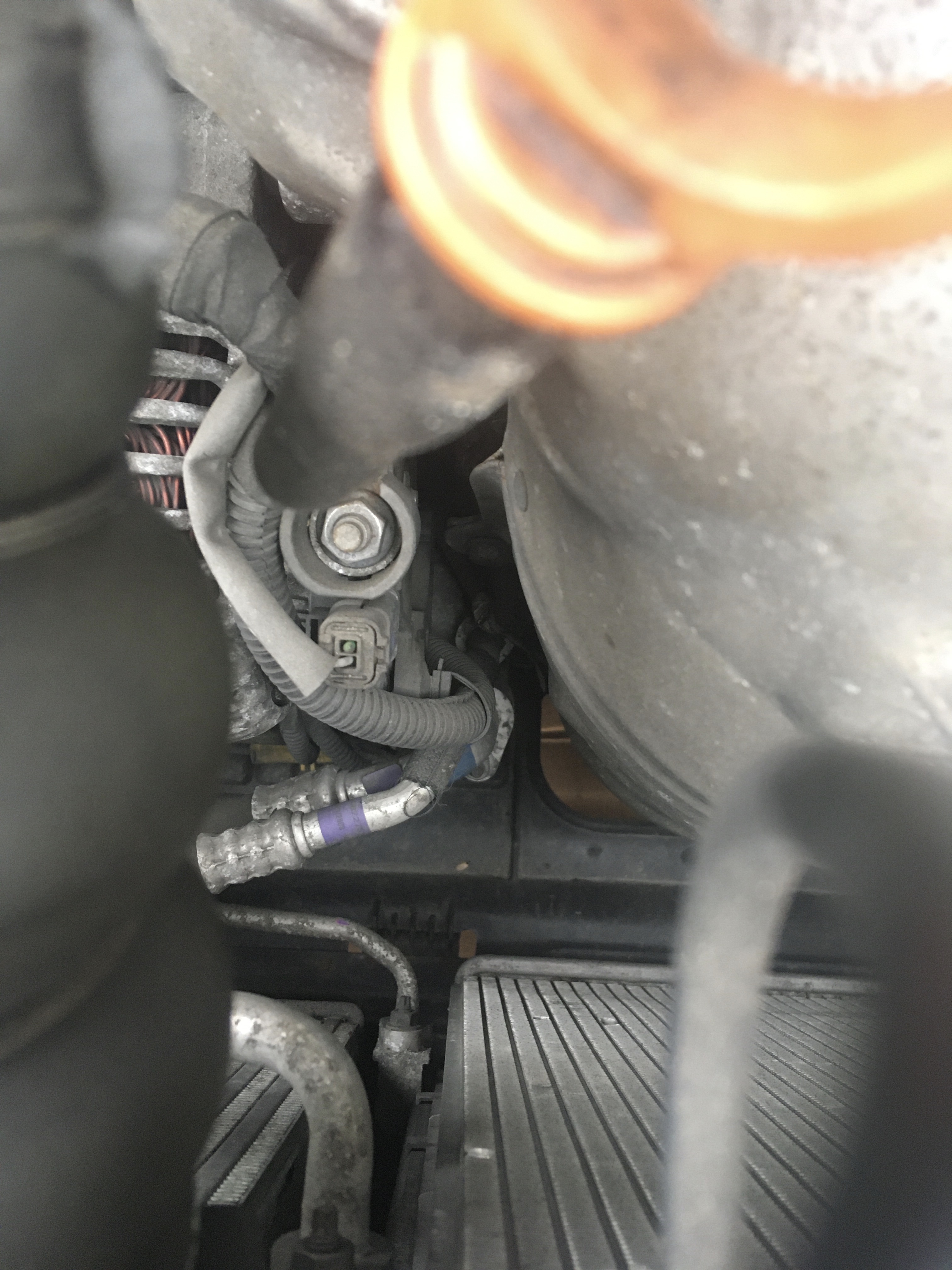

I've confirmed that there is some type of oil leak. It literally seems to be one drop every 6 hours, or a drop after driving. I can't jack the car up because of my gravel driveway, but managed to get a torch on the sump pan, and it looks messy with old oil.

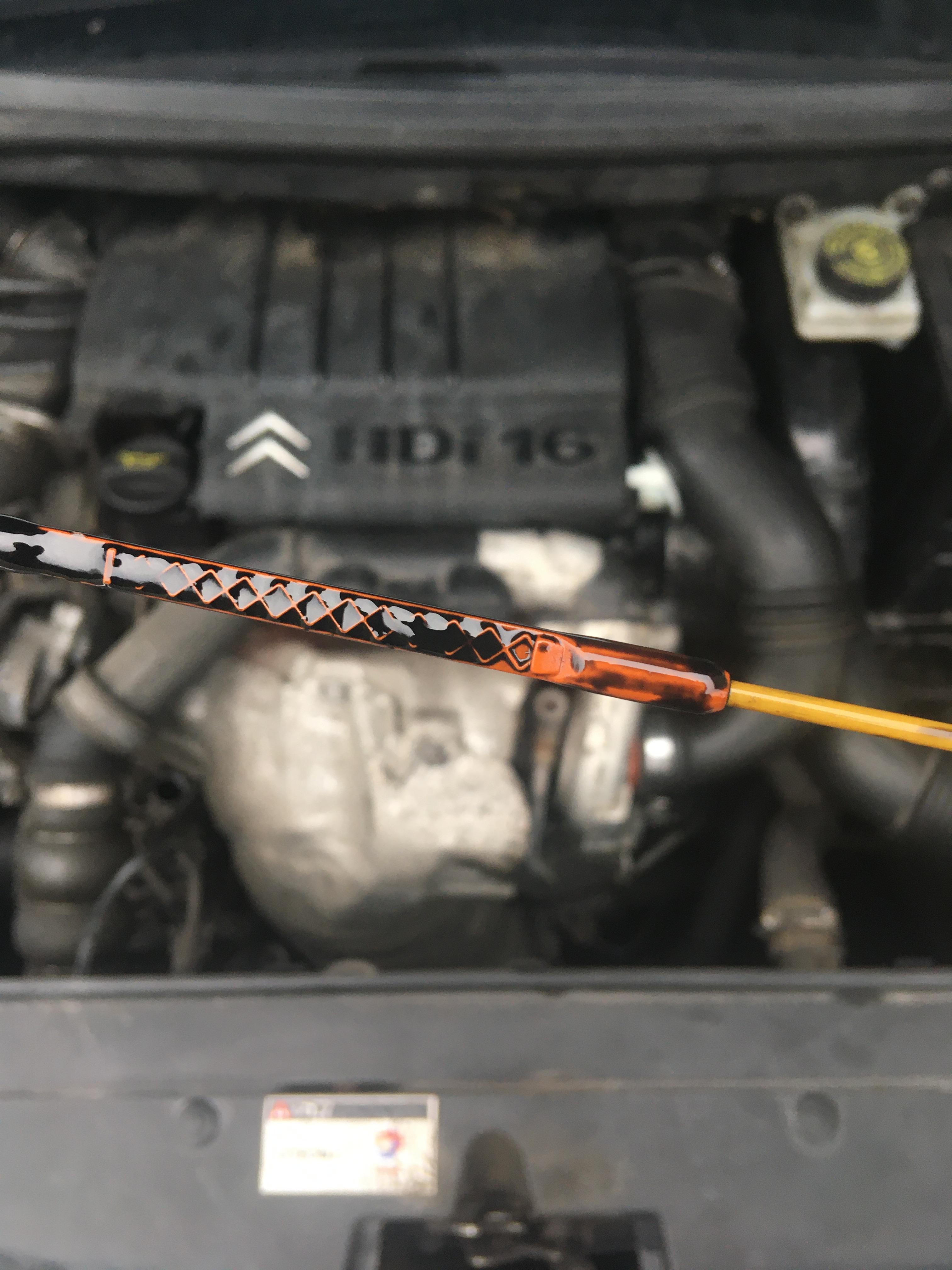

Nothing attached to the heat shields but a couple of pipes alongside, but don't think it's DPF.
What do you make of the dipstick reading, does this look overfilled, or is it just on the limit and the round section above is picking oil up because it rubs along the pipe? I'm also guessing that oil change in a diesel turns this black pretty soon after?

Give it a wipe, in + out again should normally be bit clearer to see. I think it's bang on the max line, all ok.
Yes diesel oil remains clear and golden, as new for about 30 seconds when engine started, after which point it's black opaque again! 1.6 HDi has quite a quantity retained of old oil in the sump - see here as why:
viewtopic.php?p=750661#p750661
Which doesn't help the effect. Also quite a small sump, so less new oil to dilute the old black filth each time.
Or short version - it's fine don't worry.
Agree, based on your pictures think no DPF fitted on yours.
