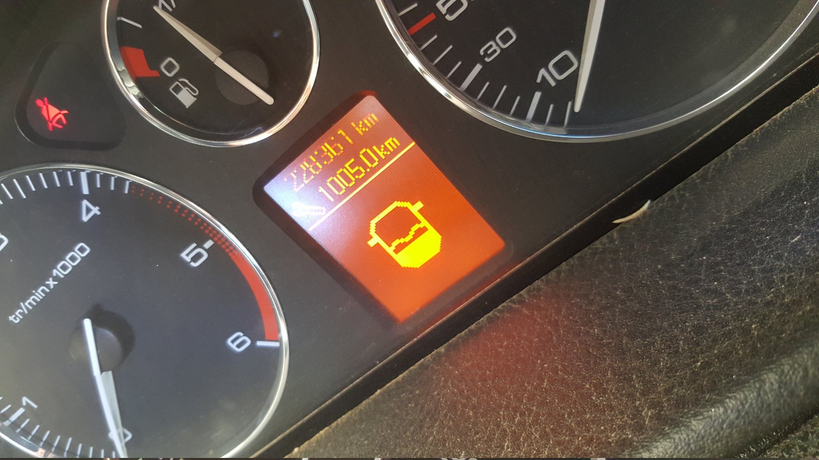

So i wen and ordered a obd2 scan tool konnway kw850. gives the following codes P0183,P1351 and P1598. So i cleared the codes and they never came back even after 3 days of working on the car. There is no fault codes on injectors even if they are not receiving any power so i guess the car knows it but some other issue is letting the car not sending power to the injecters. hence the no fault codes on injectors. it also shows a warning light on the LCD screen i will attach a picture.
What faults will cause the ECM not giving power to the injector? since im not getting any codes after erasing.

Please provide your VIN (please post your VIN in full without spaces - it will be automatically masked from public view after submitting your post & will only be visible to staff), so I can relate the codes to your engine ECU.
It's possible you have gotten water into the engine ECU or other electronics - it's a bad idea to wash the engine bay area with water - it's asking for trouble. You should only wipe off dust and dirt with a cloth and suitable cleaner, but never use running water as it'll run down onto cables and find its way into the plugs / connectors / or worse the sensors / ECUs.

Re: 2008 407 2.0 HDI no power to injectors
Here's what I have on those codes:
P1598: Cooling circuit by-pass electrovalve (No further info)
This one is common and you can generally ignore it as the glow plugs are only really used in very extreme cold and to assist with regeneration when required by the engine ECU:
| Fault Code: | P0183 |
| Description of Fault: | Diesel fuel temperature signal : Short circuit to positive or open circuit. The voltage of the signal of pressure in the fuel high pressure common injection rail is higher than 4,92 V for 3 s. |
| Conditions for Fault to clear: | Use of fuel temperature replacement value: 90 °C. |
| Downgrade Modes whilst Fault is active: | - |
| Symptoms: |
| Suspect Areas: |
| Fault Code: | P1351 |
| Description of Fault: | Pre-heating relay circuit: Coherence; Relay supplied and glow plugs not supplied. The information from the preheating control unit indicates that the relay is open even though the ECU commands the closing of the relay for 5 seconds. |
| Conditions for Fault to clear: | Ignition on |
| Symptoms: |
| Suspect Areas: |
Regarding the clicking noise from the starter, does it only do this with a warm engine?
Ignore the P1351, unless you live in Siberia, it's very common and many of us have it. It won't hinder starting unless your in -10 and below temps.
