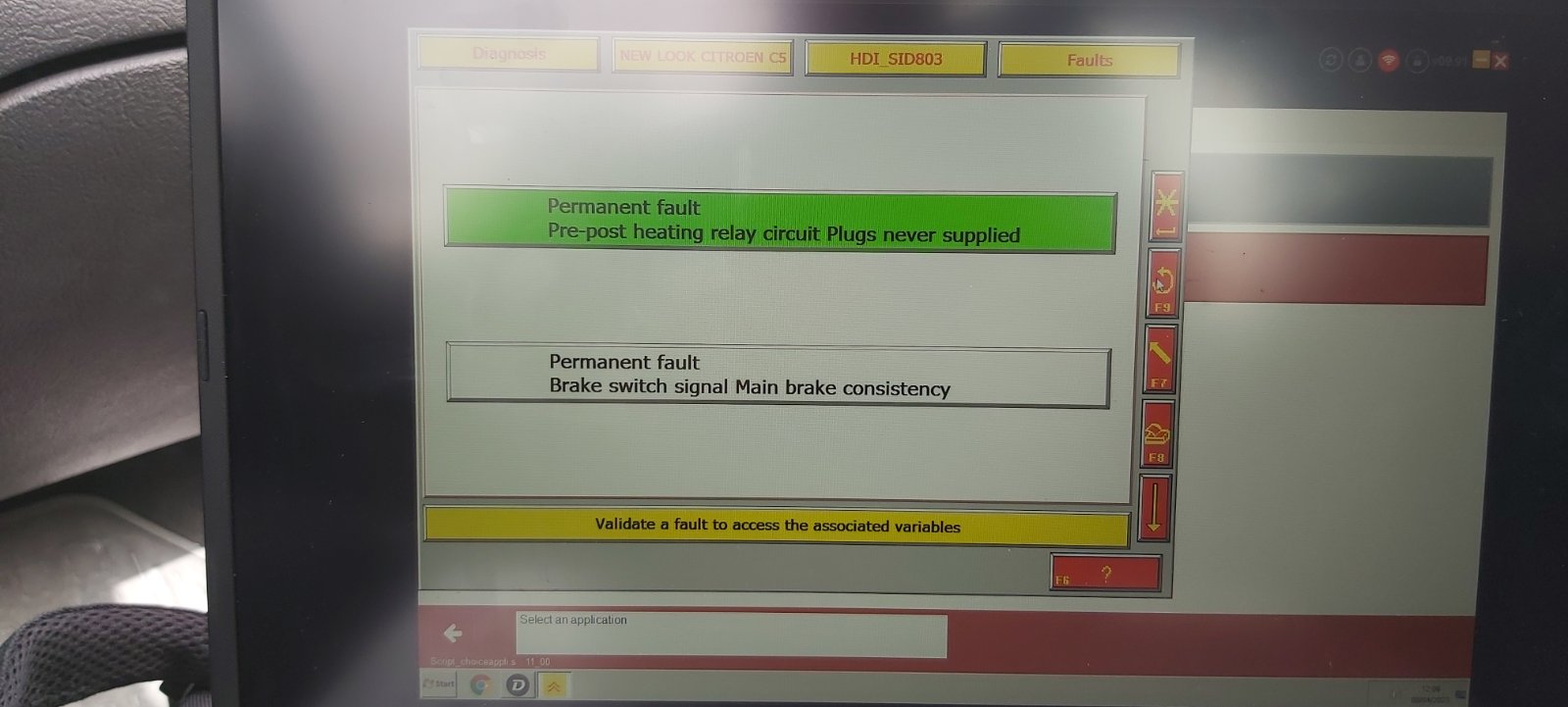

After connecting the laptop i observed the following:
- Permanent fault in cdchanger power supply or something, dont care.

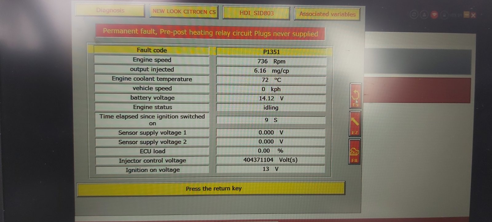

- Permanent fault: "pre-post heating relay circuit plugs never supplied" (the car starts normally and right away, what does this mean?)

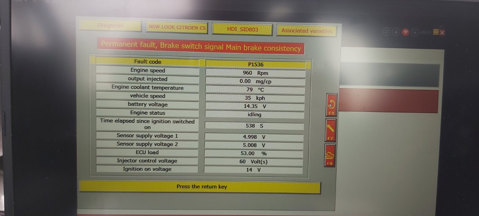

- Permanent fault: "Brake switch signal Main brake consistency"

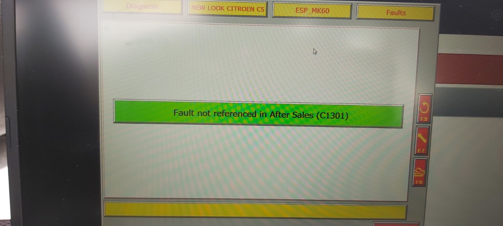

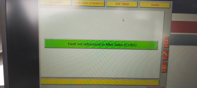

Regarding the C1301, the internet says it's either the brake pedal inconsistent signal, or the pressure reading, very common with the ATE MK60 unit.
I did the dynamic readings and the pressure reading was consistent during this time, drove a bit, and pressed the brake pedal when stopped the values were stable.

The fault would seem to be with the brake switch - if there is an issue it will disable cruise control. The system will not re-engage until the vehicle ignition is switched off and then on again, as it self-checks. Of course the brake switch is essential to the cruise control system working. It won't affect the limiter though, which is why that continued to work - as this only relies on the accelerator position sensor.
You can ignore the glow plug error - that's a common one, and likely means either the glow plug relay or the plugs are toast. They're not really needed for starting unless in extreme cold - but they do assist with regeneration of the particle filter when required.
