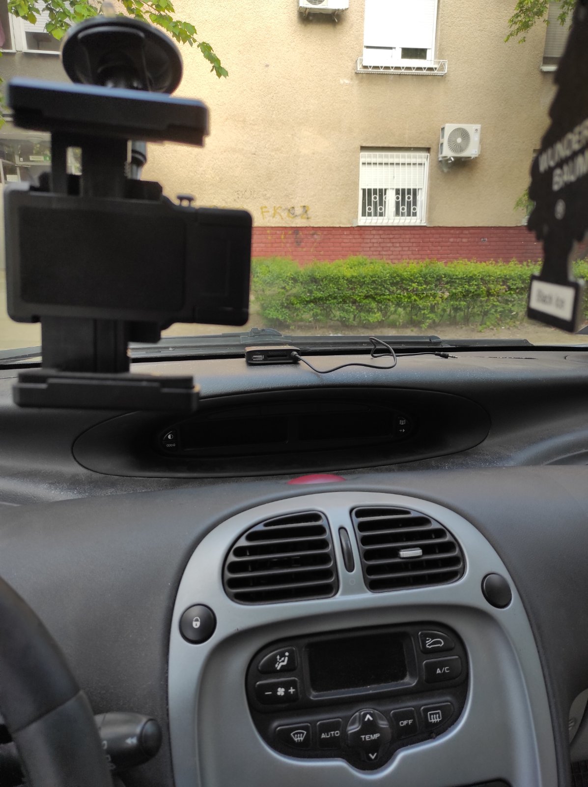

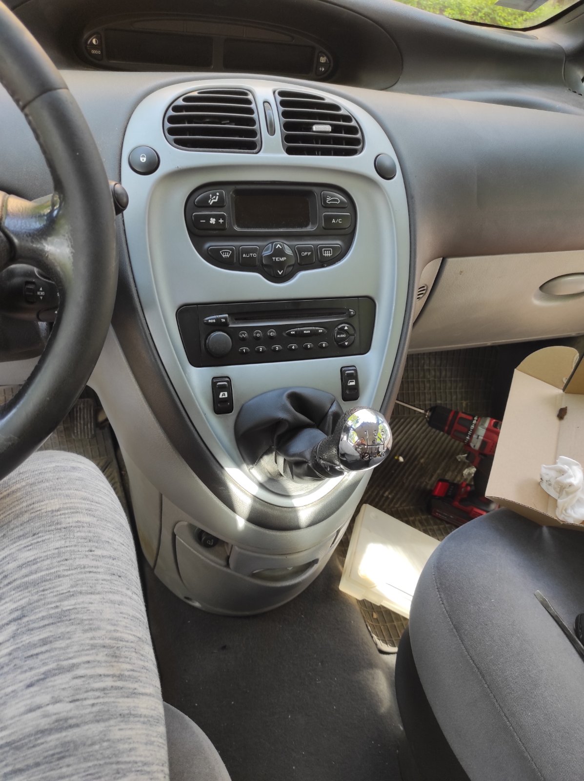

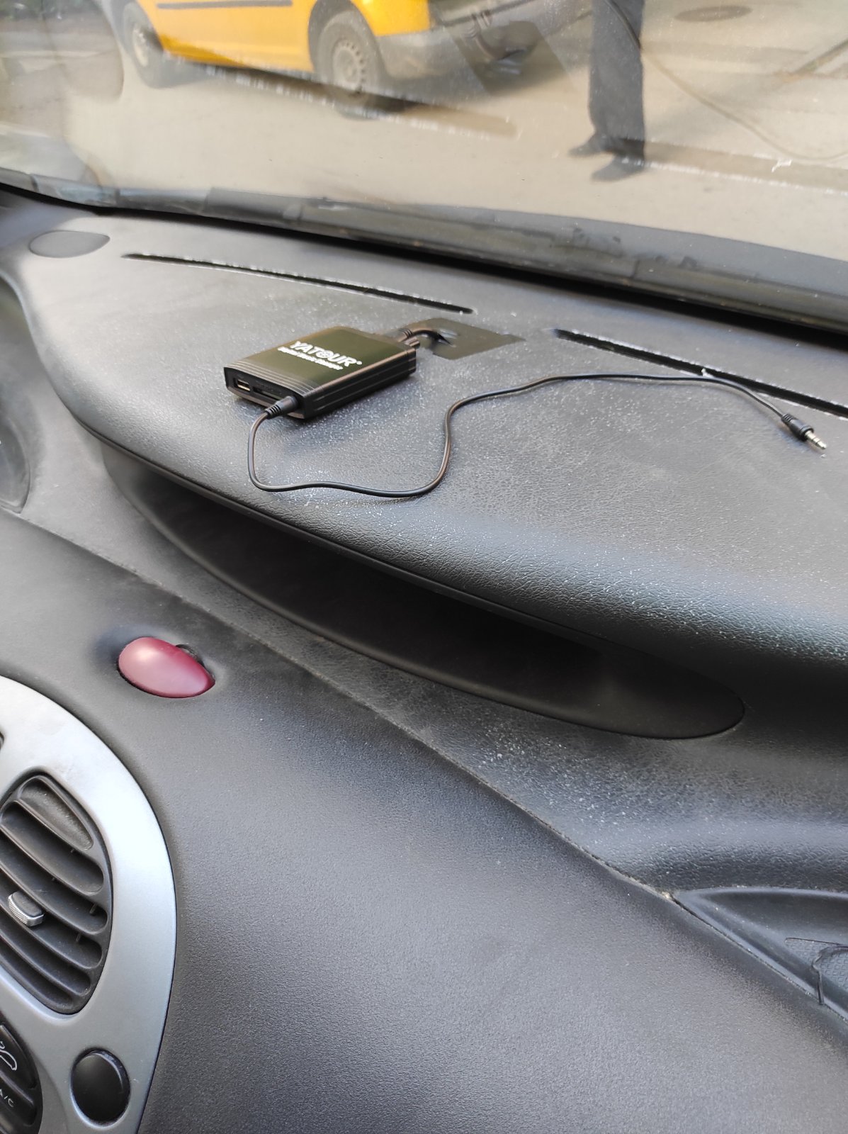

The order arrived few days ago and I installed the device today. It works as GiveMeABreak told me, and so far I'm very satisfied.
Since, my car didn't have factory cd changer, I had to enable it using Lexia in BSI dialog and audio dialog, but that was not the problem.
The real problem was finding suitable place for it, since I don't think any of the Xsara Picasso models had it. I decided to place it on top of dashboard. After deciding where it's going to stand, the biggest challenge was fishing it's cable through the inside of the central console. After disassembling most part of the central console, some drilling, cutting using soldering iron during about one afternoon, the work was done.
