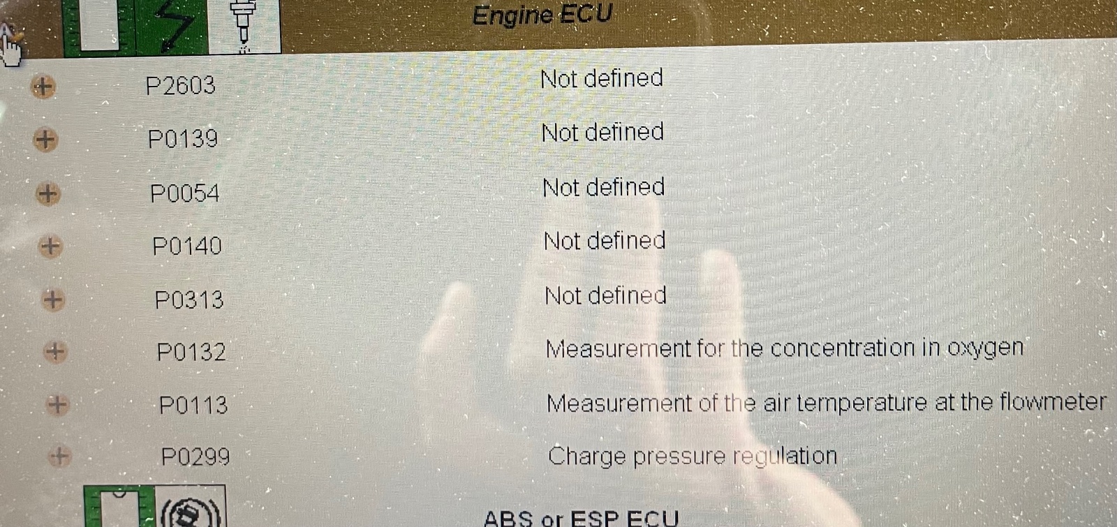

So my punt on the eBay one worked out ok. Works great.
I’ve attached a screenshot of the fault codes it found.
Further to my original issue my turbo as stopped spooling up. My local garage have checked all the vacuum lines and couldn’t find a boost leak. I thought my other issue may have finally put it into limp mode but that charge pressure code suggests it may be something else.
The Oxygen code I’m guessing could be a faulty lambda sensor. Though I am running a decat with a spacer on the bottom sensor. It has been working fine but it could be that it’s not doing its job anymore too.
Any advice would be gratefully received.

Re: Citroen DS3 Service light
I've asked above for the VIN (please post your VIN in full without spaces - it will be automatically masked from public view after submitting your post & will only be visible to staff), as I can't help relate the codes to the specific engine ECU without it.
