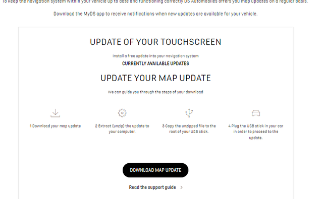

Hi folks,
I have tried the DS updater program and entered my VIN to be told to use the website. Using the website I was only given a map update. The DS app on iPhone offers no updates. Is there another way to get a update file for my DS3, is so how do I prevent the internet seeing my VIN?

I know I’ve to use a usb drive, used the DS website but was only given the option to update my maps. No update for the unit/ touchscreen itself. When connecting the usb drive it did not automatically start, I had to go into the map settings and choose which map updates I wanted.

DS website only offering map update.

Re: DS3 Smeg touchscreen update
The reason is likely that they are only offering a map date as some vehicles didn't have CarPlay / Mirror Link / Android Auto enabled - it was a cost option at the time. Some of these updates on this unit need a calibration file applied and if you try to update it with a later firmware it can result in your vehicle options going missing - which means you end up back at the dealer.
Unlike the latest Connected NAV systems, the older telematics units don't always have the firmware supplied via update notifications or via the app. You only get the map update.
