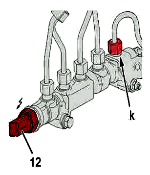

The clue there is in that last bit of new info - Rail pressure! That will be referring to the fuel rail pressure sensor. The engine management ECU checks the pressure of the diesel fuel in the fuel high pressure common injection rail in a closed loop via the fuel pressure sensor. If this is faulty then it can of course affect the info being sent to the engine ECU which will affect the other components in the fuel system.
Is your mechanic using Diagbox to diagnose the vehicle? If not he may be missing faults that his scanner won't pick up. For fuel rail issues the following are possible faults. All these can cause jerking / stalling or lack of power. So may be worth ensuring you get a diagnostic done with Diagbox so you are not missing key faults. Replacing parts is not going to help if the root cause is not correctly identified.
This is the high pressure common rail
(12) is the high pressure fuel sensor
'K' is the high pressure fuel supply.
These are some fault codes that may be stored concerning the fuel pressure:
P0087: High pressure fuel regulation - The measured rail pressure is too low in relation to the set point
P0088: High pressure fuel regulation - The measured rail pressure is too high in relation to the set point
P0192: Fuel pressure signal - Short circuit to earth
P0193: Fuel pressure signal - Open circuit or short circuit to the plus
