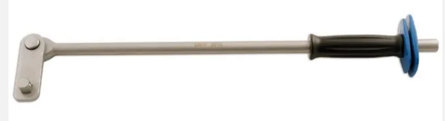

The impact power bar:
https://www.lasertools.co.uk/Product/76 ... rive-330mm
Sealey impact power bar
As far as I can make out, there's no cleverness/ mechanism in the black lump, you just lever with the handle and belt the black lump with a big hammer.
Has advantage of separation of the applied torque from the impact forces, so should be limited risk of shearing a bolt with it.

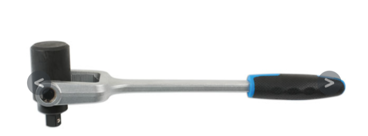

This is another oddball I'd not previously heard of, found on Google after described on here (can't find the thread in question again now)
The "hand impact wrench"
Hand impact wrench
Hand impact wrench
https://www.ebay.co.uk/itm/175064640545
Seems a good gizmo, but can't help wonder if is putting side forces on socket/bolt??

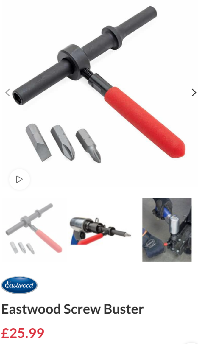

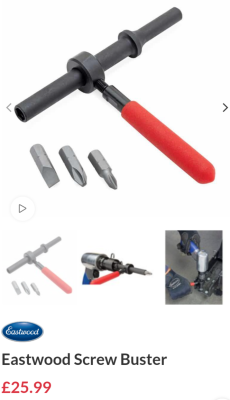

Last one for tonight, and not "conventional hammer driven"
A similar idea to the impact power bar above, this is an air hammer attachment allowing hand applied torque to be used in conjunction with pounding the living snot out of it with an air hammer:
Screw buster
Screw buster
https://www.frost.co.uk/eastwood-screw-buster/
Rather unfortunate name, I think I would rather them loosened than "busted" which to my mind is more at the sheared off or otherwise broken end of the spectrum! :-D

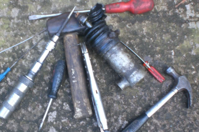

Always like to support a new thread on the OTCL Matt, like I said in my POTD post today
NewcastleFalcon wrote: 25 Mar 2023, 19:20
Q. Does the FCF have a Thread for... :?:
A. Of course it does, and if it doesn't start one :!:
This is the arsenal I assembled to attempt, eventually successful after a major struggle, to get a silly pin out from the bottom of a Xantia Rear strut. All sorts of ground down centre punches.

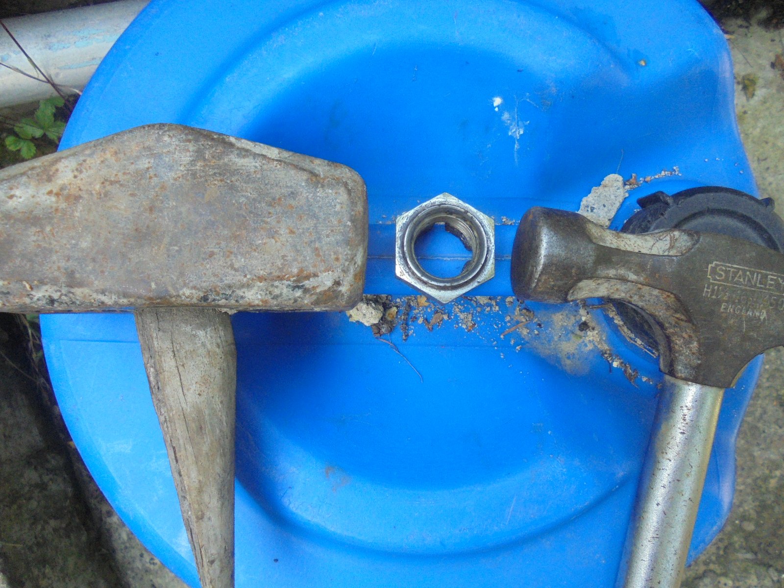

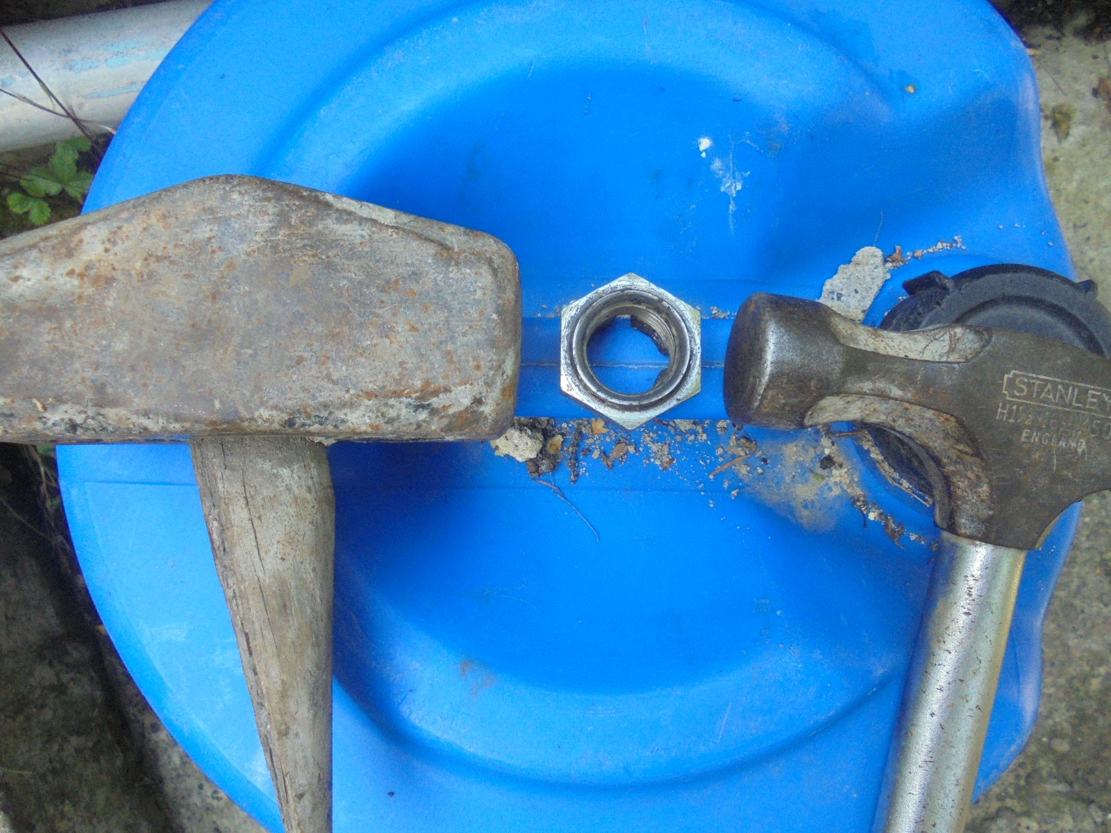

I took a trick of the trade from Les, agricultural machinery fixer extraordinaire, and applied it with refreshing success to free-off a tie rod end locknut, which other tools in the tool box were defeated by. Best to do it before the hex is rounded off with futile attempts with spanners of any shape or form.
Requires two hammers and a "knack" in the force and precision of the blows...here they are. The releasing effect is achieved by temporary distortion of the nut one way on one pair of flats, followed by a different distortion on the next pair of flats and so on.
Works :-D
Falcon Original (nut for illustrative purposes-its not a tie rod end locknut)<br />I call this one<br />two hammers and a nut on an oildrum
I call this one
Posts: 55143
x 8422
Re: Inaugural meeting of the Percussive Maintenance Society
Excellent Neil :D That two hammer trick works remarkably well for breaking the balljoint tapers too.

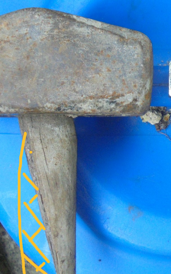

But I think you need to treat that poor thing to a new shaft!
Poor thing!
Poor thing!
New handles pretty reasonable and a job I find really satisfying!

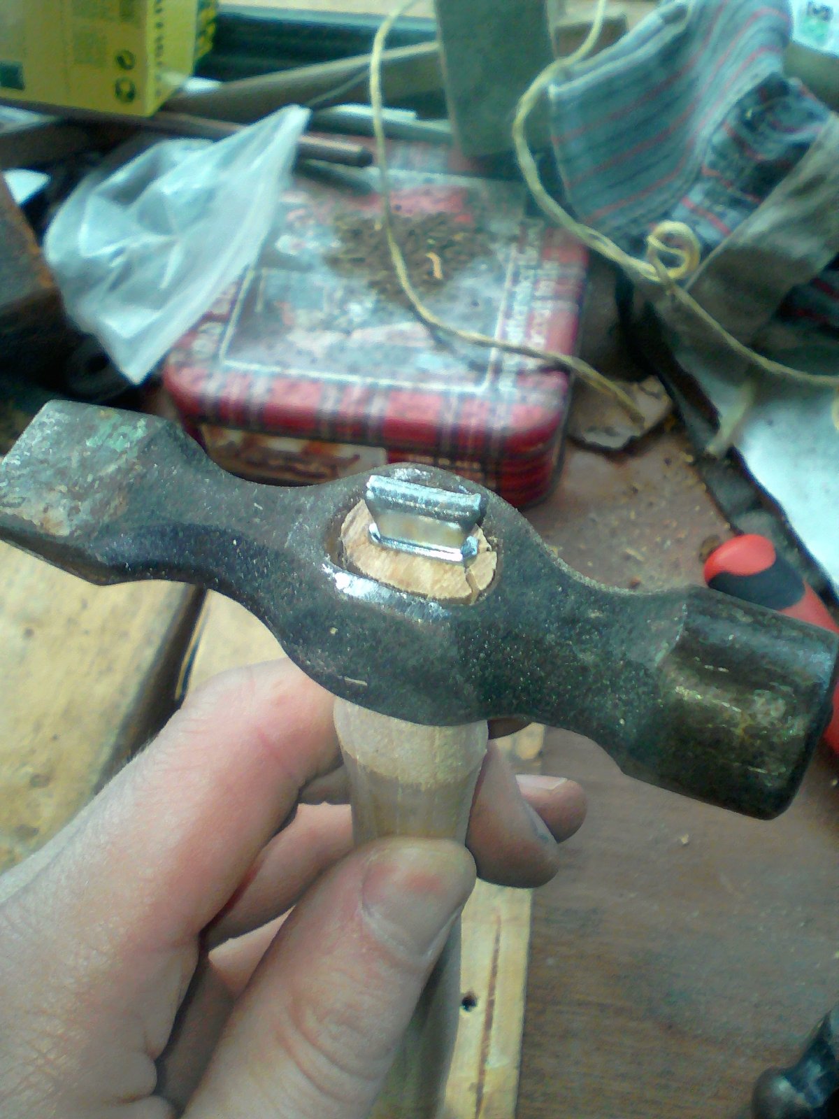

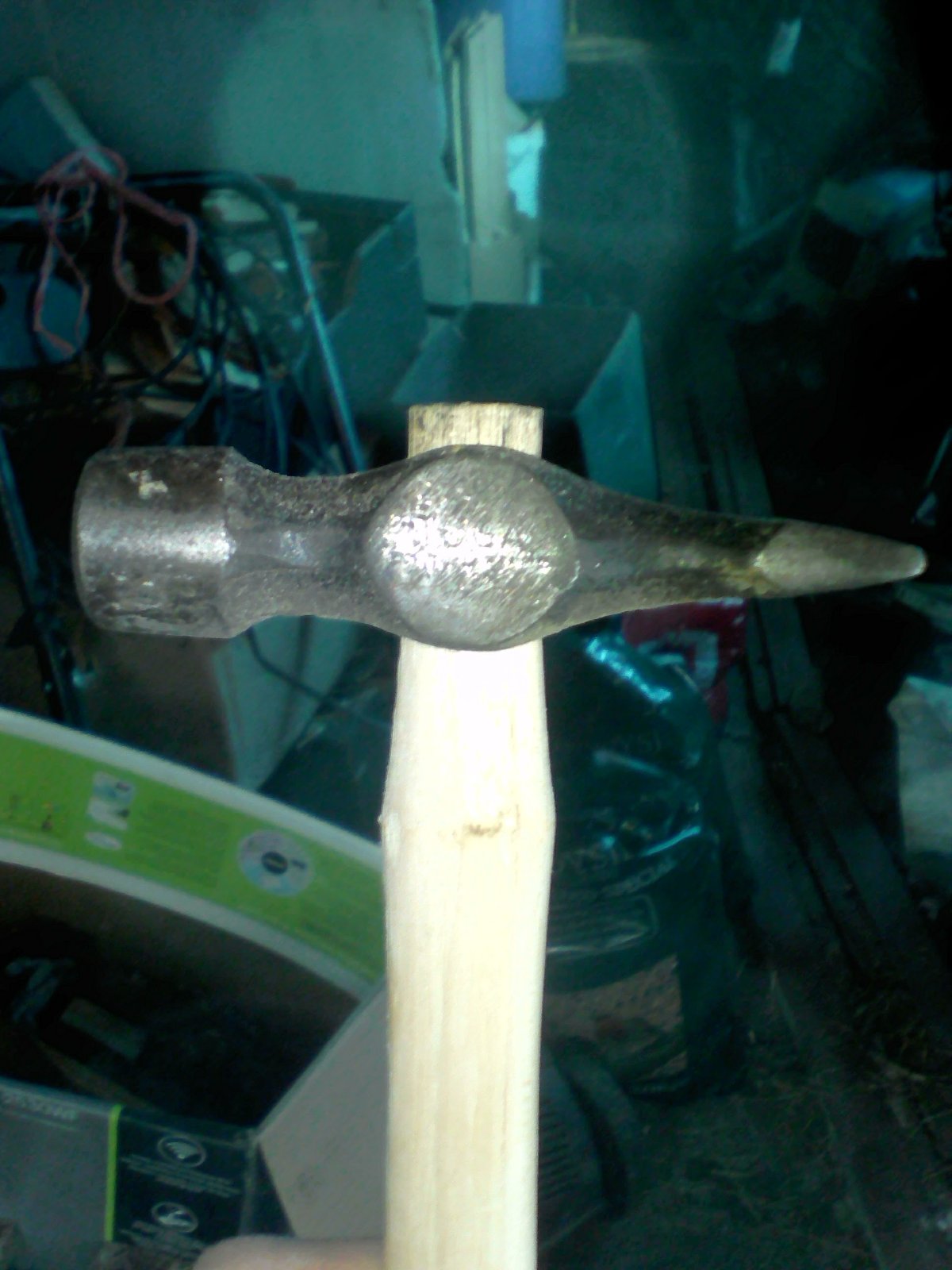

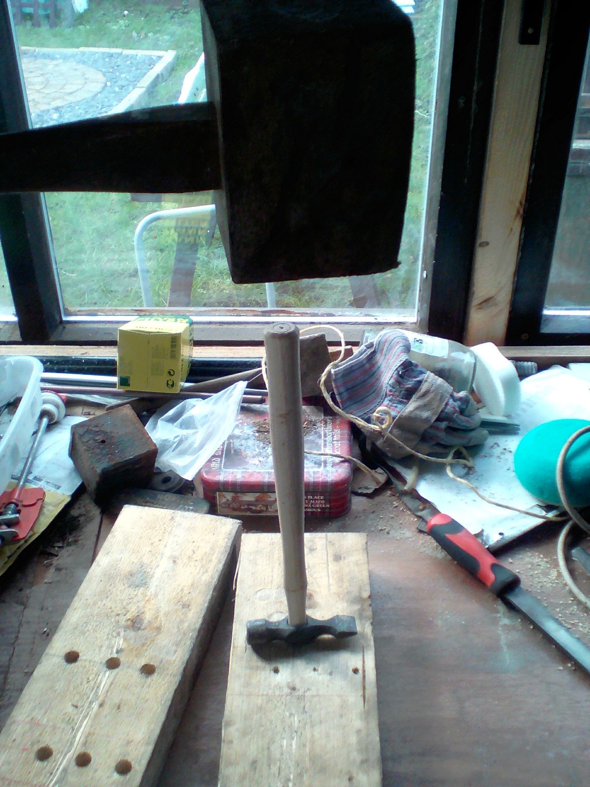

Hammer head meets hammer handle meets wallop from a wooden mallet
Thump
Thump
Fairly slim shaft, larger hole in head? = Overshot slightly.
Too far
Too far
Trim back with saw, then add a wedge to secure
Wedge (not yet driven flush)

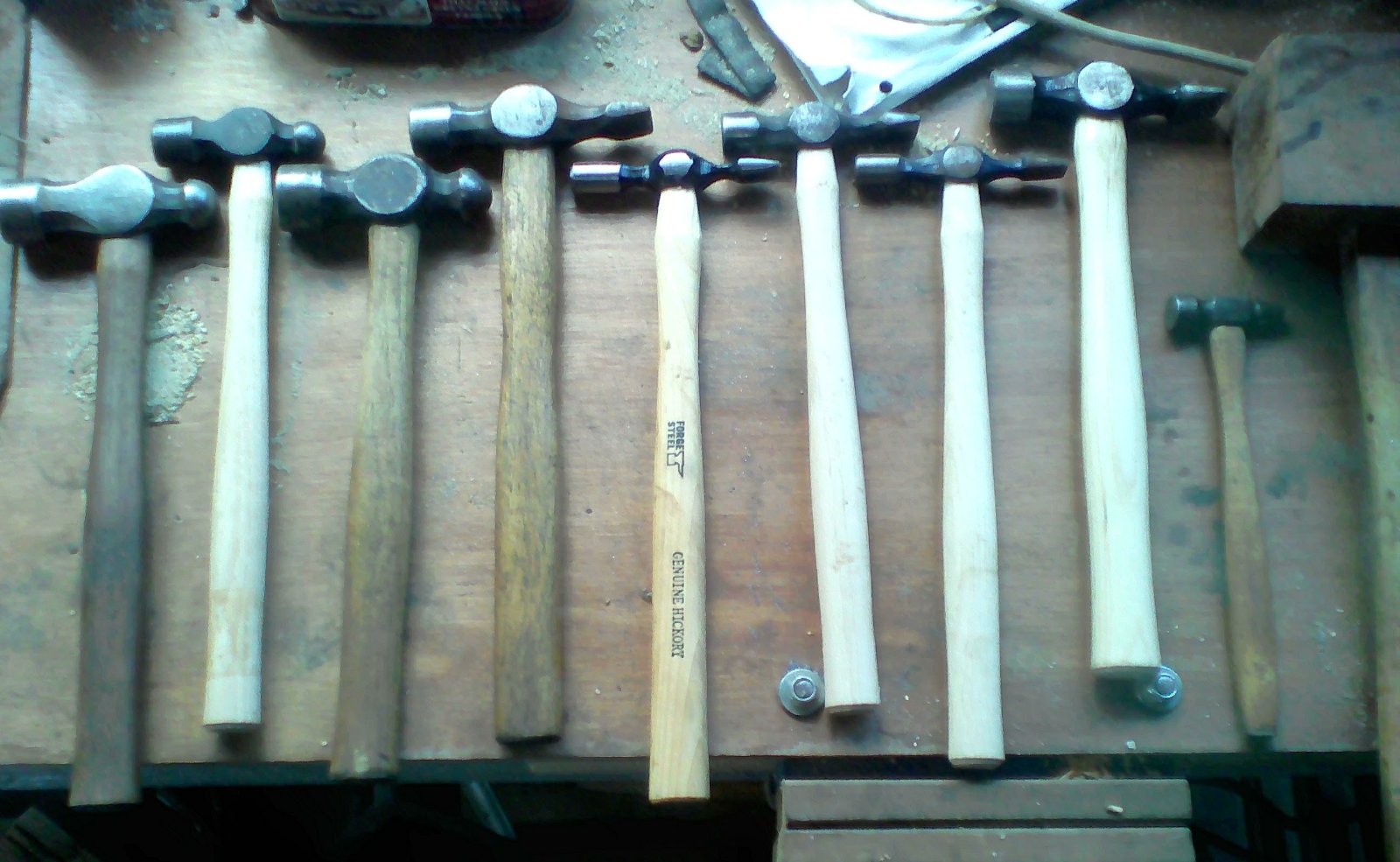

Finally add to pile of all the other perfectly serviceable hammers (these just from the small end of "the collection")
All the light coloured shafts were new
