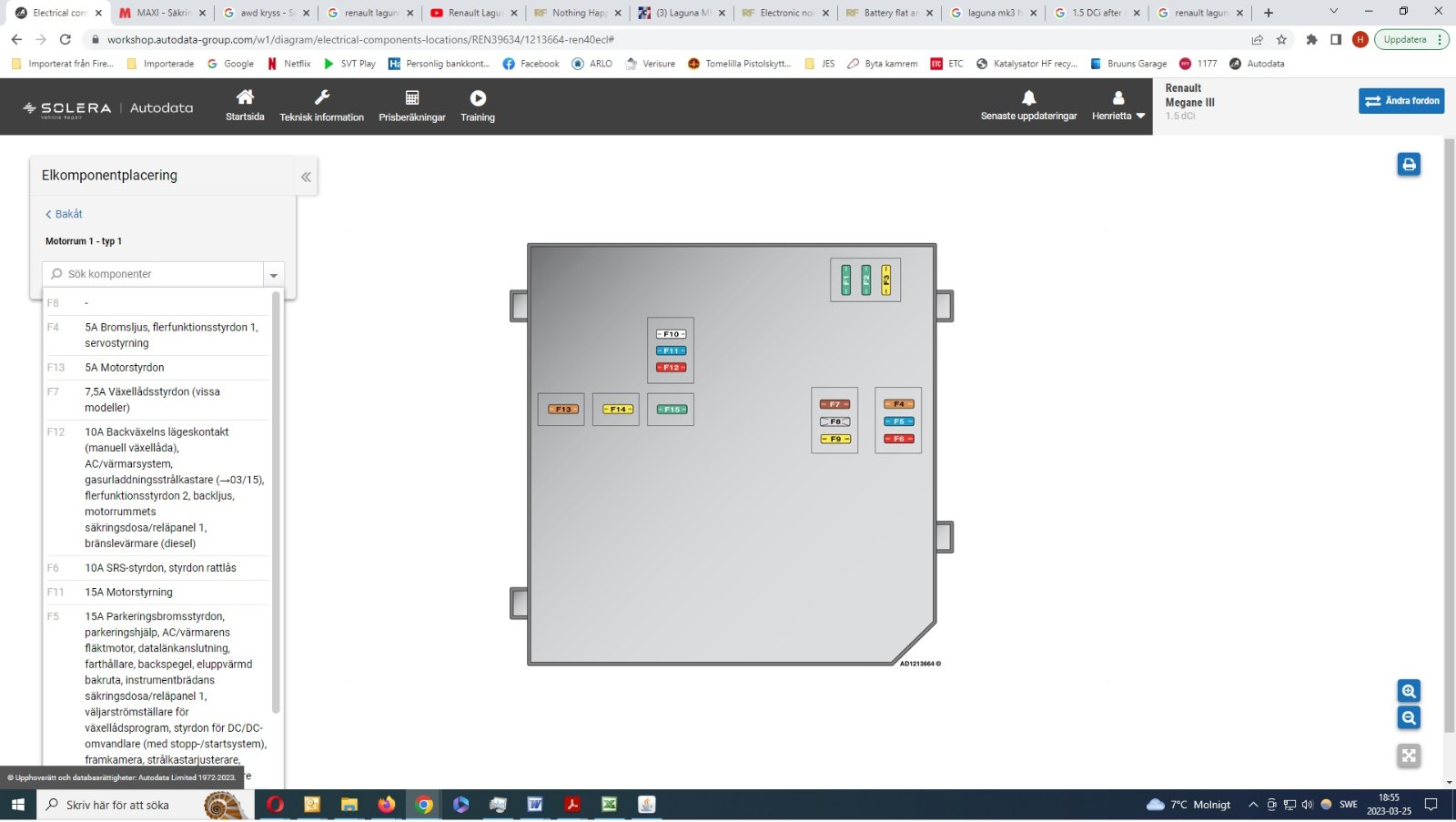

Where would I find the correct fuse diagrams for VIN number: VF1**************[VIN obfuscated, can be read by forum staff]
Something has happened when I changed starter motor - the wiring loom is sooooo short I suspect some wirings has broken inside the loom.
After starting the engine - I first got notice of alternator problem, then shortly parking brake problem and the engine shut off. After second start, it shut off after 15 second and after that - no ignition no nothing.
This is what happens under the engine bay fuse box and all the diagrams are wrong online also in my suscription Autodata:

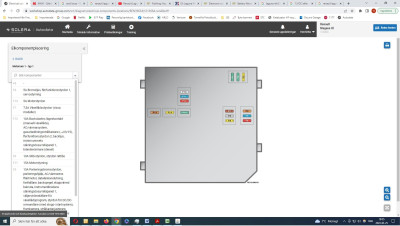

During the time - I also found correct fuse diagram for this engine bay fuse box.
This Laguna from 2012 has the fuse diagram for Megane 2015->
This one:
