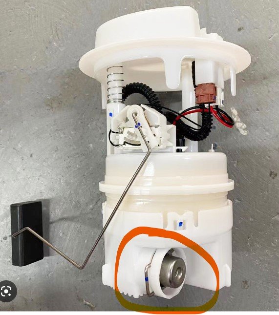

Some models the FPR is built into the pump/sender unit, if you cant see it on the fuel rail its likely it will be part of the pump/sender.
2 birds with 1 stone.

Something like this

Thank you wheeler that's very helpful, yes I can see on the new pump the FPR unit. I didnt think it would be there but that explains why I cant see it under the bonnet.
Looks like I will have to drop the fuel tank then to replace the pump, as you say 2 birds with one stone,
