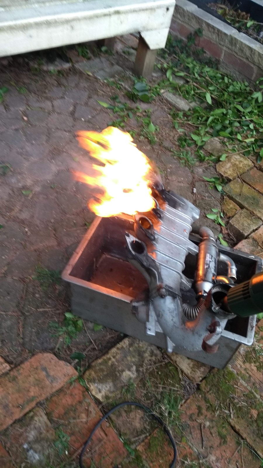

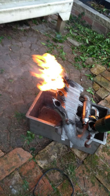

Rear wheel bearings? I guess these will have some impact on economy overall if starting wear... but other things to consider could be the air inlet manifolds clogging up / EGR too for example.
Elis had a look on his 2008 C5:
viewtopic.php?p=584453#p584453
and here
viewtopic.php?p=583334#p583334
and here

In theory, clogging inlet tracts should not have a bit detrimental effect on economy, more so on maximum power (which needs maximum airflow)
Obviously, taken to extremes, an inlet so very clogged as to give a huge power drop (and hence a car needing foot to the floor ALOT of the time) would then have a bearing on economy.
Likewise, I would not expect much economy drop from wheel bearings (as I'd they were to be absorbing a significant proportion of power from the engine, the only route to "shed" this absorbed power is heat dissipation - and the bearings are small, enclosed and not designed for shedding heat (unlike brake discs which it's their role in life
Cleaning inlet is a grim job, if it's an alloy inlet then I prescribe fire!
