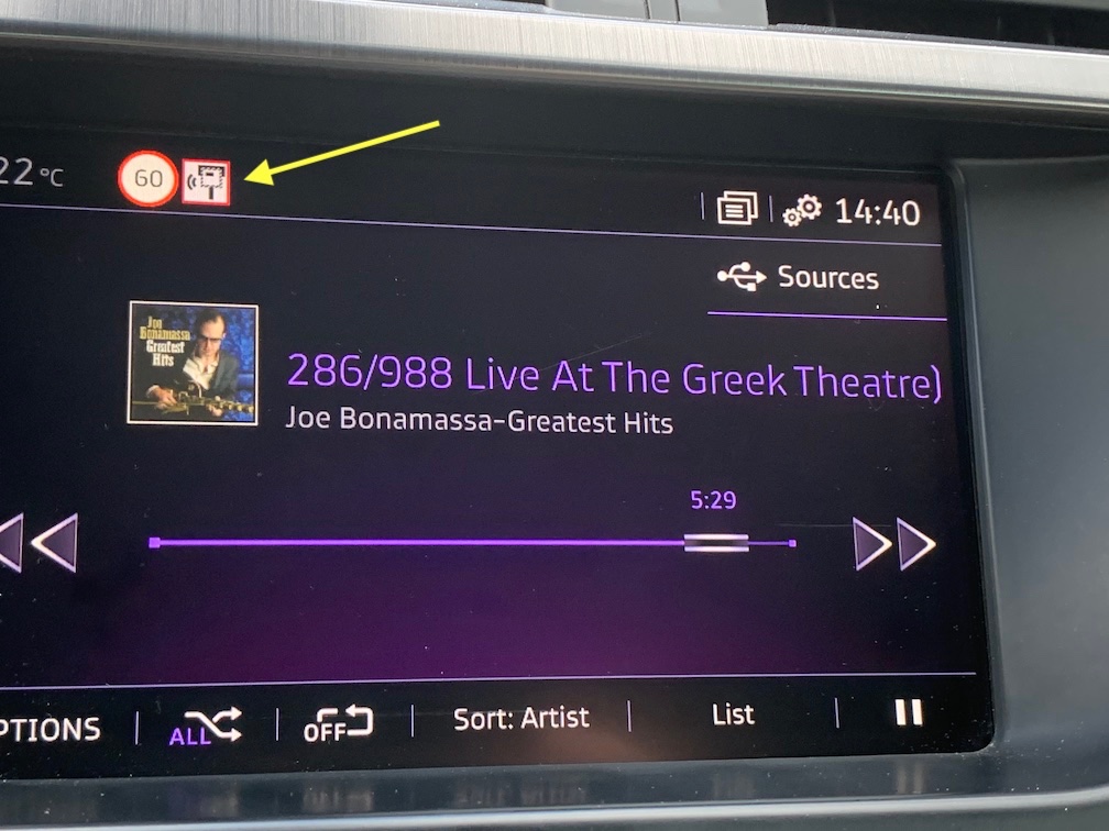

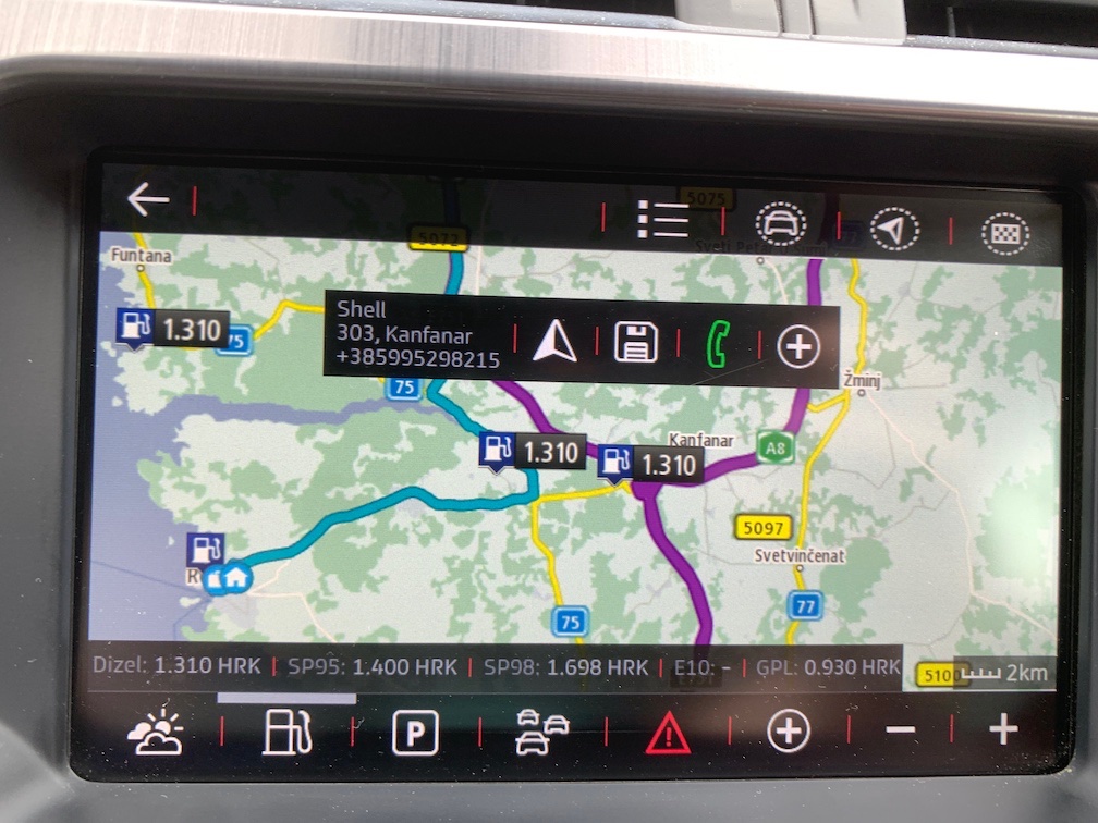

One small step for mankind, but one giant leap for me! 😀

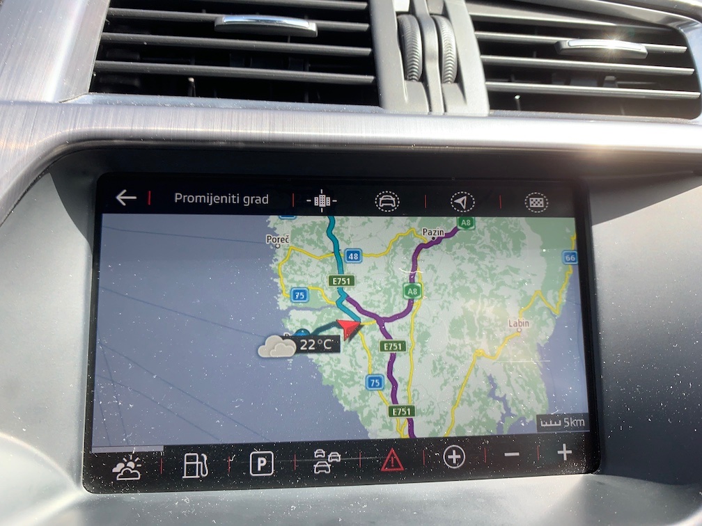

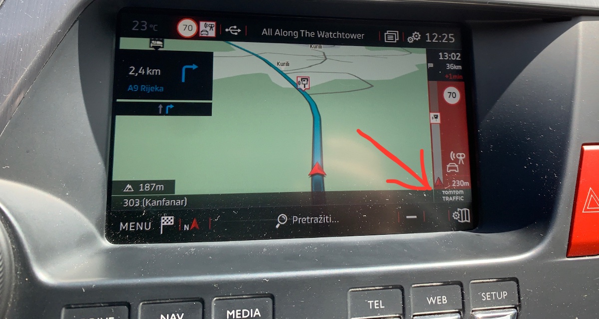

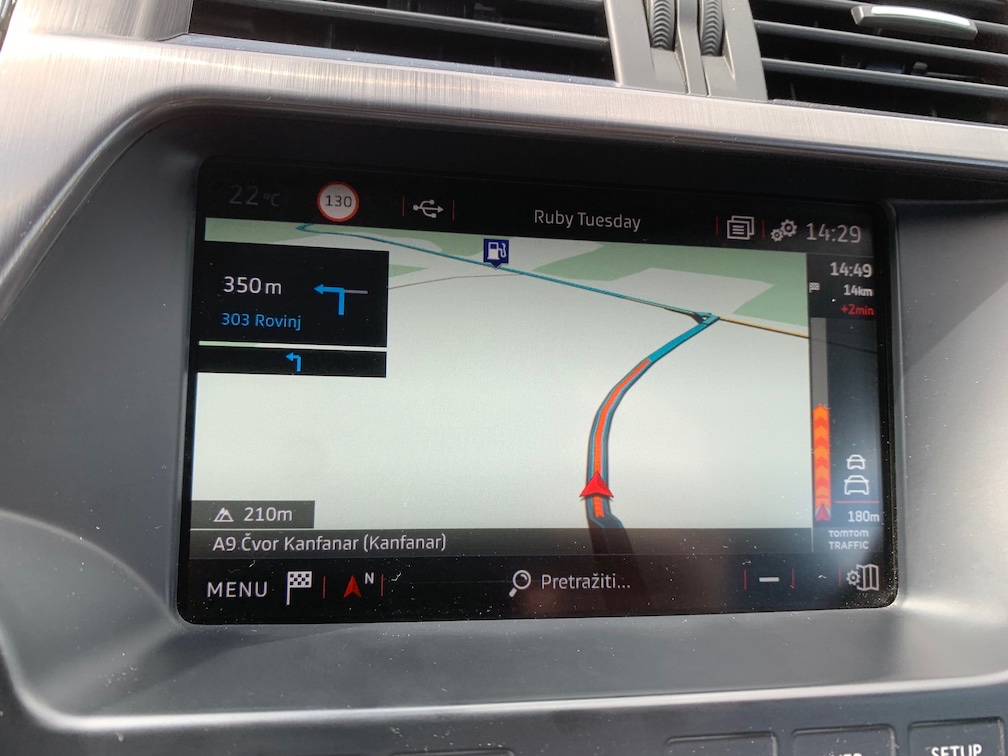

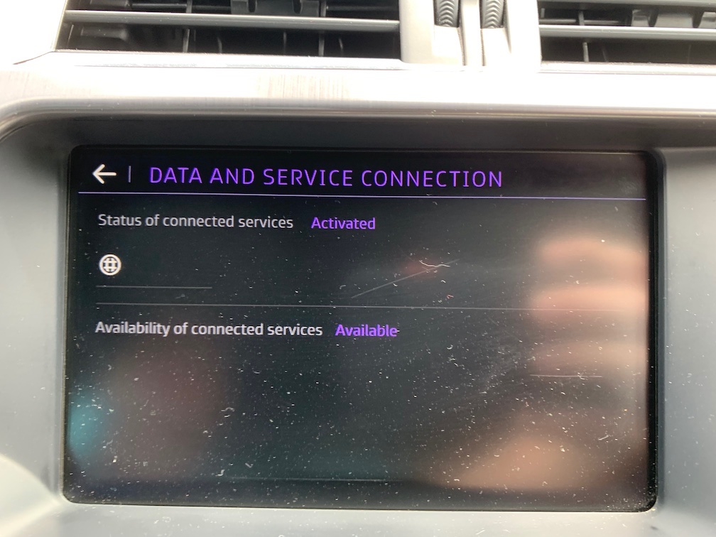

By some miracle, as of today my Connected Services work!
I know this may not sound like some news to you as most of the later DS5 owners in Europe use or at least have used TomTom's Connected Services (free of charge 3 years from purchase), but those were (and still are) unavailable in Croatia!
I was also told at dealership that they only work with 2020 onwards cars (with newer Nac Wave4 head units)...
However, the long awaited TomTom Traffic logo apeared today in the lower right corner of the touchscreen on my NAC W2!?
Previously I was lucky if I even got the (pretty usless) TMC logo there...
The thing is even stranger if knowing that Contract for 3 years of CS on my retrofitted W2 has expired almost 2 years ago and later trial one (for 10 days) has also been expired/cancelled this February!
Nevertheless, the Services are suddenly up and working now in a country that officially isn't elegible for them, on my NAC Wave2 head unit that supposedly isn't capable of it??
Happy days...
Of course I can only wish it stays like that and enjoy it while it lasts...

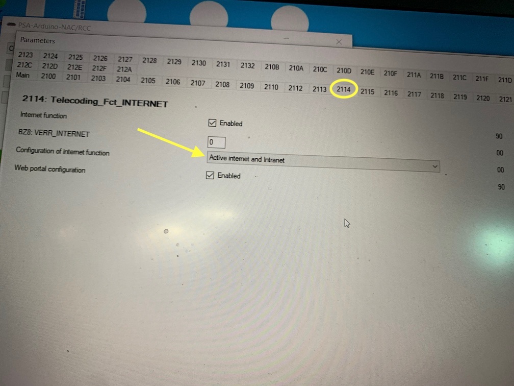

PS: I did some Arduino hacks the other day (in Telecoding_Fact_Internet section I set "Active internet and Intranet" - previously it was set to "Active internet and inactive Intranet"), but don't know if that's the reason? Wanted to enable On-board hot spot, but that didn't work, so I didn't bother anymore. And today I switched the screen to Nav mode and immediatelly saw the TomTom Traffic logo with speed cam warnings, as well as weather, gas prices and road works, it was all there??
🎵...It's a kind of magic...🎶

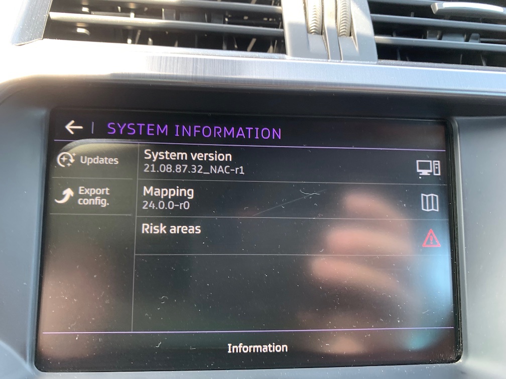

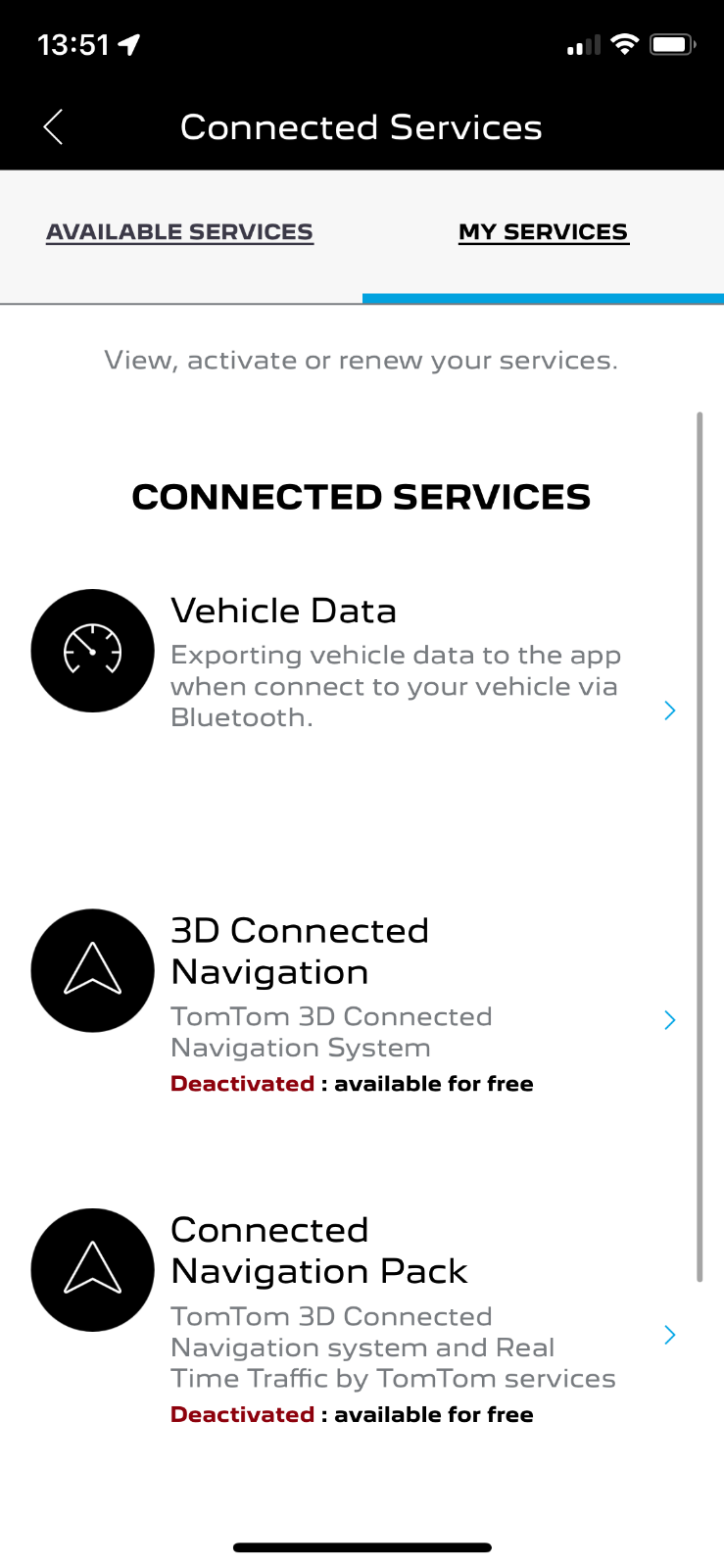

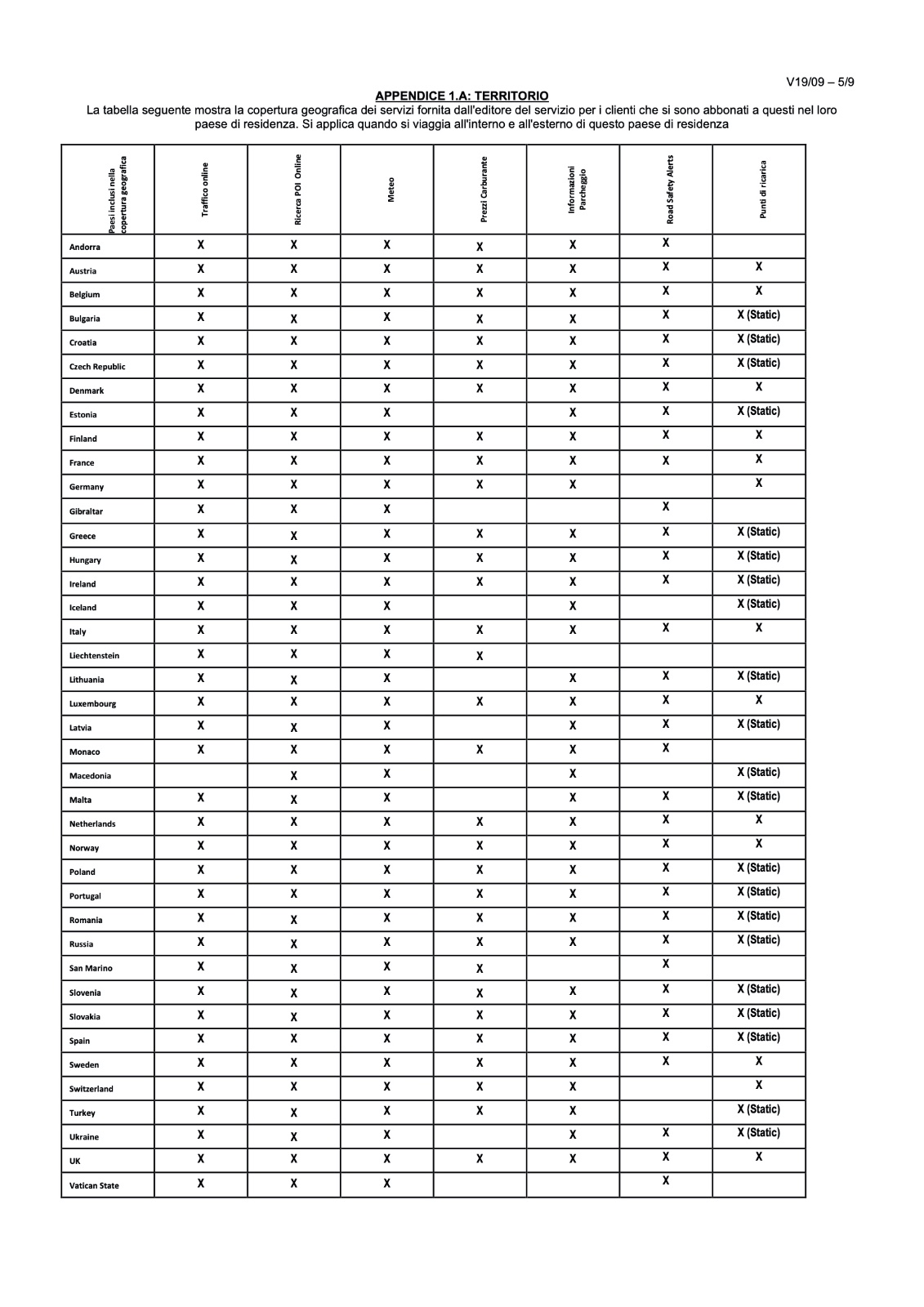

Found a new document on Italian Peugeot Services Store site (https://services-store.peugeot.it/sites ... _V02_7.pdf)! It dates from 05/2020, but was edited in 03/2021 (and probably at some point later, as well). In that document Croatia is listed too, although on domestic Citroen forum no one seems to be able to activate Connected Services?
However, TomTom Traffic Live is still active on my Wave2. And the app shows both contracts as "Deactivated: available for free"?
I certainly won't complain about that!

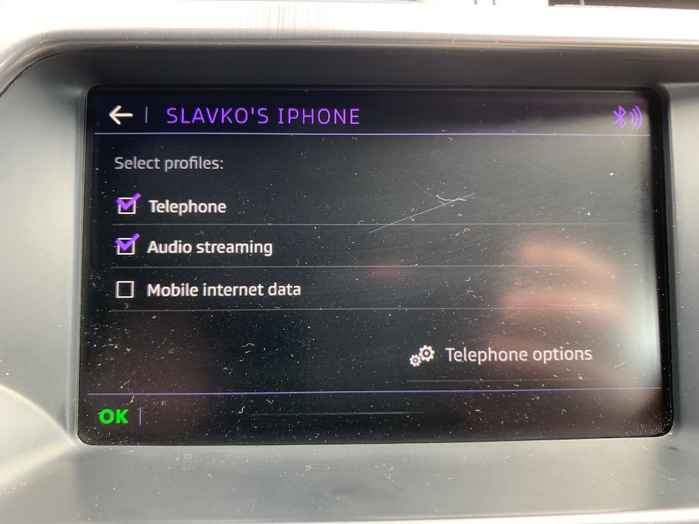

Maybe you just changed phone. My Samsung S23 Ultra does tether internet via BT but Pixel 7 Pro doesn't. So traffic working only with Samsung. I've just checked my services and life traffic is active to the end 2024 on my NAC unit. Happy days.

Oh, maybe I gforgot to mention; I retrofitted BTA2.0 box to my DS5 so it has built-in eSIM card, enabling the free and contuinues connection to TomTom Internet - hence no phone tethering needed.
Weired thing is that I had it done 9 months prior to Conencted Services suprisingly came to life (and for free)??
Still puzzled on that, but main thing is - it's working!!
