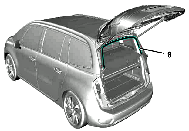

Great, that's what we needed. So this is what the fault code states:
So you have an earthing problem in the harness 'somewhere'.
My first suggestion is to check the area where the harness enters the tailgate. This is a common weak point that has constant pressure on the wiring, gradually weakening them as the tailgate is opened and closed. It's possible there is a break here.
I suggest you start here which is the earth to the Boot Manoeuvring unit:
MC63 is your earthing point - but the wire to it could be broken or partially broken anywhere before it.
