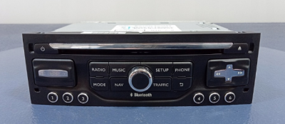

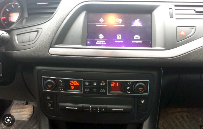

This is an RT6 unit:
A SMEG+ unit is touchscreen only control shown here and was only fitted to the last few C5s made before production ceased.
