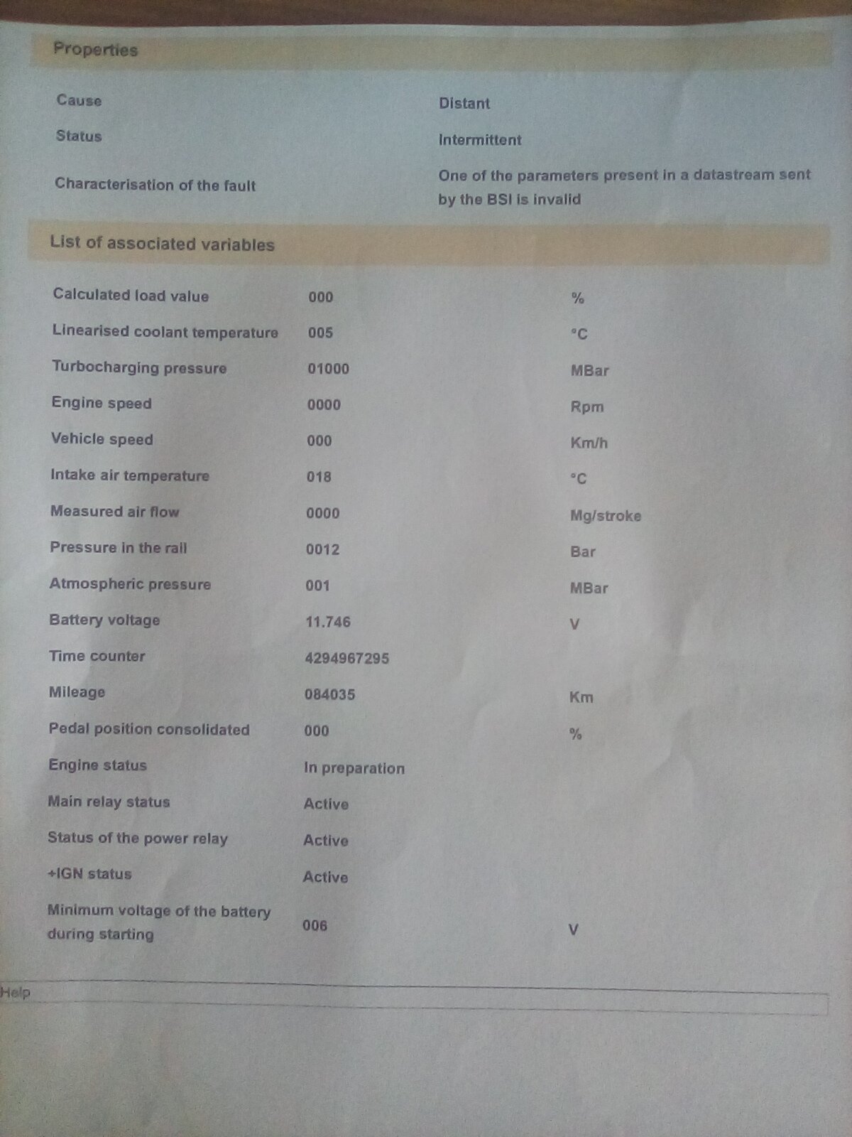

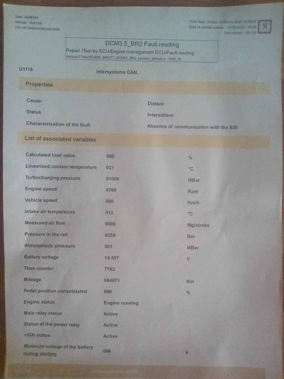

Boo you can see these two sheets, this is what Peugeot have me before saying they don't know and cleared fault, be ok now!.... Well it's not.
Did have an interesting conversation with a young chap in our supermarket car park he had an RCZ with an Android head unit in, I was trying to find out if he had his old unit but alas not, binned it. But he did say something rather interesting, when he was trying to repair his old NG4 his car out on an EML doesn't remember the code but it was a manufacturer code, to cut long story short his mate an ex pug tech, borrowed a diag tester and looked through with BSi or ECO setting as in there there is something like "is the NG4 recognised" this should be yes sometimes because the head unit is slower to come on line it switches to no his mate said he didn't know why. He knew this because they once had one from Clarion which did the same, he knew what to look for straight away he said it's the only line which directly lists NG4, once he switched it to yes EML didn't come back on which I thought was interesting as it is acting the same way not on for days then on it comes as soon as engine starts but no performance loss only problem he can't remember where to find this line of "code" for want of a better description, seems to think it was either BSi, or ECU settings. You'll know it when you see it as nowhere else is NG4 directly mentioned.
Diagnosis print from dealer
Diagbox print from dealer

Young lad with Launch Pro sorted it, seems when the Head Unit crashed he thinks it may of slightly damaged the Config file which is why the front parking sensor bars no longer show, the U1118 was a line in the BSi config file which read something like "presence of NG4" it was at No when it should of been YES, explains why radio seemed to me to be rather quiet and flat sounding, as he said something was not responding as it should so car does not know how to handle it so puts on a light, as soon as this was changed and updated radio works full force now, No EML on since Saturday morning so all going well, sadly the front parks will stay the same now as he can't copy the config file, well say can't no point as I will just reinstall what I already have, so he has taken car details and if he gets one to re-configure he will keep the config file for mine, but like he said, a 308 with this system in not many around now they have all gone android. Not bad for a window fitter, the Dealer could not sort it.
I must say when I was looking for a used NG4 they were all RCZ's not a single 308. The wife's happy now therefore I am.
The odd thing about this was the print that Givemeabreak sent above for U118 which was nice of him but none of the symptoms were present, and the cruise and speed limiter still worked even with EML on, car drove fine, no limp, no hesitation, starts 1st time, in-depth internet searches basically came up with the same symptoms as printed above so a lot of head scratching was being done, lucky this lad turned up as I was about to book it with my BMW tech for in-depth relay 4 to power pack wiring checks, which would of resulted in nothing just wasted money, and as my tech said to think your car could of failed an MOT for a radio issue, how mad is that! we think the no comms part was possibly the NG4 although it still worked but quiet and flat and the invalid data stream was possibly the amp, just guessing at these, but once BSi was told NH4 is there all was ok, drove to him with radio on volume setting 12 and it was comfortable, drove home with it on 3 that's how different it was and now basey and rich were as before quite flat and tinny sounding, and all down to a line in the BSi config which even the Dealer did not spot @ £120 diag fee.
