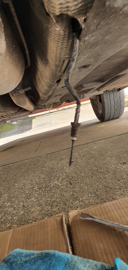

Before i disassemble a lot of stuff to find where is the connector for the Catalytic Converter Temp Sensor (2) connection , could someone who knows its location enlighten me? :mrgreen:
I know where is the sensor , but then the wire goes up, and i'm not sure what i should disassemble to reach its connection. I wanna test it as it seems to have wrong readings.
Have car on ramps, but wanted to avoid disassemble more than needed to reach the connector. :-D

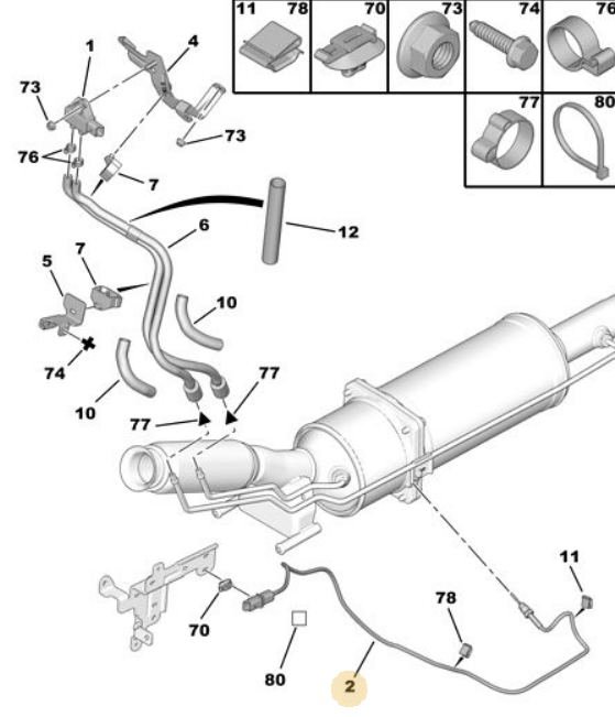

In this , it seems that it goes up? Is it in engine compartment?

If this is for your 2.2 then it's not the correct diagram, just so you're aware.
The gas temperature sensor (upstream of the catalytic converter) goes directly to the engine ECU.

Hum... But it seems pretty similar to what i have there. So it means that that 2 will connect to the ECU? Because i have something like that there...

Yes, the other end of the sensor goes to the engine ECU.

Here's the engine ECU for your specific C5.
1344 is the Upstream Exhaust Gas High Temperature Sensor. You can see that the 2 wires of the sensor (1389) on pin 1 & (ME480) on pin 2 go to the 48 pin Brown connector on the engine ECU on pins F3 and E3
