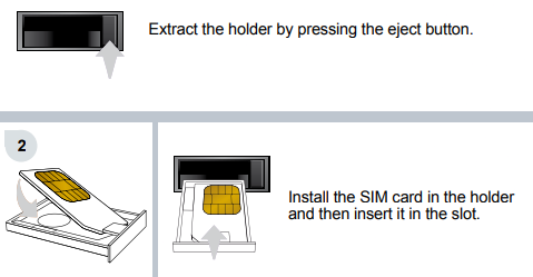

On a right hand drive it is fitted in the left die (passenger) glovebox, where there are audio and video input RCA connectors. You are looking for a small black bob like this:
I can't be sure where they have located it on a Left Hand Drive. In know the BSI and Fusebox is still there on the left side, but not sure whether they had room to include or whether they have also kept in in the passenger glovebox on the right side for LHD vehicles.
If you post your VIN (please post your VIN in full without spaces - it will be automatically masked from public view after submitting your post & will only be visible to staff), I can see if your vehicle has the RCA slots.

I,am the second owner, I bought my X7 one year ago with this NG4 navigation system ( same as the pic ) so , now , is there SIM card or not? By the way, on telephone menu I found ( internal phone) is activated and the SIM icon appears in the screen

So I can't help you as this vehicle has obviously had the NG4 above retro-fitted and was not standard.
Therefore there will be a loss of functionality for sure because a lot of these units also rely on a 'services module' for emergency calling and assistance. As you had the RD45 fitted at factory you don't have the SIM socket which is part of the Services Module, which is why you can't find it and won't be able to retro fit it. Sorry.
RD45 was a slight upgrade from the basic RD4 and allowed for integrated bluetooth. The NG4 was a premium system and to buy it new from Citroen today, it will cost over Β£3800.00 UK, so not a cheap option.
