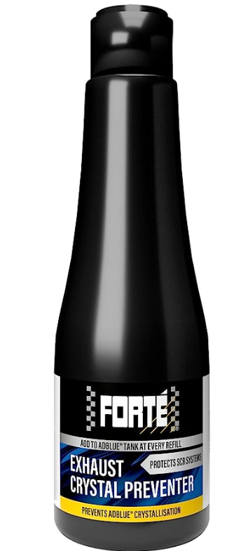

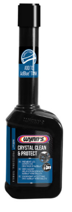

You need to dose the Adblue tank with some special anti Crystallisation additive to clean and help prevent this sort of problem.

Yeah I use the additive in my vehicle he sadly didn't. When purchasing adblue always purchase from indoor retailers Sun and frost is a big no no, check it is well in date as well
