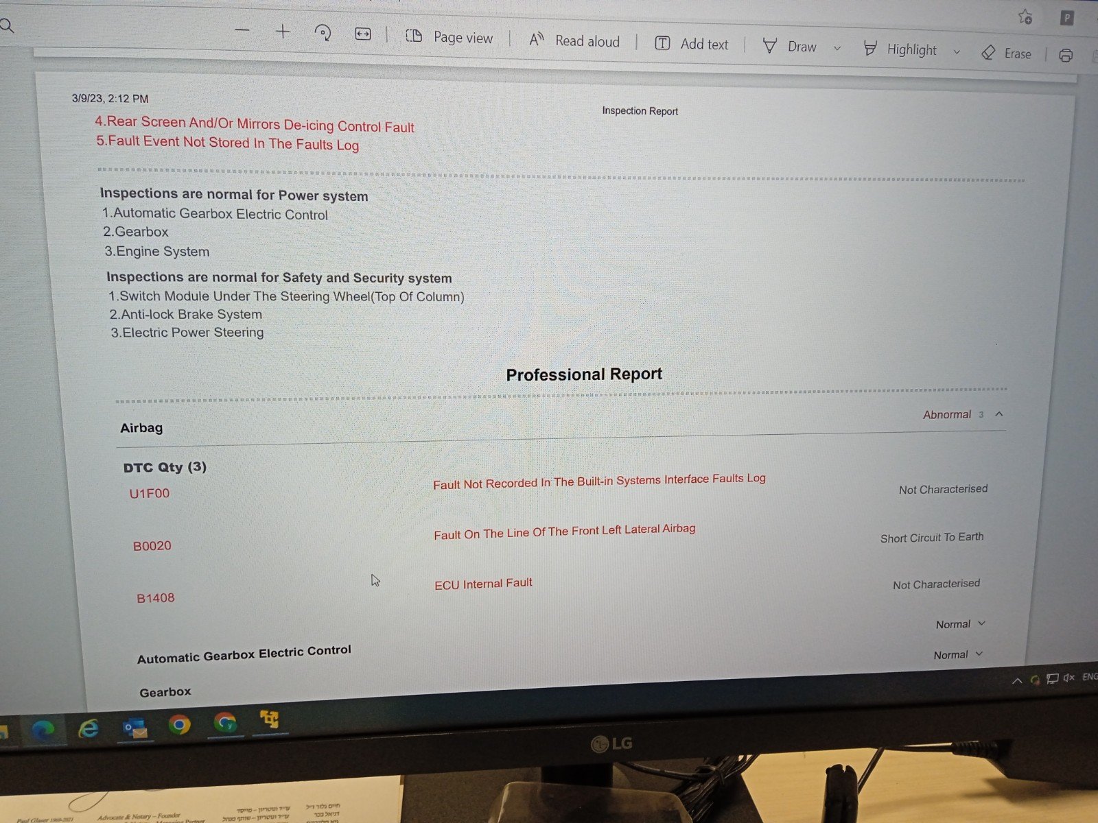

Hello,
Citroen C4 Picasso (5d, LHD) 2017, 1.6 Petrol, 165bhp
Got 2 fault codes which i can't figure out...i'd appreciate your advice (LAUNCH report, not DIAGBOX).

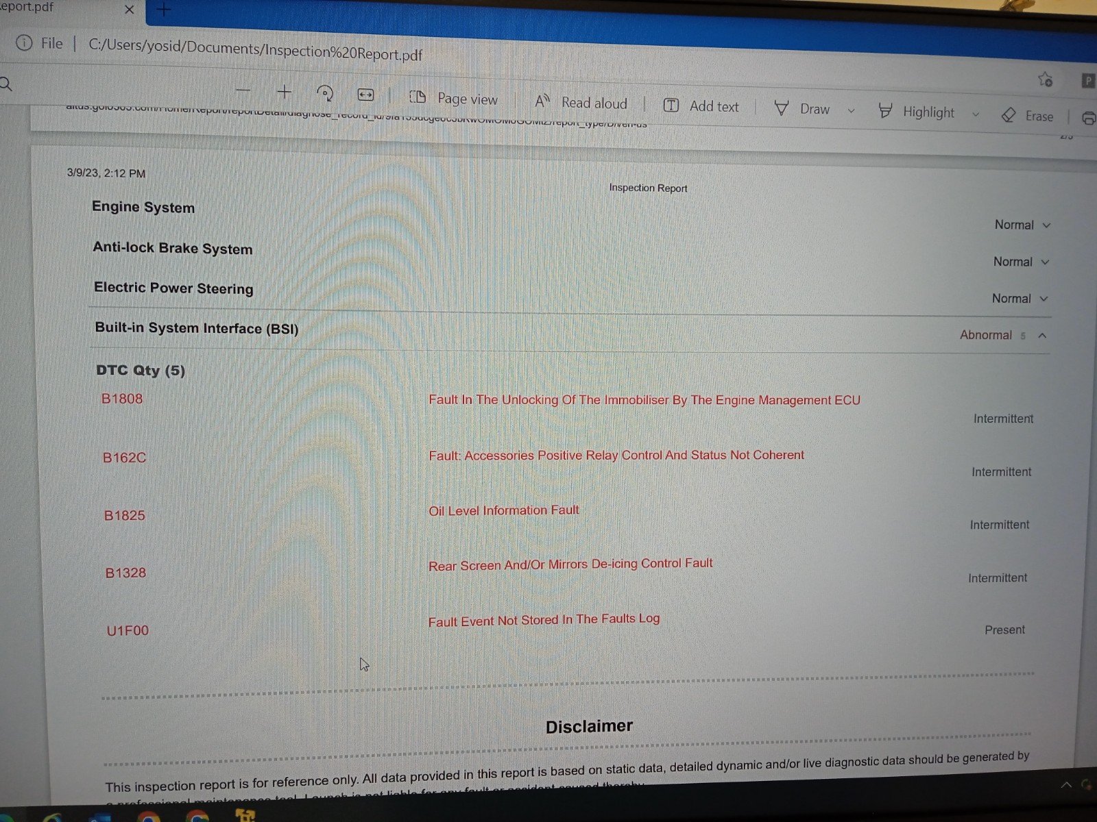

B0020 - fault on the line of the front left lateral airbag - short circuit to earth. This is the read. I should mention that while turning left (i think) the airbag light comes on and blinks (+ "blip" sound) a couple of times. I am guessing it has something to do with the airbag connector under the driver's seat but can't figure out what exactly is this "short circuit".
B1825 - oil level information fault. This is the read. There was no warning light or massage on the dash re oil level or anything in this regard and as far as i know a faulty oil gage sensor throws a different code.
got other faults as well but they don't bother me that much.
Thank you in advance.

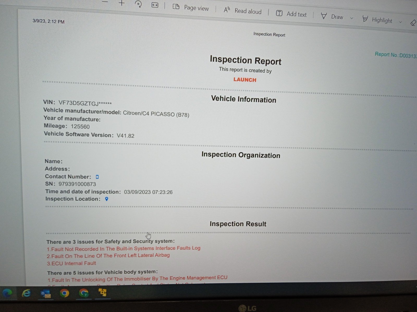

I'll need the VIN for this vehicle to see if I have anything to add. It is masked on the report.

Possible earth problem plug joints no good ?, thats just thinking old school.
